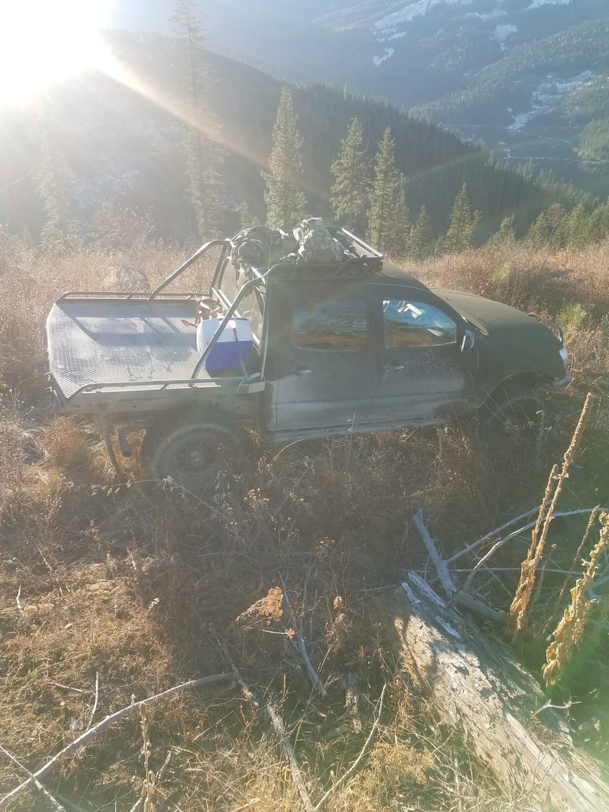

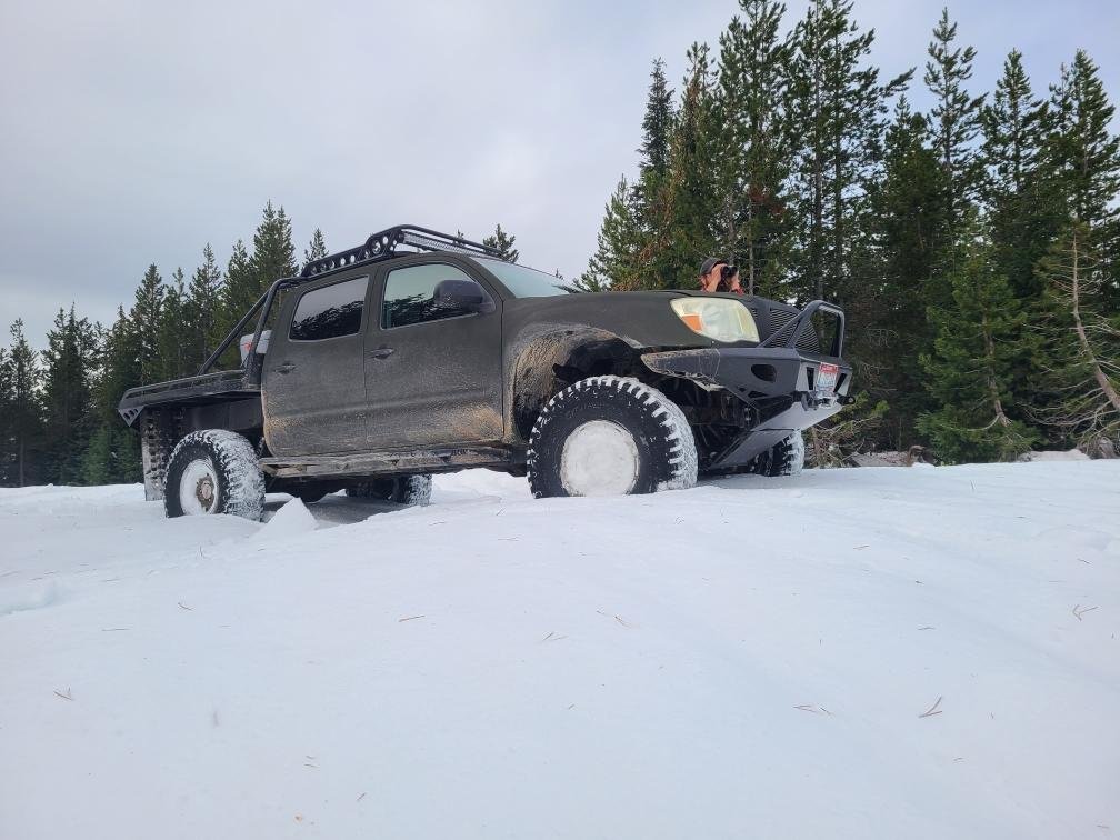

    I had mine Rhino lined from a shop. It's still my favorite thing about it. It's super tough and easy to clean. I've had it for 4 years now and have yet to hand wash it, just use a pressure washer and you're good to go. I've also drove down some extremely brushed in roads without any damage. Totally worth it for me.20201101_073926.jpg
