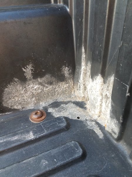

    Just got a 2008 4dr taco with some wear in the stock bed liner. I haven't repaired a bed liner before, and I really don't want to mess it up. Just wanted to get some pointers on how to properly repair it and make it look good as new20161102_083702.jpg 20161102_083707.jpg . Thanks!

    Ouch..... not too sure about the repair.
    But thats not a bedliner, thats the bed itself. its bolted to the frame. if in doubt, reach thru the wheel well and knock on the bed.....or crawl under the truck, look up and take a feelsy, its composite.
    I think i heard of someone using fiberglass repair techniques.

    I would repair that with fiberglass and epoxy resin (not polyester resin). You can gel coat the repair with black tinted dye to help match the original composite.
