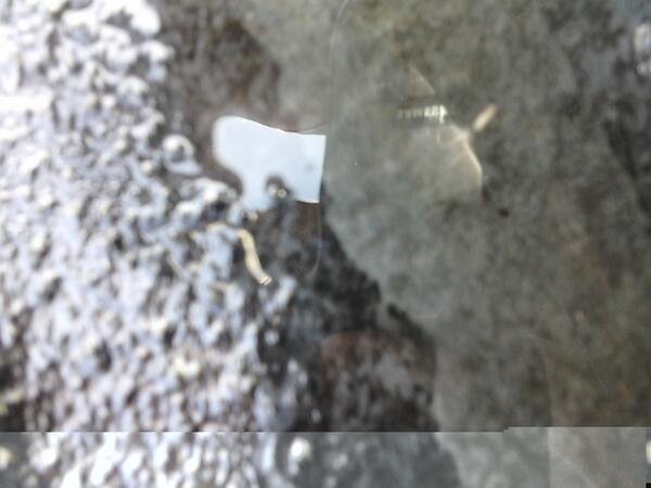

    so were i park my truck and water sits it already off. i will post pics tomorrow. pretty pissed. after every rain i wipe it up to.going to use the left over to do some more touch up and really but some on the bad spots. thinking bout spending money and getting line x lifetime warranty.

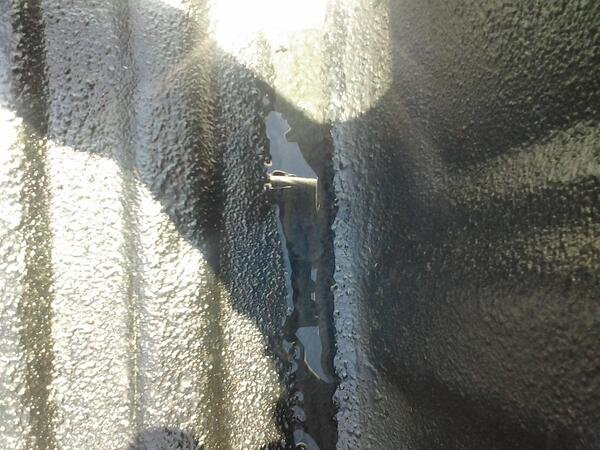

    looked this morning at where the place looks chipped where water sits. u cant even tell. i will post pics next time it rains here. wet and dry

    it so what chipped in the right rear corner. i will post a dry picture tomorrow. there is most the time more water sitting in the corner but this is from just washing my truck

    So what do you think caused it to chip/peel? The water sitting in that area? The rest of what I could see looks great btw.

    When applying Herculiner or any of the roll/paint in materials, it's EXTREMELY important to use a coarse abrasive on the bed's finish in order to give it tooth. Bed liner itself is thick material, so don't use anything finer than 80 grit...
