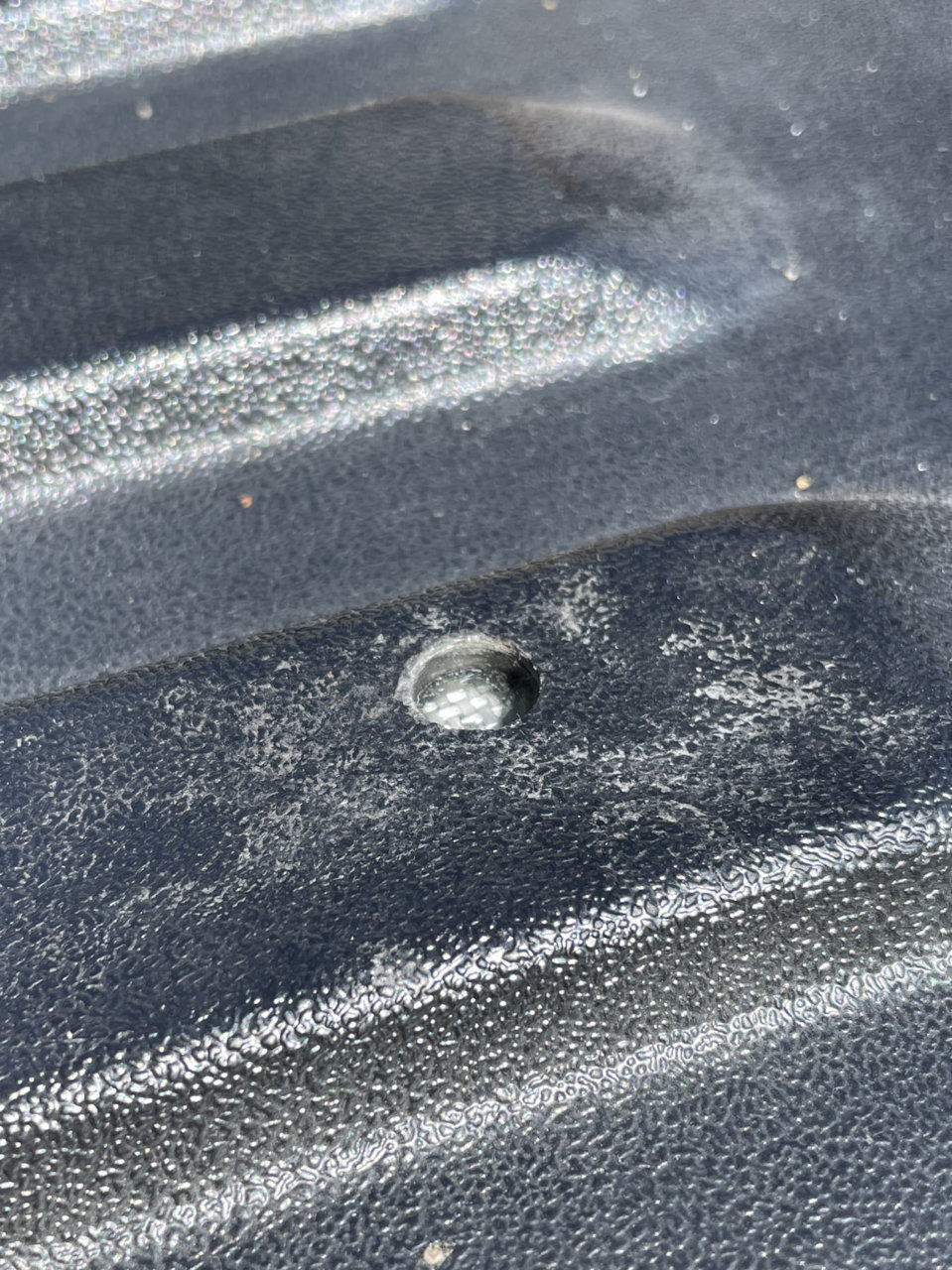

    My bed has a few holes drilled in it from the previous owner's camper install. It's in pretty good shape otherwise. I'm looking for some textured plastic material that's as close as possible to the bed material to cut some plugs out of and probably JB weld them into the holes. Anyone ever look for or find something like that?
    I'm aware of these textured black ABS sheets you can get from thermoforming, etc.. I assume the sheen and texture won't be a great match but a good place to start. I figured I'd ask here before I start ordering a bunch of samples. Also called around some local junkyards hoping to find a Toyota truck with some serious rear end damage, no luck. Thoughts?

    The holes are about 3/8". A couple of them are actually on the raised sections of the bed so they're not doing much as far as drainage goes. I appreciate the "it's a truck" attitude but it is also just like me to try the casting method you described just for project's sake.

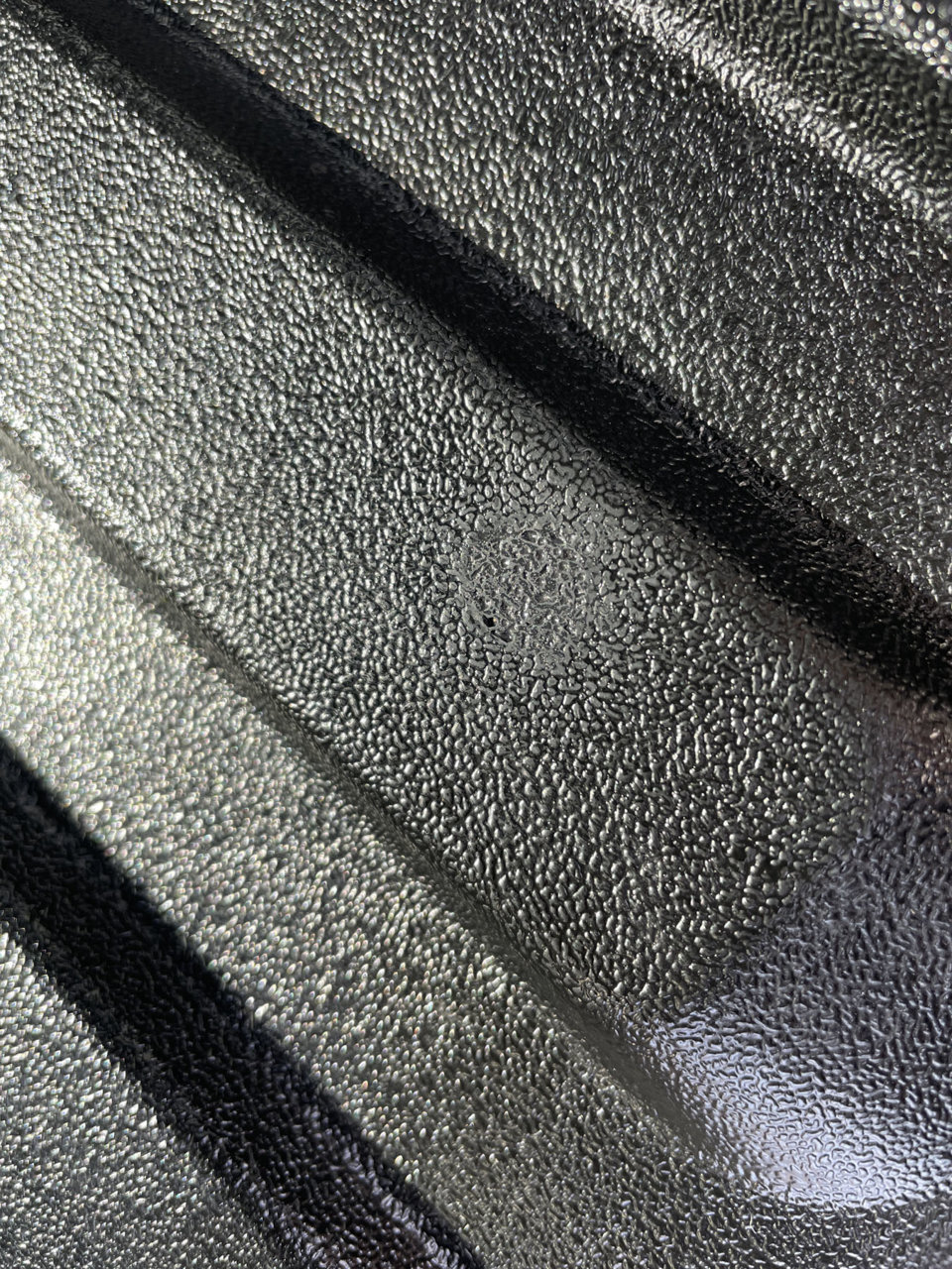

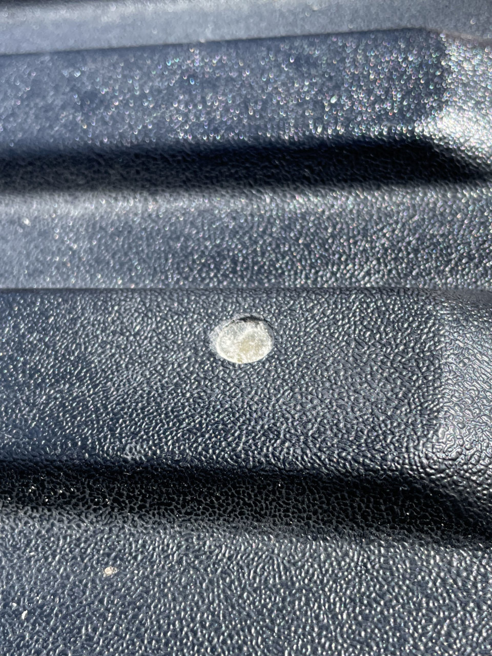

    Ended up doing a bit of a hybrid between the fiberglass and PC7 approaches suggested here. Patched the bottom of the holes with wetted fiberglass, filled most of the remaining hole depth with fiberglass resin and cut up fiberglass strands, then did a layer of JB weld mixed with some black oxide powder on top. I poked the JB weld a bunch with a toothpick while it set to get small raised peaks in the surface, and then came back after it had cured and sanded those peaks down flush with the surrounding bed surface, and polished them up with some micromesh. Whala. Didn't take too long and now I can slide things into and out of the bed all day long without running into any hole plugs or anything, or have to keep looking at those holes.
