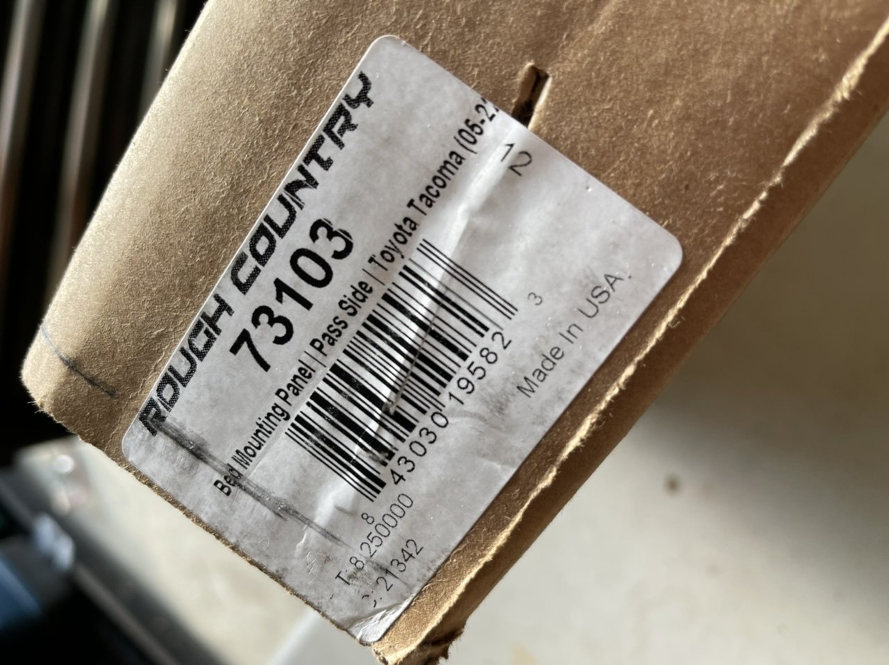

    I just got these for my truck too. For anyone looking at the RC panels, one thing that isn’t too clear in this picture is that the side panels do not go all the way to the front of the bed. Not an issue for me, but take a good look at the pics before you order so you don’t get a surprise.

    Did you get the full set or just one side of the bed? Looking for just a cabside panel bc I can only find the full combo set from rough country

    I got the full set.

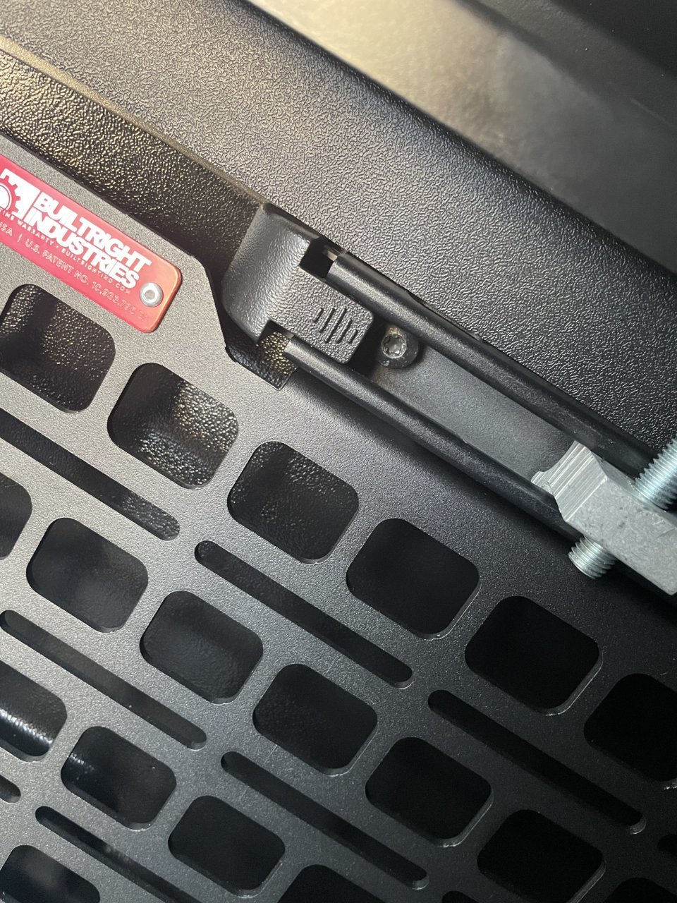

    Haven’t read anything but here’s my experiences. Had Cali raised first, tbh not much was available at the time and it worked with my fiberglass canopy with no other rail attachments used. Switched to a rsi canopy and added a oem divider so I took out the Cali panels because now the divider would be further limited on adjustments. Looked into behind the rail mounted panels and of the available options I could find there really was only 1 clear winner. Didn’t care for victory for 2 reasons- I don’t have a light pre cutout in my 18 so I didn’t want my panel to have one and I didn’t care for the logo in the panel. Didn’t care for rc because of the odd hex cutouts (didn’t match with the rsi door panels) and I didn’t like the logo in the panel.
    the last was builtright- “normal” cutouts, no bed light cutout and the logo is a small metal plate riveted to the panel and looks clean. That was my winner. Picture was mainly taken to show not to remove endcaps completely when accessing the rail bolts because you can’t just slide them back in. I had to finger it up through the cutouts and it was kind of a pain. I had about 1/4” clearance for the ends of the divider prior to the behind the rail panel and wasn’t sure if I’d have to cut the ends down a bit but it had just enough to still fit in place.
