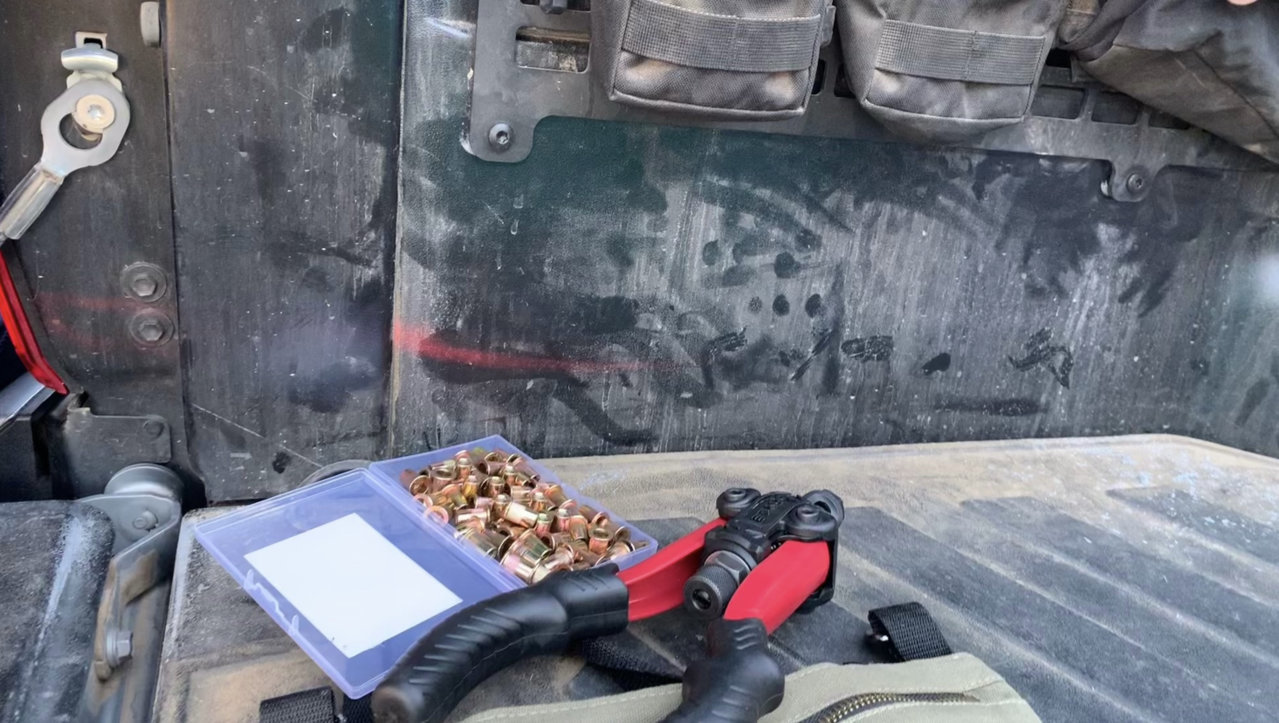

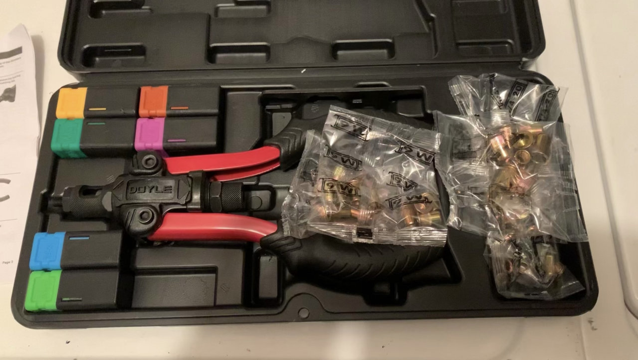

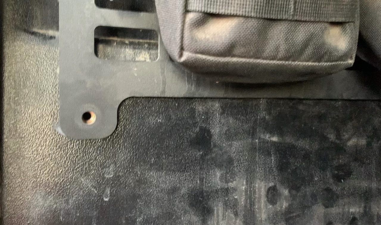

    I used M6 rivnuts & the same OEM torx bolts as found on the passenger side cubby. You don’t use any washers for a rivnut. The rivnut is compressed with the rivnut tool and becomes a permanent threaded attach point. Mark your holes, drill, install M6 rivnut, and you have an OEM looking attach point for your driver side MOLLE panel. I also added a rubber grommet on the bolt between the panel & the bed so there is no metal-to-composite contact. Super simple. Takes 15 mins. You just need a rivnut tool to do this. If you’re concerned down the road about leaving threaded holes, you can just leave two M6 torx bolts installed in them.

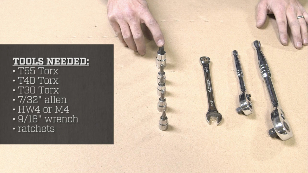

    Anyone know the bolt sizes for the @CaliRaisedLed bed molle panels? Specifically the big ones down the center that hold the panels together. I can't seem to find a hex head in my toolbox that fits it, perhaps it's torx? At least the little ones have a hex wrench that fits them. I already stripped two so will be replacing them with real bolts after I figure out how to get them off...

    Center is 7/32 allen key.

    <3 thank you for that image!

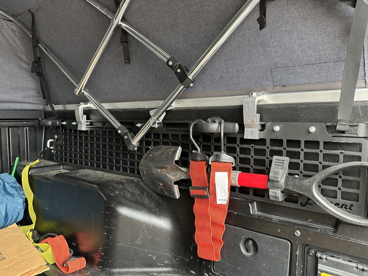

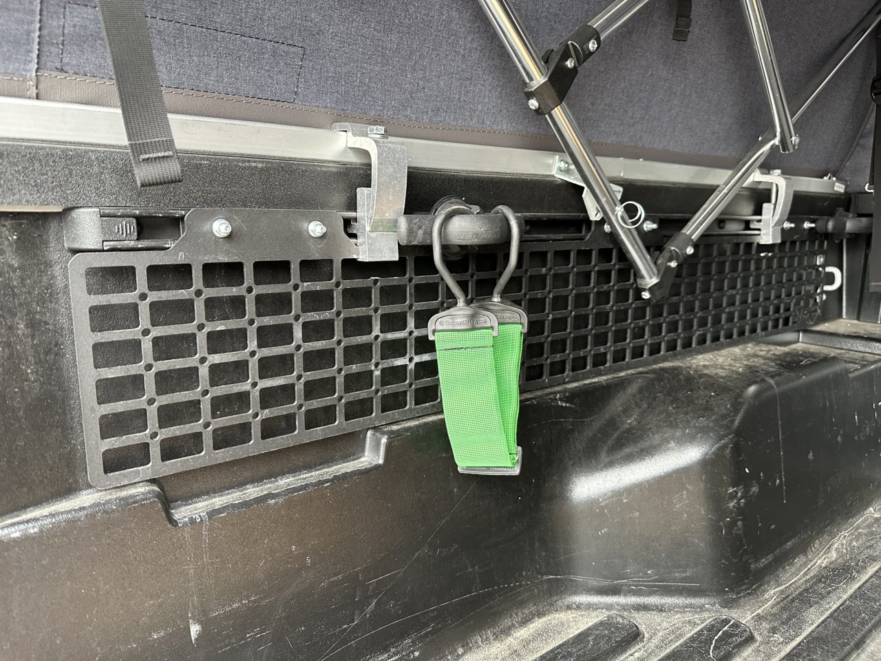

    Installed the RC (sorry correction: RA Motorsports) side molle panels last year in my short bed taco. Turned out well and fit perfectly underneath a softopper once you make the simple modification as described by Saturnine earlier in this thread.CC5DE6D2-BBC7-46E2-A26E-B16EB487EE8E.jpg9D1749BE-AEE0-4DFD-AE67-20636744F2C2.jpg
