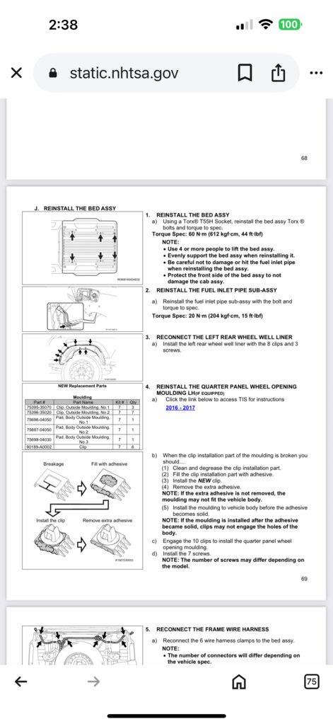

    So if I'm reading it right, according to the Toyota Tacoma Collision Repair Manual it appears that it's only 44 ft lbs :eek:? Can somebody else please take a look and confirm that?

    t0p_d0g, any chance you could send me a link to where you saw that? I was basing my post on the attached file that tonered posted in post #24. Thanks

    Yes 44 ft. lbs. I found it in the 3rd gen frame replacement guide.
    https://static.nhtsa.gov/odi/tsbs/2022/MC-10210361-9999.pdf
