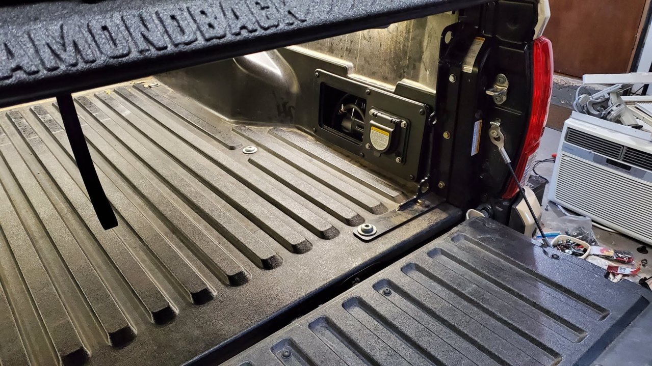

    Is the smittybilt hardwired to the battery?
  4. Apr 16, 2020 at 4:38 PM
    #104
    MountainManGuy
    MountainManGuy Well-Known Member
    Jul 26, 2019
    #300316
    808
    Colorado
    2019 Toyota Tacoma TRD Off-Road DCSB
    Yep, I ran 8 gauge up to my auxiliary battery in the engine bay. If I had to do it over again I'd probably go with 6 or 4 gauge just to be safe.
    Also, that 8 gauge wire goes to a relay and then to the aux battery. There's a switch in the cab for turning it on and off.
  5. Apr 16, 2020 at 4:53 PM
    #105
    Taconator_
    Taconator_ IG: ohv_tacotruck
    Jun 16, 2017
    #221655
    1,974
    Eric
    SoCal
    18' DCSB TRD OR 4x4
    Woah, dude! I didn’t think you could hardwire these.
    Did you cut off the power cable and solder on 8 gauge?
  6. Apr 16, 2020 at 6:40 PM
    #106
    MountainManGuy
    Jul 26, 2019
    #300316
    808
    Colorado
    Yep! I just cut off the alligator clamps and crimped the 8 gauge straight to the compressor wire. Definitely still want to throw a fuse in between there somewhere though. It's been workin great so far
