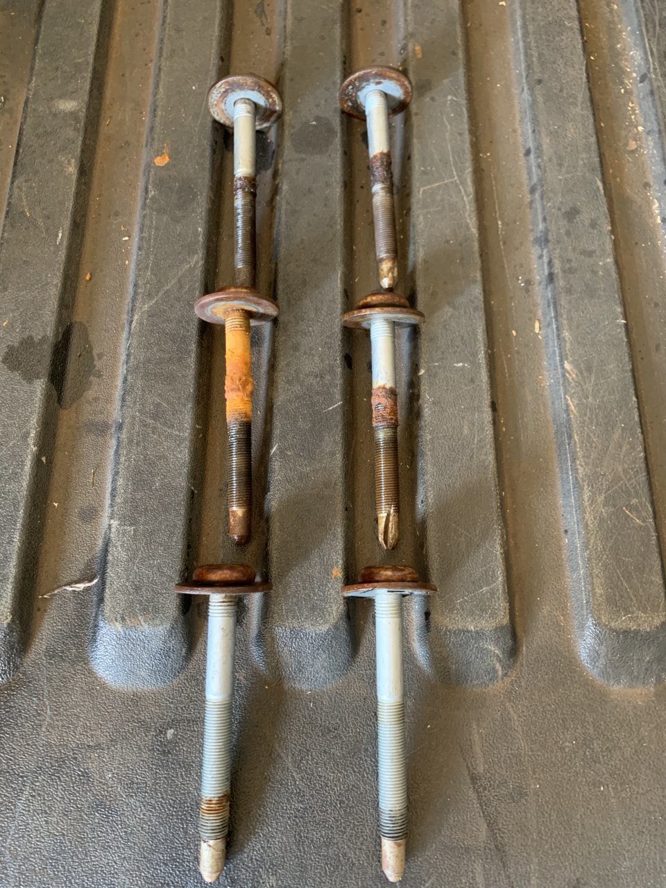

    Thanks for the heads up. I got a few out when I installed a bed reinforcement. Luckily I had no hickups. But really would like some tie downs in the middle and front of the bed.
    I ended up rustoleuming the ones I got out and added anti-seize to the threads. Still holding up good.

    Oh man you got it! My worst one was the driver’s side middle for some reason. The ones closest to the cab are awkward because of the limited range of motion(didn’t use an impact). The bed reinforcements only require removal of the two by the tailgates, yes? Those are usually a little easier since they don’t see as much corrosion. I nearly punched one of my taillights when I broke it loose lol

    Yeah just the tail gate bolts and you gotta drill a few holes on the side which I sanded clean and hit with rustoleum since they are behind the tail lights. Don't wanna leaved exposed metal in Michigan.
    Looks like I better get under the old girl and hit those bolts with some PB. Should do it even if I wasn't doing this job really.

    I think I sprayed the bolts daily for a week straight. I forget if the ones near the tailgate have “wells” but the other four sure do. That’s why it looks funky just above the threads. Water, mud, dirt and sand just accumulates between the bolt heads and threads. Just take a rag or paper towel to scoop out the best you can before putting the bolts back in. I cleaned the threads inside the best I could as well

    Nope. You just grind or file down the ridges on the bolt so you can slide the Washer off. Then slide the D ring on, slide the washer on, and bolt them in.

    All you do is slip the Sprinter D ring on the bolt, slip the washer on the bolt, drop it in the bed and tighten it down. You don't need to grind on the washer. The only grinding necessary is the ridges on the bolt so you can get the washer off.
    Some people use the caveman approach and just pound the bolt through the washer, but grinding down the ridges is so easy even a neanderthal can do it.
