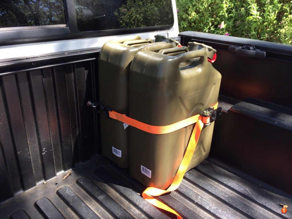

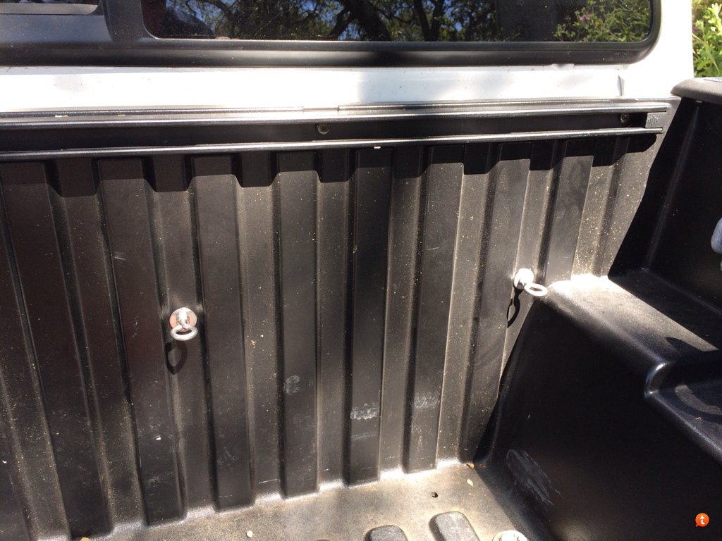

    Here's what I did. Works good and is simple and cheap. Only drawback is that the eye bolts protrude into the bed a little when not in use. If it becomes a problem I might swap in some small d rings.

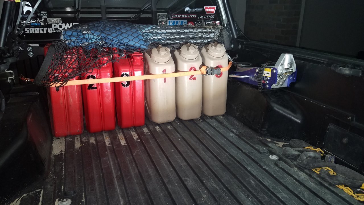

    Basically like this... but with a 2x6 instead of a ratchet strap and traction boards

    I taped the nut onto a yard stick and used that to hold it while I got it threaded. Then just pulled it off the yard stick. I used one of those nuts that hinge in the middle. The kind you can push through a hole and they pop out. That made it easy to hold in place while I tightened from the other side.

    Nothing wrong with a simple ratchet strap

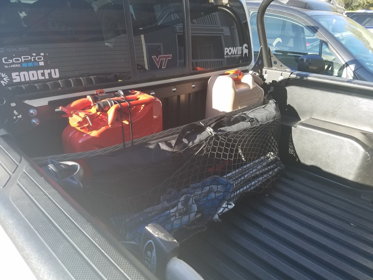

    I popped the bolts out around the storage areas and put little d-rings, and I use a couple of bungies to secure the top and bottom. It's held up surprising well in rough conditions. Doesn't hurt that I generally pack the bed pretty tightly.
    Not a great picture, but it's the only one I can find on my phone:
    IMG_3170.jpg [​IMG]
