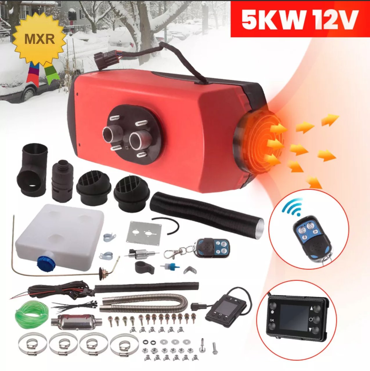

    Here's the heater, in case you're interested Capture+_2020-11-29-18-41-45.jpg

    5KW at 12V?? That would be 416.7 Amps if it’s electric heater, sketchy! Even a 5KW hear pump doesn’t make sense for a vehicle and 12V.

    True! I wonder if it would be better to use a low amperage 110V since it’s already wired for that.

    Its a diesel heater, the 12v is just for the fan and glow plug.

    Looks like it burns fuel of some sort. I’m guessing the 12v is just to ignite it. Also guessing 5kW is just the same as 17k BTUs?

    It's supposedly 5kw of heat or about 17,000btu which is almost the same as the bigger Mr. Buddy heater on max. It's actually a pretty minimal draw once it gets going. The glow plug pulls around 10amps @ 12v for a few minutes to get a flame going. Then its just the fan and the fuel pump running until you shut it off and the glow plug comes back on to burn off any leftover fuel.
