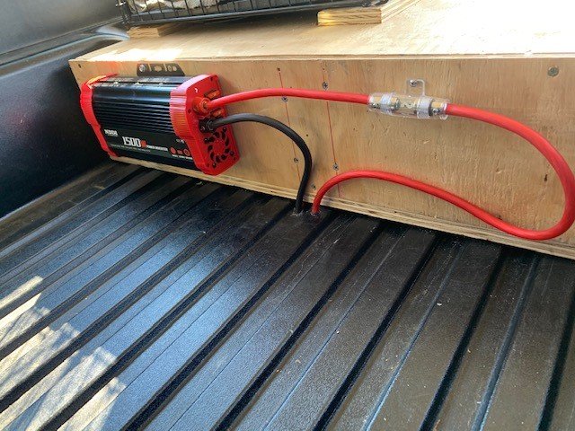

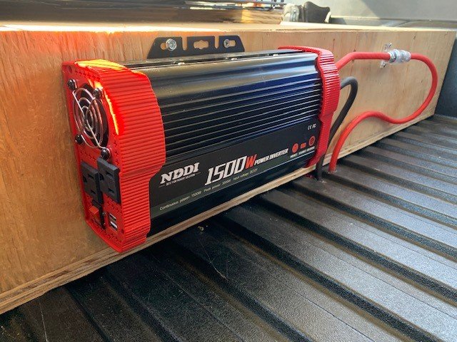

    I've had the same experiences as described in previous posts. There isn't enough power and the system dumps down from 400W to 100W when placed in drive. I had hoped to use it for a small heater to keep a working K9 from freezing temperatures. A small, 250W heater will raise the temperature in the bed (with a cap installed) about 4-5 degrees.
    I installed the inverter below to the rear of the K9 pull out drawers. It's accessed through the passenger side awning window on the bed cap. It worked well this morning for my two hour drive to work.
