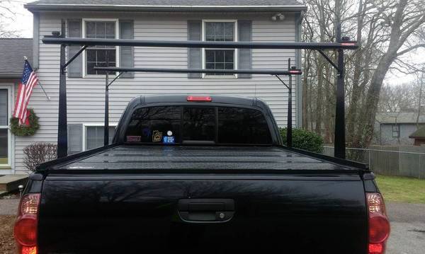

    As TAOScott said above, the Prorac has the rack/tonneau combo. I just installed the rack yesterday -
    This is a picture of the rails used (bolts into tie-down rails) for both the rack and the cover. The benefit of this rack set-up is that the verticals are outside of the bed - allowing the full unobstructed cover.
    The rack is sold separately from the cover and comes with the rails - so if you could modify the Access cover to bolt into these rails (not familiar with Access installation) then maybe this setup could work for you.
