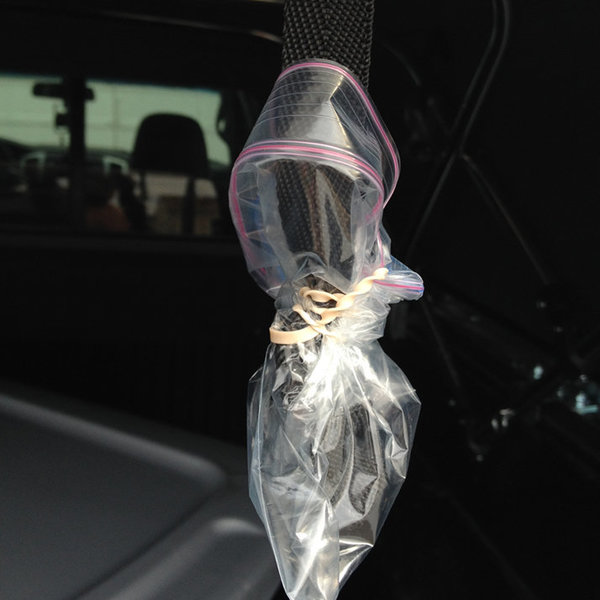

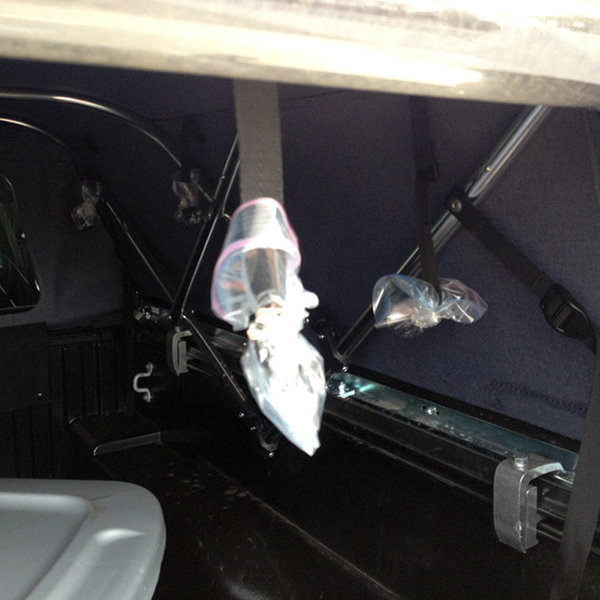

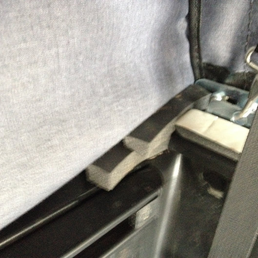

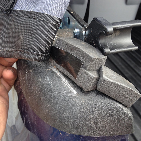

    I decided on the softtopper for the bed cover, and just some plastic bins in the back to help keep things dry. The soft topper is greta but it's not water tight. around the corners of the bed is not a tight seal and I ended up putting weather stripping down on the inside to keep the water out while driving. Not sure how well it went as we put the topper on and went on our vacation to Sedona. Also the seam sealer, use it As Soon as you put the topper on and use it on the straps that hang down on the inside by sooaking the outside parts of it and letting it wick up and into the inner compartment. I didn't, and they acted like wicks and started dripping water inside the bed when we were getting ready to go on vacation. So I had to wrap the ends in a plastic baggy to catch the water and keep the bed dry.
    The weather stripping helped but water still got in.

    The baggies to collect water from wicking straps
    Weather stripping to help keep rain out:
