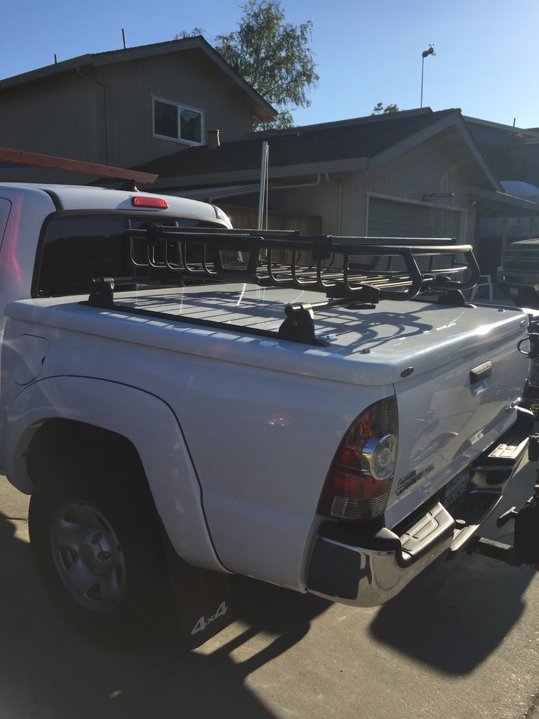

    I installed this Yakima track system on my '12.

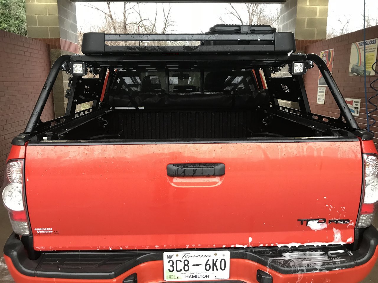

    It’s not 100% yet, but with some modifications I was able to get the CBI bedrack to work with a soft top. Next stop is a seamstress to take about an inch and a half out of the width.

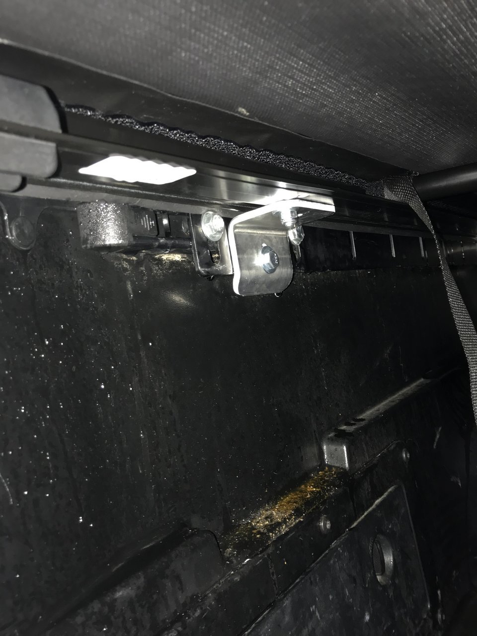

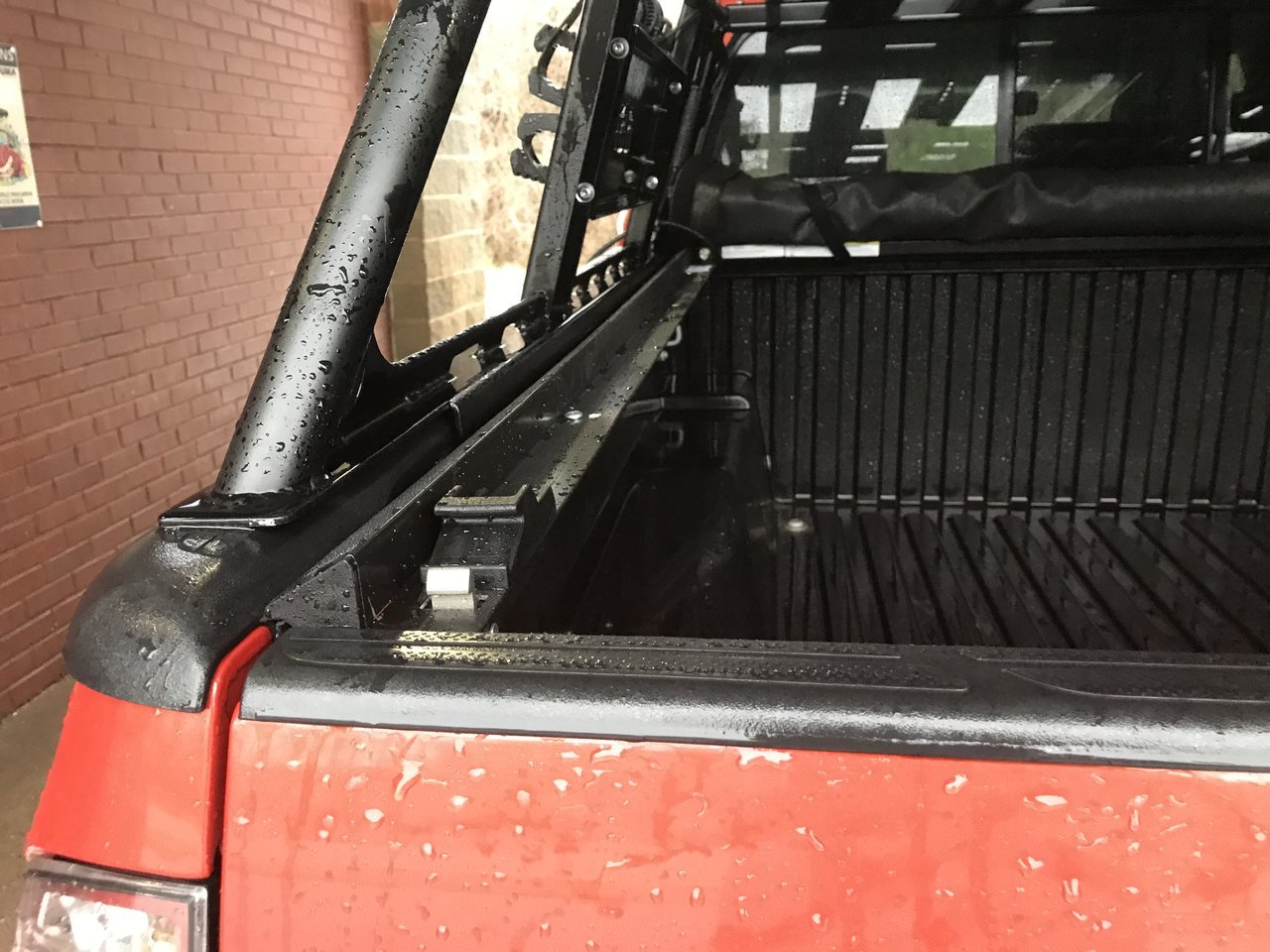

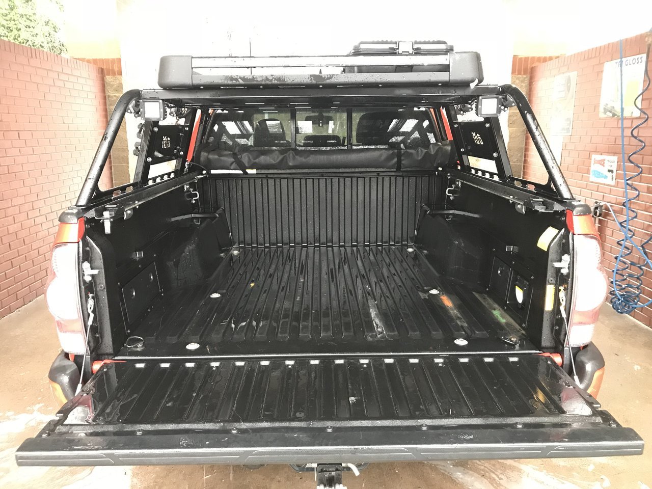

    I can roll it up once it stops raining for some pictures. It's still difficult to roll because it's about 2 inches to wide right now. Once It's been redone it will be easier to roll. Once the rain stops I'll grab some pictures, but basically we had to drill new holes in the CBI Bedrack just below the rail mounts. We then used the L-shaped brackets and new holes to mount the rails for the cover inside the bed, vs on top of the side rails. Because it's inside and not on the top, it's a couple inches narrower in width. So we had to cut the front and rear mounts and each of the poles down the center. It took a few hours and two people but in the end it's worth it. I'll get some pictures that will help explain it once the rain finally stops.
