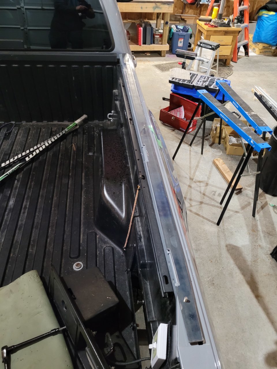

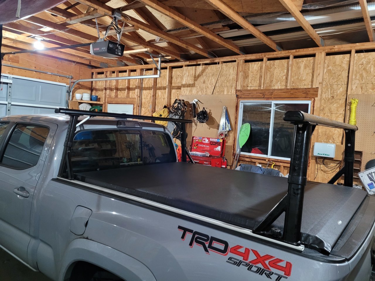

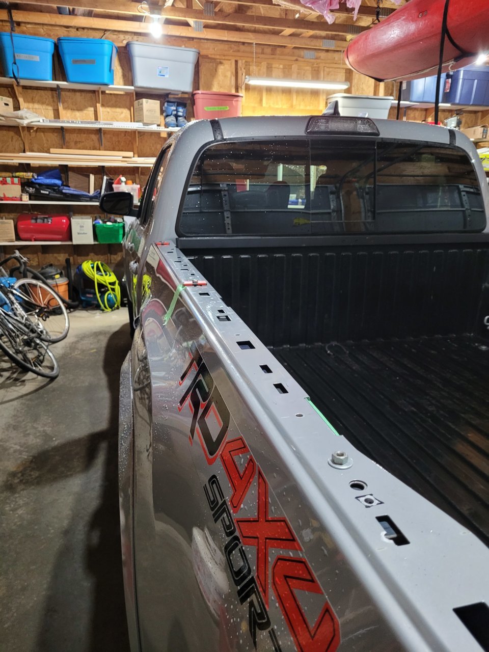

    I used a vantech P3000 rack with an access literider tonneau cover. I put some 1/4" steel plate under the fenders and bolted the track through that.
