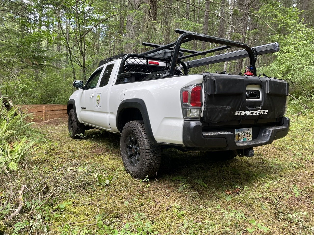

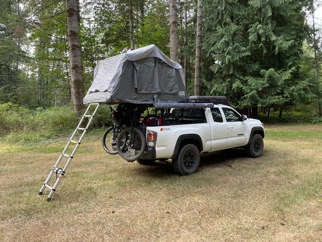

    E4E30915-048E-43A9-B3A1-1002D357843A.jpg 3CA35DB7-8267-475E-98DC-4FCEC51C56B4.jpg
    I have a DeeZee aluminum rack. My truck bed is 6’ long and the back of the rack sits about a foot from the tailgate. That gives the bikes handlebars a bit more room. It’s way easier getting a bike in with the dropper post slammed, and easier to fit more bikes that way. Road/gravel bikes are a bit more of a challenge/juggle to get in, but it works. That’s a 29’er pictured.
