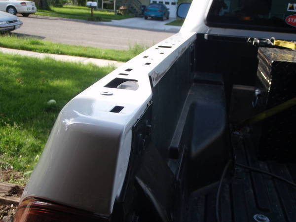

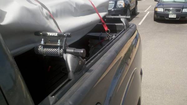

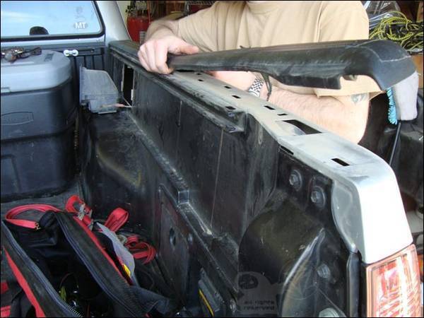

    I had the idea come to me to use the Yakima tracks and control towers along the top of the bed sides to mount accessories to. I am wondering how easy it is to access the underside of the bed sides in order to mount the tracks.
    Here is a picture of the rack system.
    I haven't looked too closely at the bed sides but here is a picture of someone getting under the plastic.
    Anyone think its possible? Do I need to remove the whole composite bed liner, or the liner inside the wheelwell?
    thanks in advance for any input.

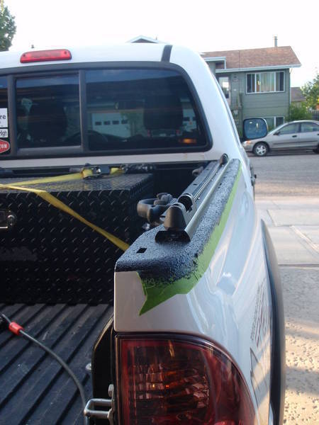

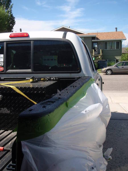

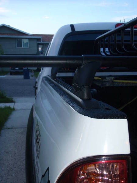

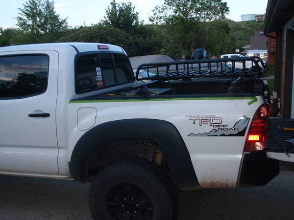

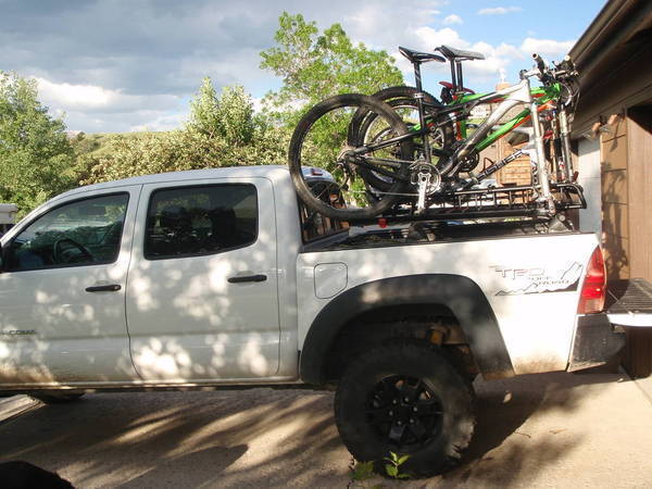

    Ok so I finally got the rack on. I removed the bed rail caps completely and mounted directly to the bed sides. I used plusnuts, 5 on each side. It seemed that in order to get a solid mount to the bed the plastic rail caps had to be removed. They would become deformed with the weight of the rack and gear, and also be a PITA to line up the holes for the plusnuts. I also put bed liner on the exposed painted surface after removing the bed rail caps.
    My rack setup includes: 54" Tracks, Control Towers, Landing Pads, 72" Cross Bars, 2 Vipers, 2 Boas, and a Load Warrior.
    I plan on cutting down the bars some. I envision catching a tree on one while offroading and causing some serious damage to the whole system.

    The rack is working out great so far. I chopped 4.5" off the ends of the bars so I wouldn't be grabbin trees. Also tested the ease of removal/install today. I can pick the whole rack up and off the truck by myself. Its nice to be able to get it off quick so I can still use the truck bed like a truck bed sometimes.:cool:
