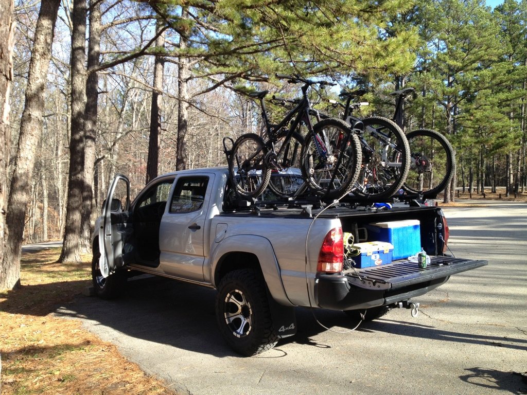

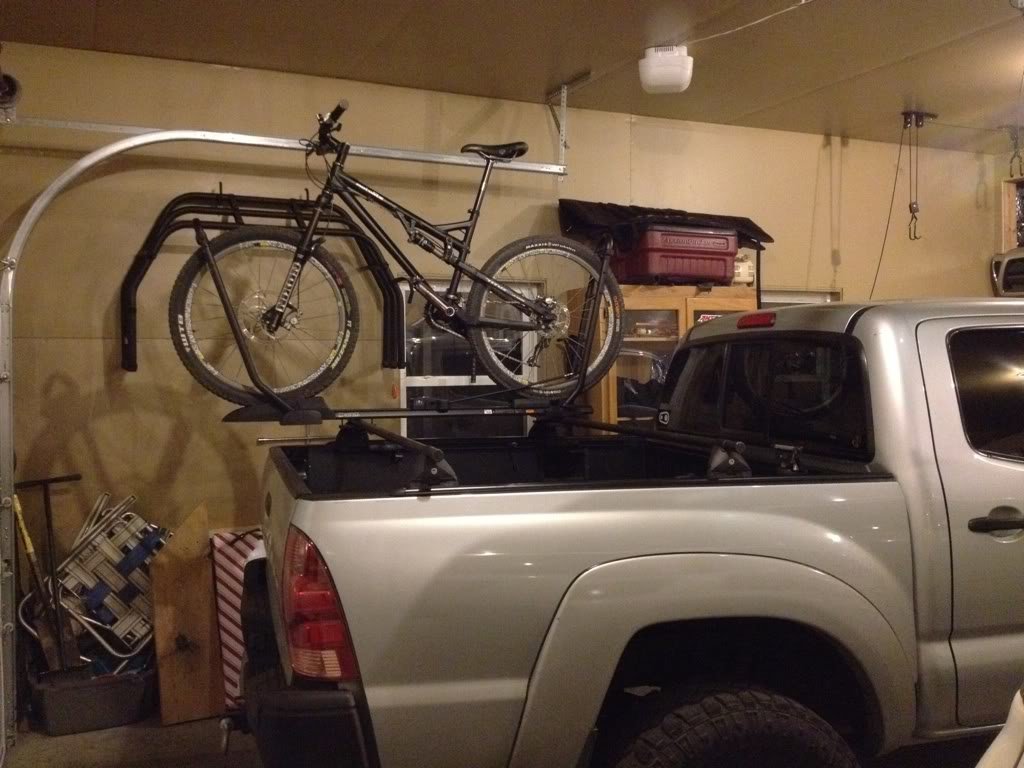

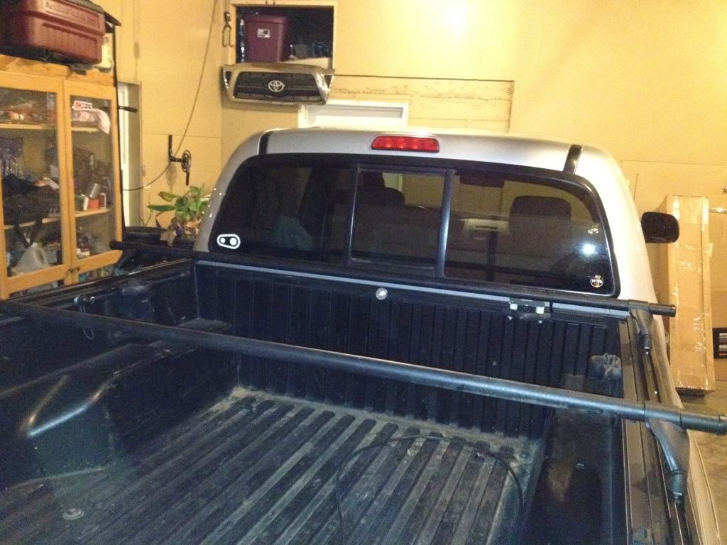

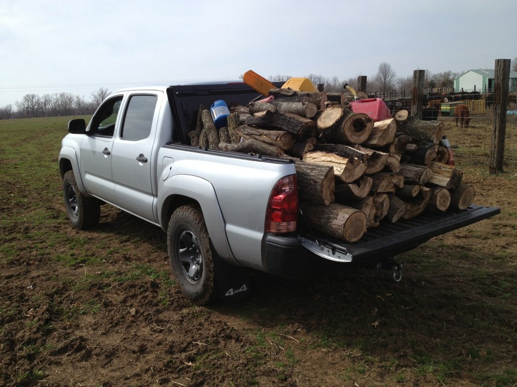

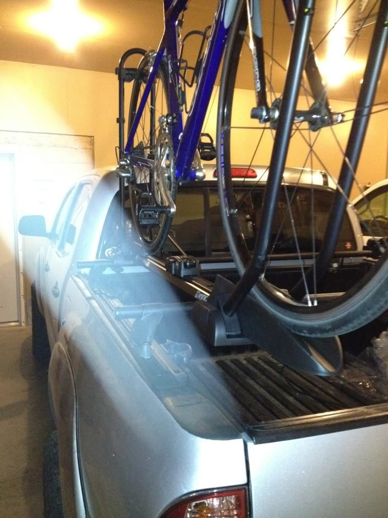

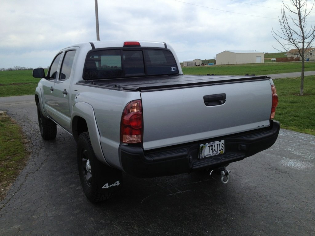

    Update: Going on year and a half with my rack over BakFlip setup and its been AWESOME!
    Just a few pics to demonstrate versatilility and utility of set-up.

    old thread but i can answer some questions. you can attach the Yakima universal rails on top of the plastic caps. Mark and drill a small pilot hole in each spot, then i used thick stainless steel sheet metal screws. make sure all the screws are snugged down into the sheet metal of the bed tight. Be careful the screws need a flat head so you can slide the rail cleats up and down the tracks. Once the screws and rack system are tight it will support my weight, the basket, and hi-lift (prob almost 300 lbs all together) with no problem at all.
    Yes, the roll up cover can be rolled up with everything in place, you have to slide the cover and bars under everything then roll the cover up. takes a minute or two but it can be done.
    Here is my parts list for anyone that is curious about this setup.
    -Yakima 60 inch tracks (new off ebay $95)
    -Yakima 66 inch crossbars cut to length (used off ebay $60)
    -Yakima railrider 1 towers (new old stock off ebay $48) Yakima does not make the "railrider" towers anymore, they replaced them with "control towers", they are much more expensive. i believe you need the "control towers 1 when you use the universal tracks.)
    -Yakima loadwarrior basket (local camping/outdoor store $220)
    -2 Yakima snaparounds (free from the guy at the camping store)
    I did this for around $430, all new from Yakima or in store I would be around $550.
    This setup is so versatile and useful. I use it for my ocean kayak, Hi-lift, basket full of camping gear or firewood, and the bed is still wide open.
    I attached some pictures of the system close up and one with everything off, you don't even notice the Yakima tracks.
