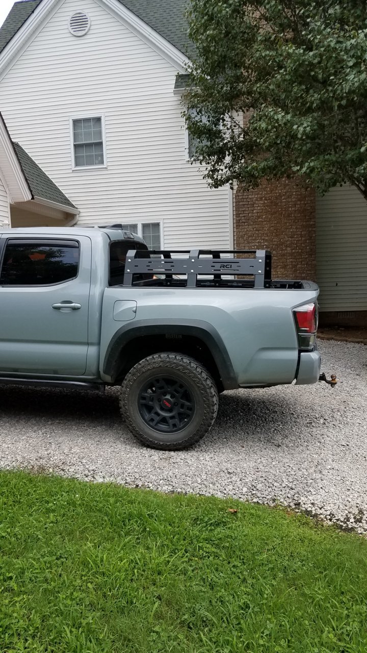

    And by the way, there are many different companies offering racks too. RCI, CBI, Cali Raised, KB Voodoo, and I'm sure many more. I have the RCI and love the functionality and look of it. 20190721_125843.jpg

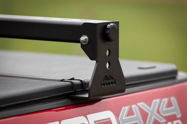

    I have a KBvoodoo rack with a PaceEdwards fullmetal jackrabbit. I dont love the rack but being able to have the tonneau is nice

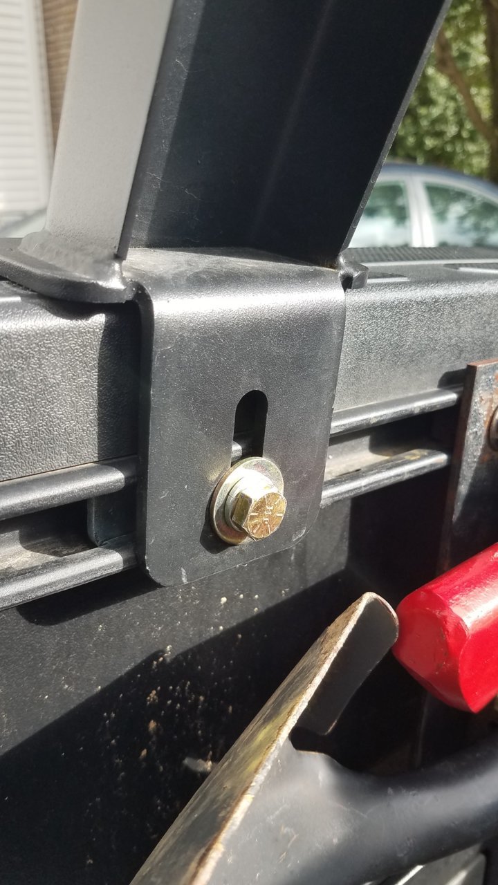

    @kevinlambchops - do you have your rack mounted on KBVoodoo brackets like this?564178B4-B875-4B3A-AB9B-6C3FDA62AD36.jpg

    22,351
    Yep…
