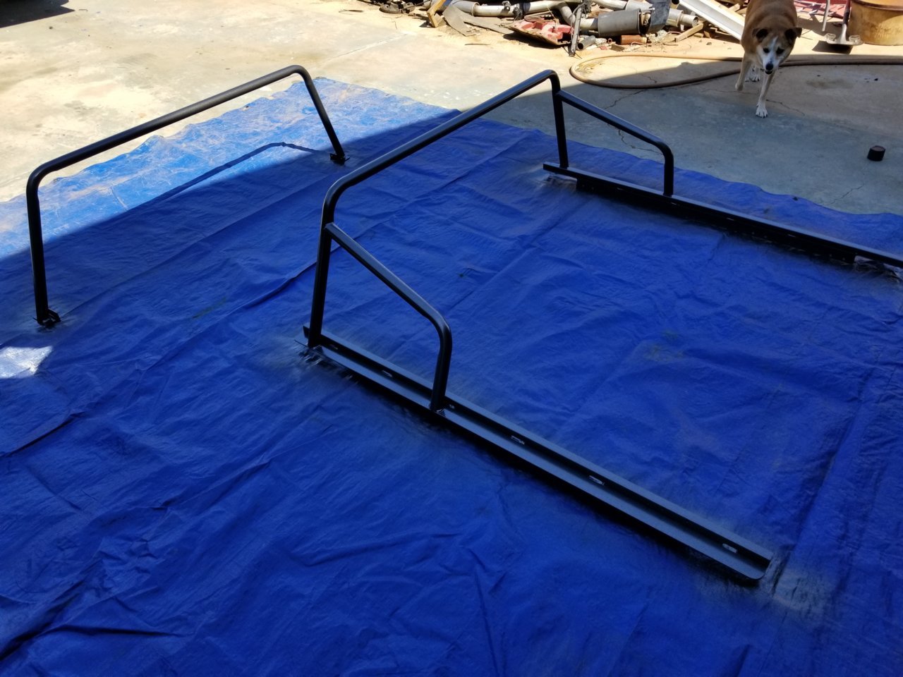

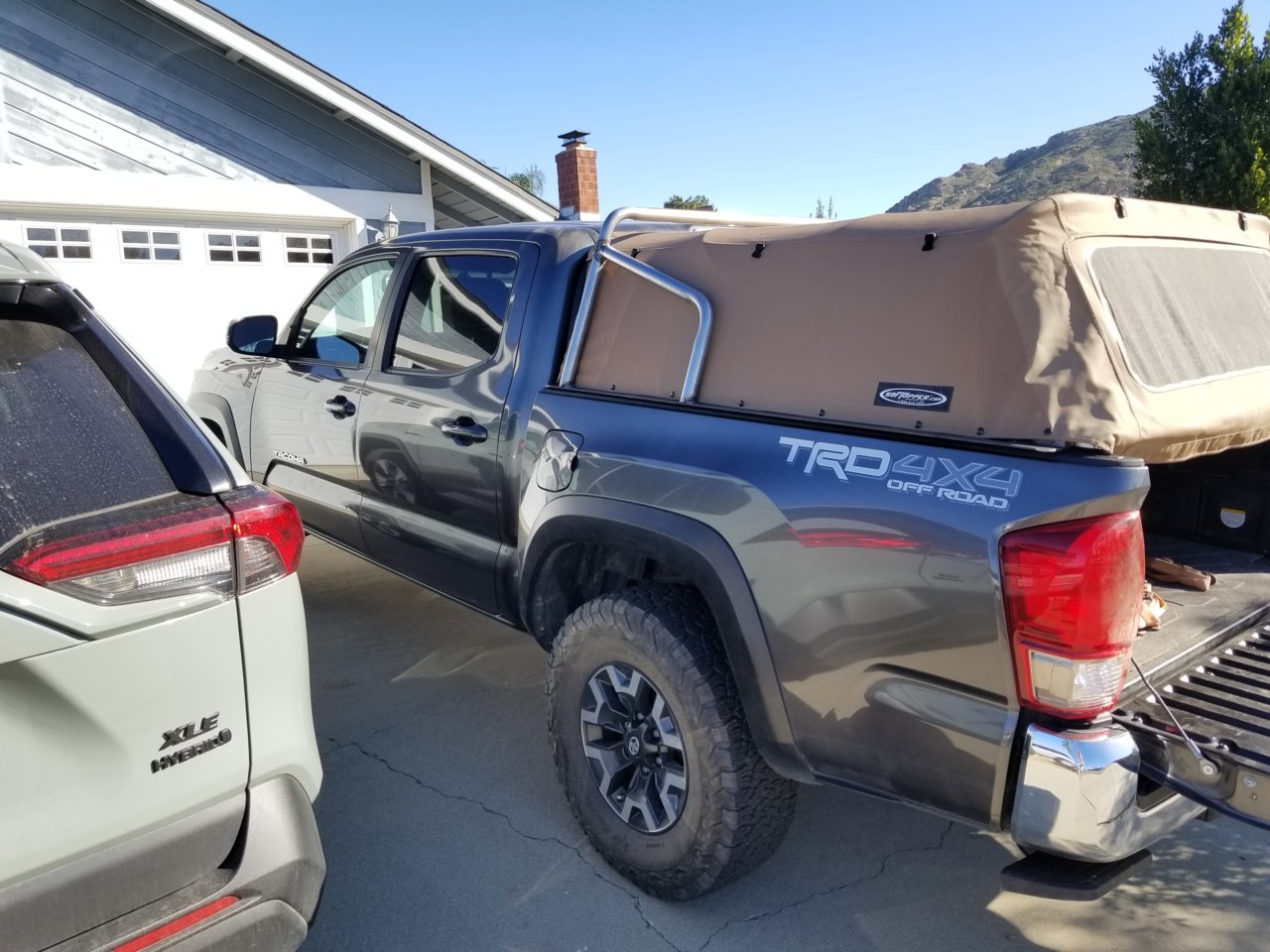

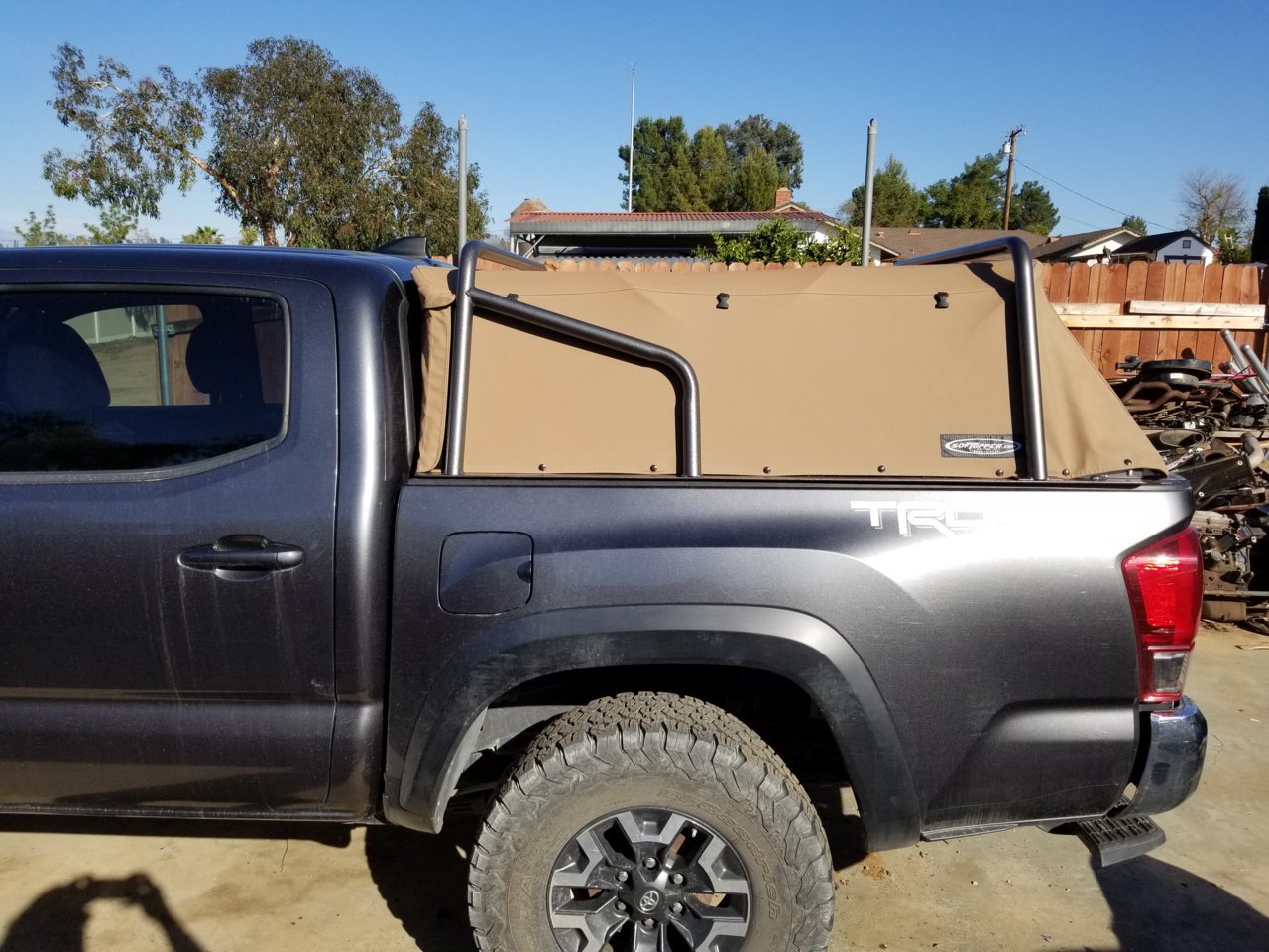

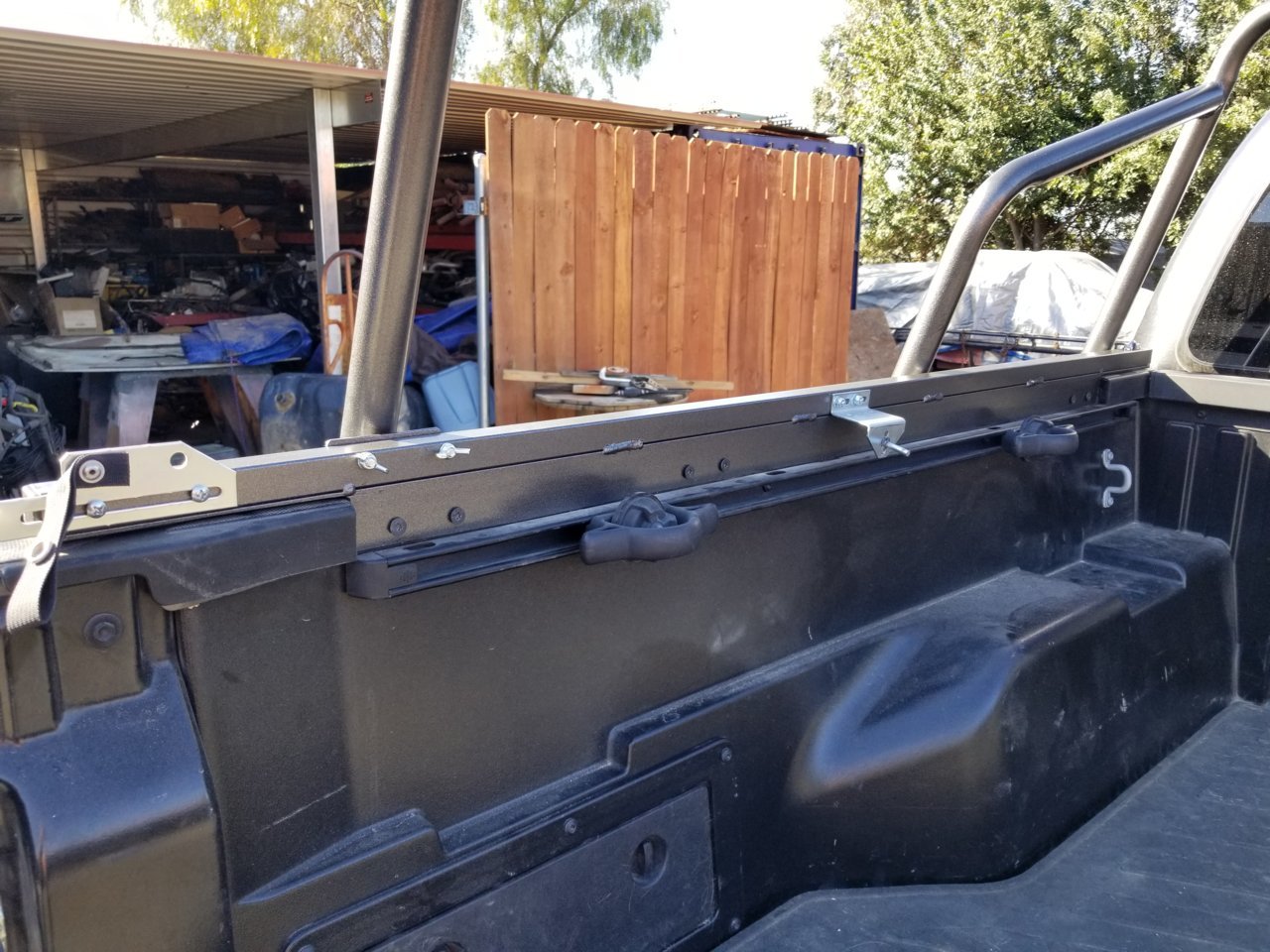

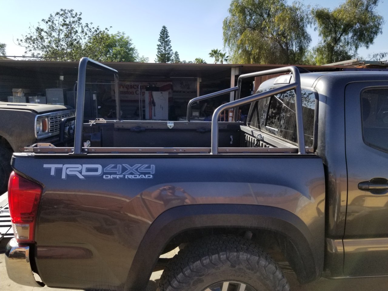

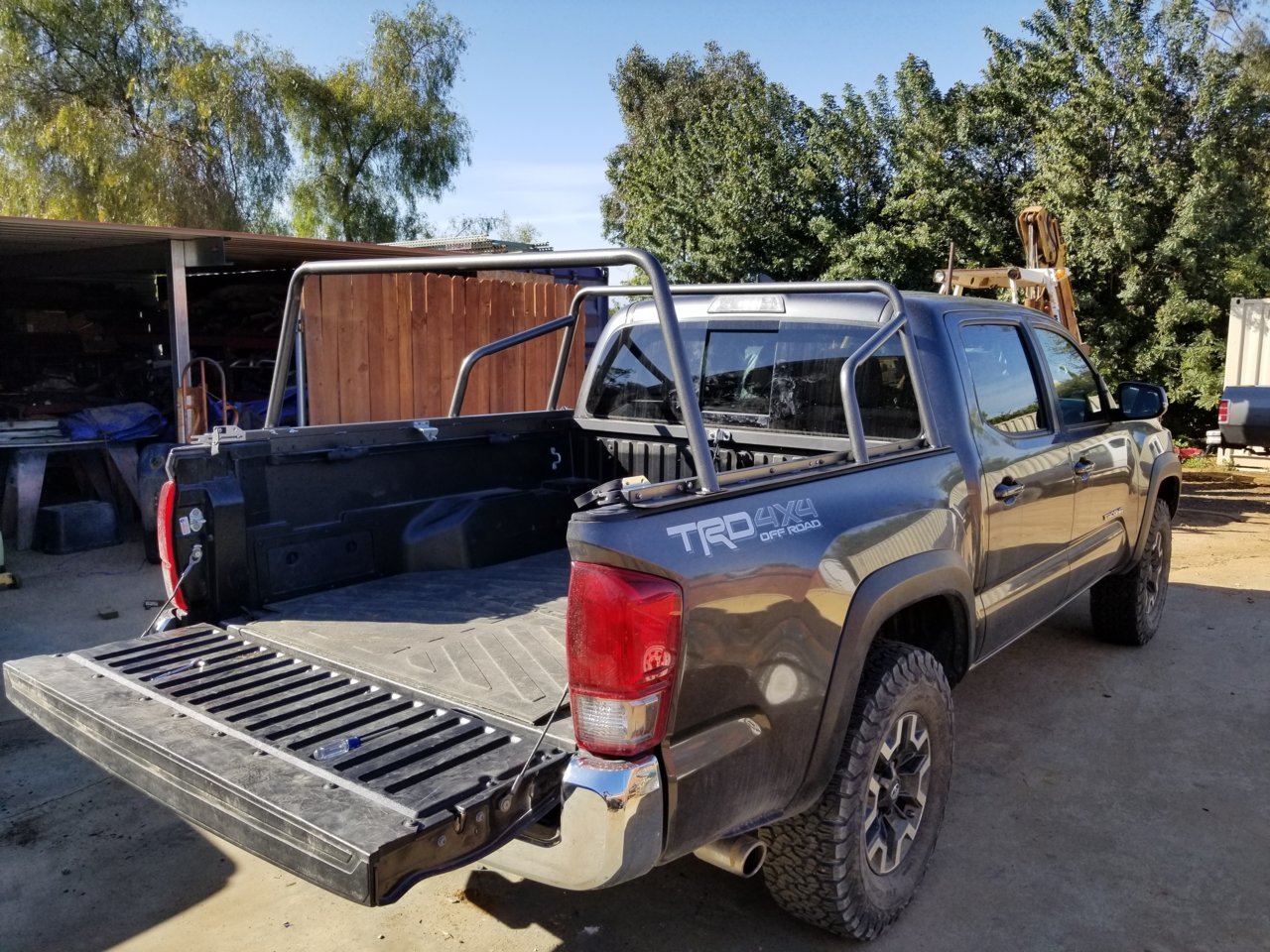

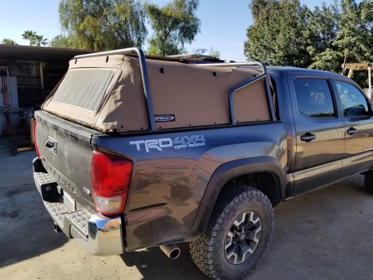

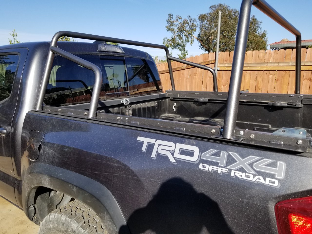

    Saw this thread pop-up the day after I finished my custom rack-over-softopper solution. I needed mine to mount kayaks to while also keeping the softopper up for the dogs on the way up there. Decided to go with an always mounted "rollbar" in the front with a kicker and a removable back bar to attach when loading up the kayaks.
    Going to paint it tomorrow so I'll try and get some more pictures then. Dont have any with the back bar on yet, but the topper can fold up easily with the front bar always on. I also rebuilt the softopper snap bar and integrated it to the rack system so I stop getting the flex issue on the bed caps. 20210221_090027.jpg 20210228_105638.jpg

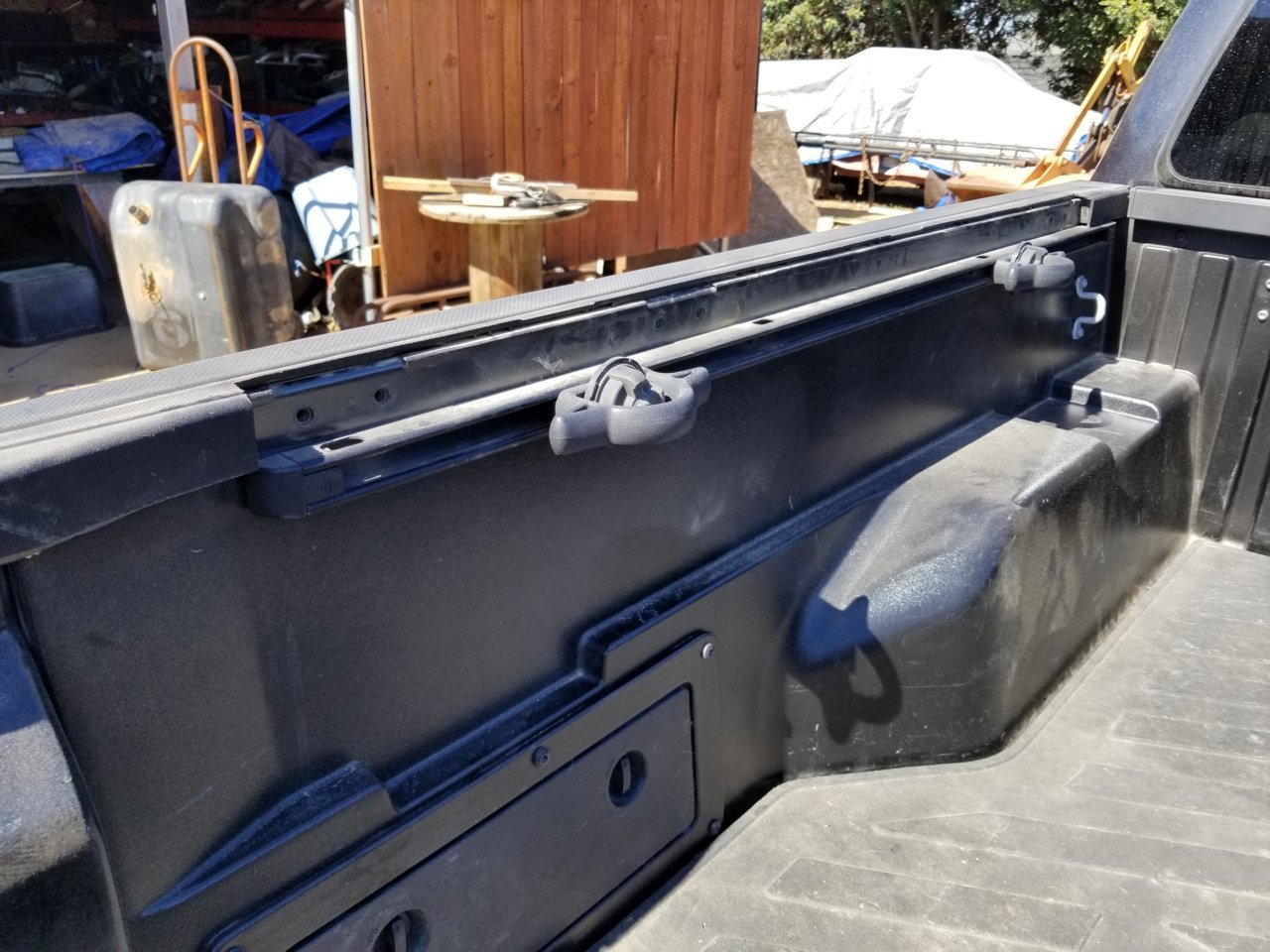

    This seems to be the thread for bed racks over softopper now so I'll follow-up with those finished pictures.
    Here is the full rack:
    Mounting positions:
    Rack on it's own:
    And Rack over the Softopper:

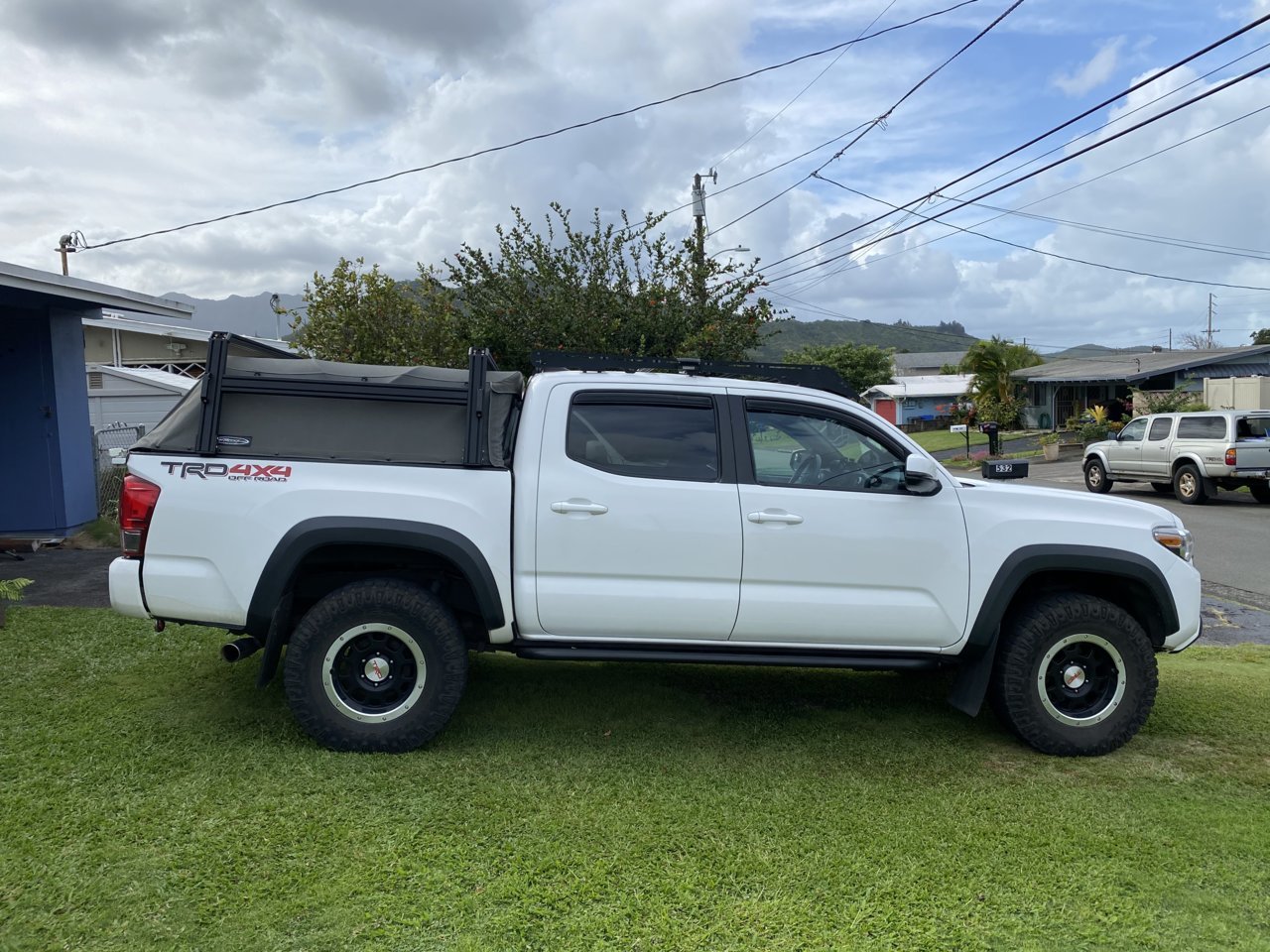

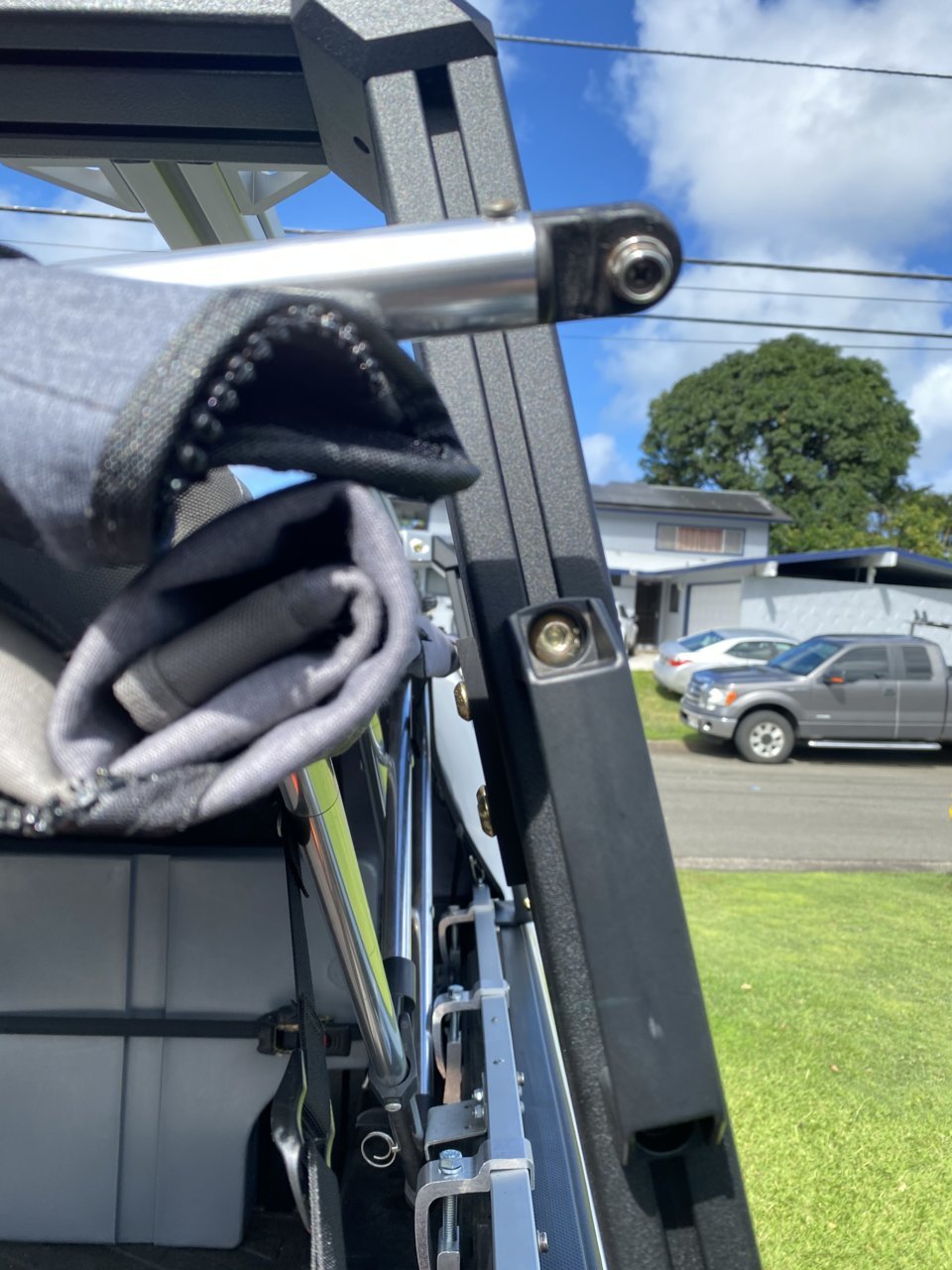

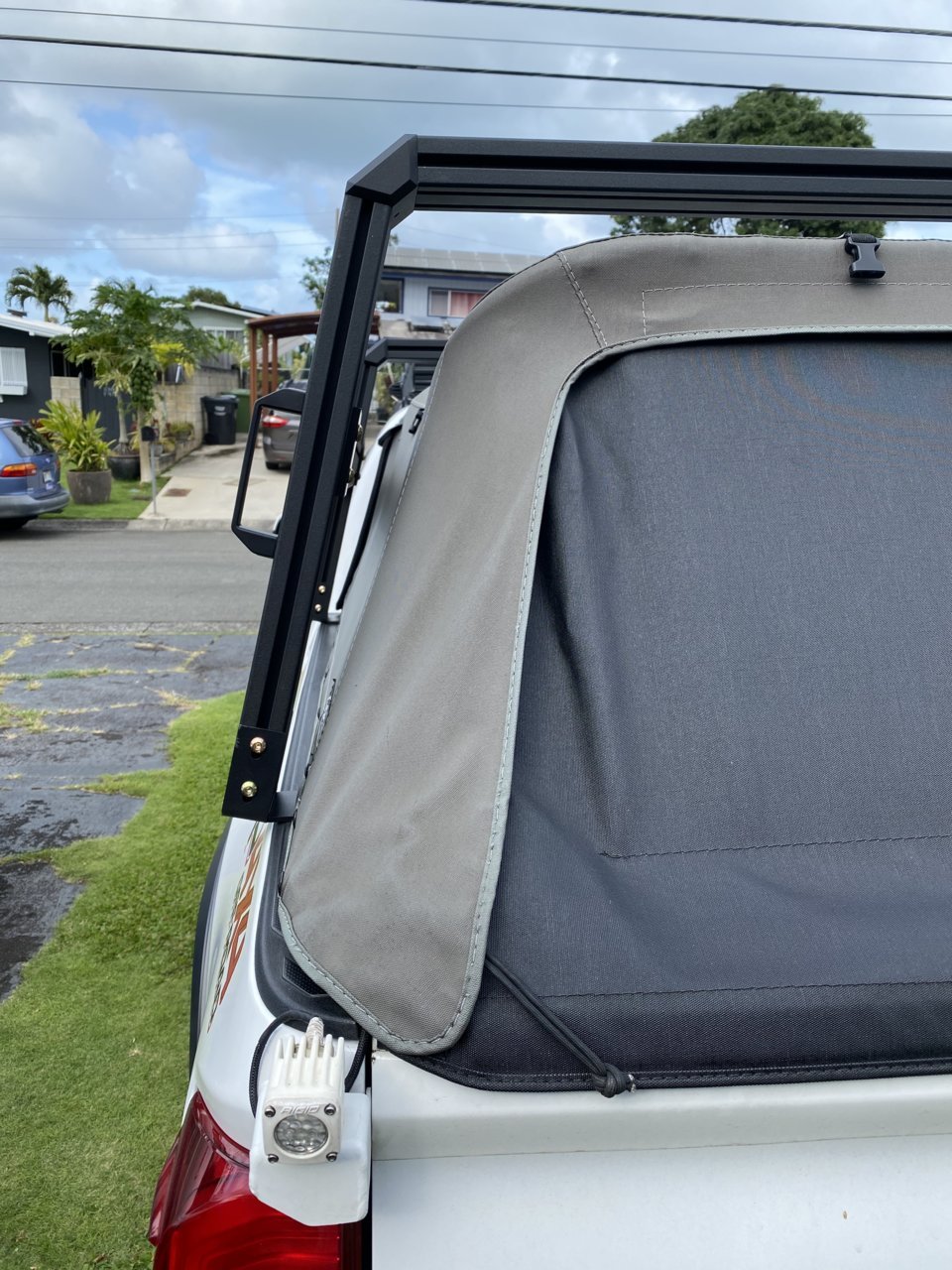

    Rack installed! Xtrusion Overland sent me the 13.3 degree hardware to try out. The normal hardware is 20 degrees I believe. The 13.3 degree hardware was created to provide clearance for the Softopper.
    Install was pretty easy. No major fitment issues or other issues.
    Only problem is the the XTR1 is a tiny bit lower than my Prinsu cab rack. It’s hard to account for all aftermarket accessories that the XTR1 will have to play nicely with, so not a big deal.

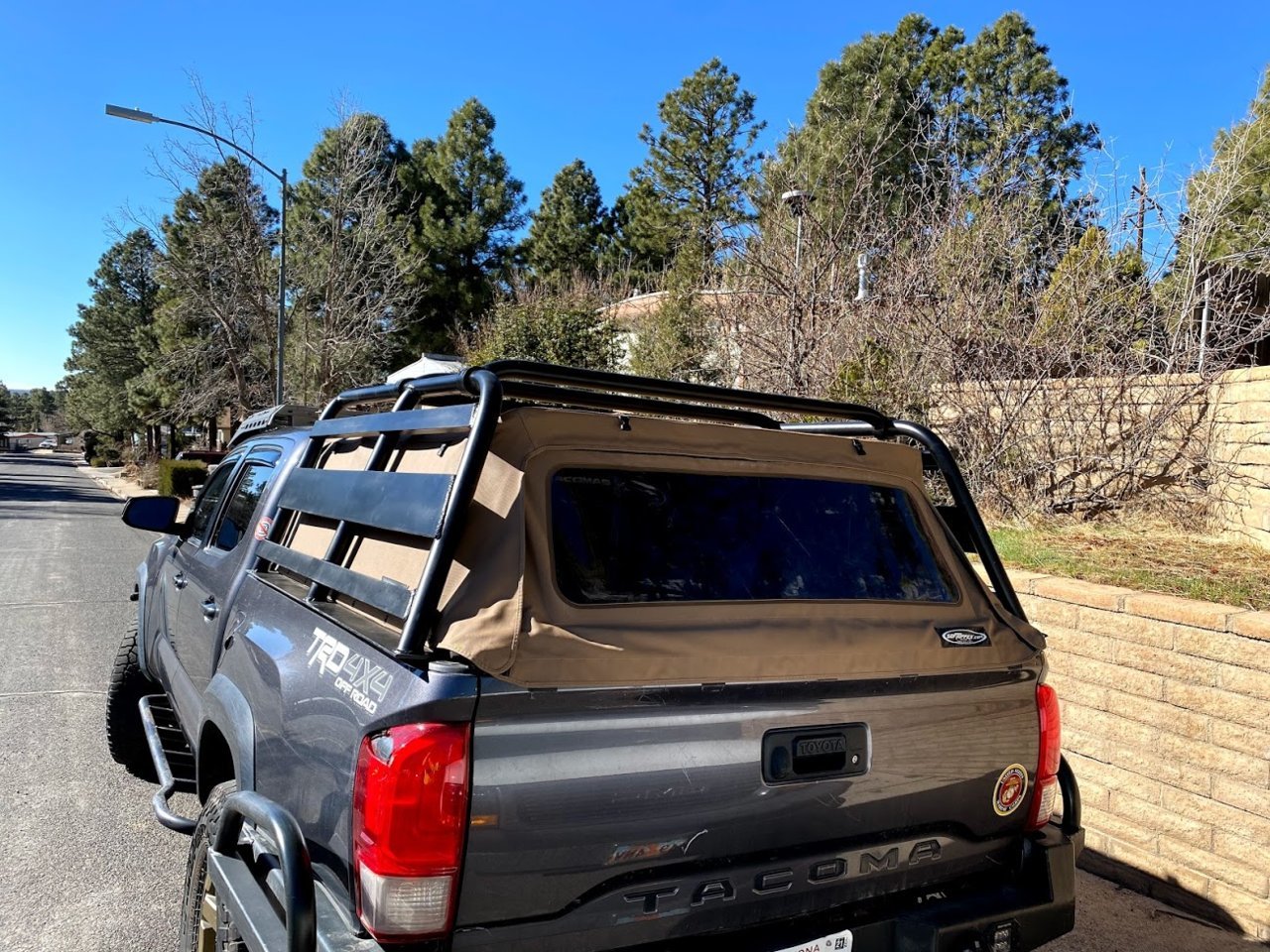

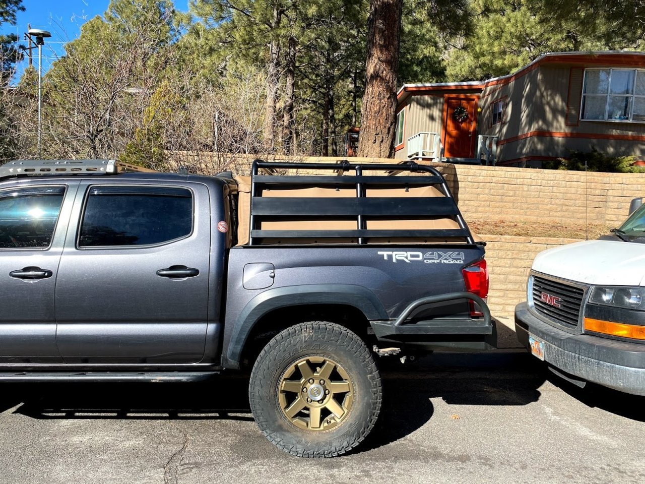

    Had a custom rack made. The rear two bars are removable/movable via the roll bar clamps on them.

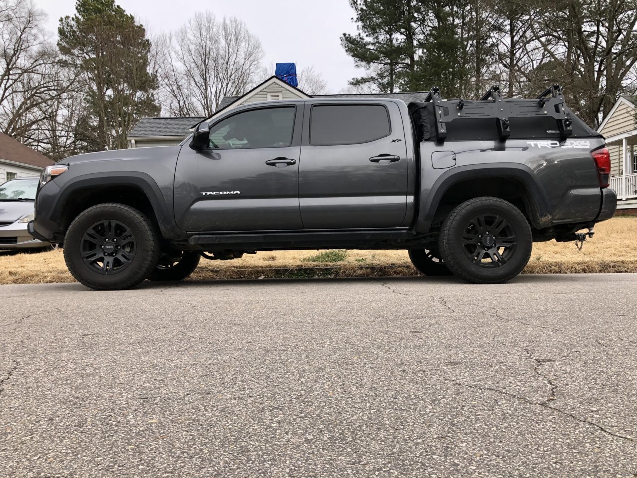

    I've been watching this thread too. I purchased the uptop overland softtopper truss rack and its sweet. I agree with aluminum being a factor in my decision to purchase it. I was able to assemble it and mount it solo. tacoma rack.jpg

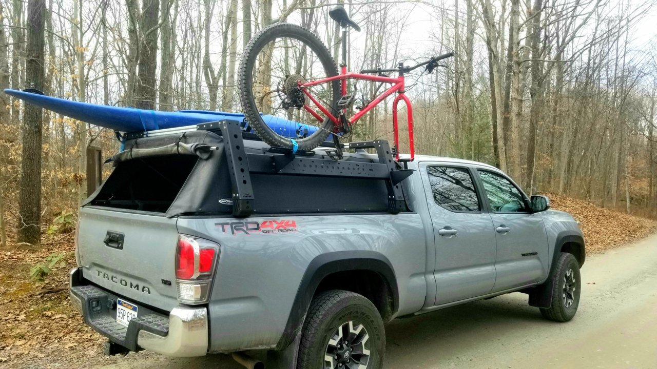

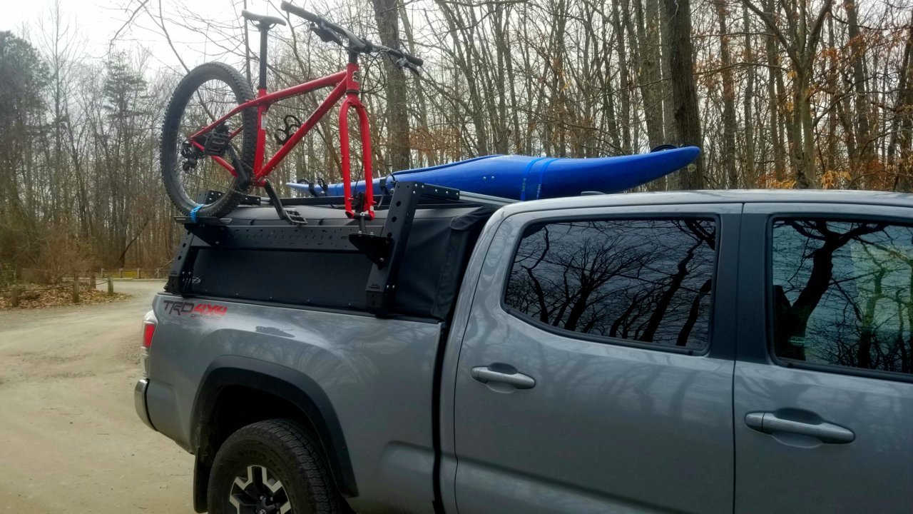

    Got my kb voodoo outboard bike rack installed this weekend. Very quick shipping. Really like it, very solid. Only real criticism is I bought one for each side, but they are not side specific, so the solid plate is facing forward on the driver side, facing backwards on the passenger side. Not a big deal and understand from a production standpoint.
    Got a bit of biking in between boating. Next is to rig up a kayaker stacker. 20210314_203629.jpg 20210314_203722.jpg

    This is exactly what I've been looking for. Need something minimalist just for transporting surfboards/kayaks over the topper.
    I'm no metal worker...did you fab this yourself? Would you be willing to make one for me?

    Yea, my brothers and I put this together with the following list of materials:
    2 x 10' (1 1/2" Tube @ .060 thickness)
    2 x 5' (1" x 1" Square tube) - for the softtopper rail
    2 x 5' (3" x 3" 90° angle @ .125 thickness)
    ~$90 - $120 in parts
    Most of the work went into aligning the snaps and holes needed on the softtopper rail with the new bar. But you'll need access to a tubing bender and a welder.
    I believe the angles we used to match the shape of the cab were 71° each side, but you could probably use square / rectangle tubing instead of round and get something similar built without having to weld. You'd also be able to attach mounting plates to the side more easily, but I liked the look of the round tubes better.

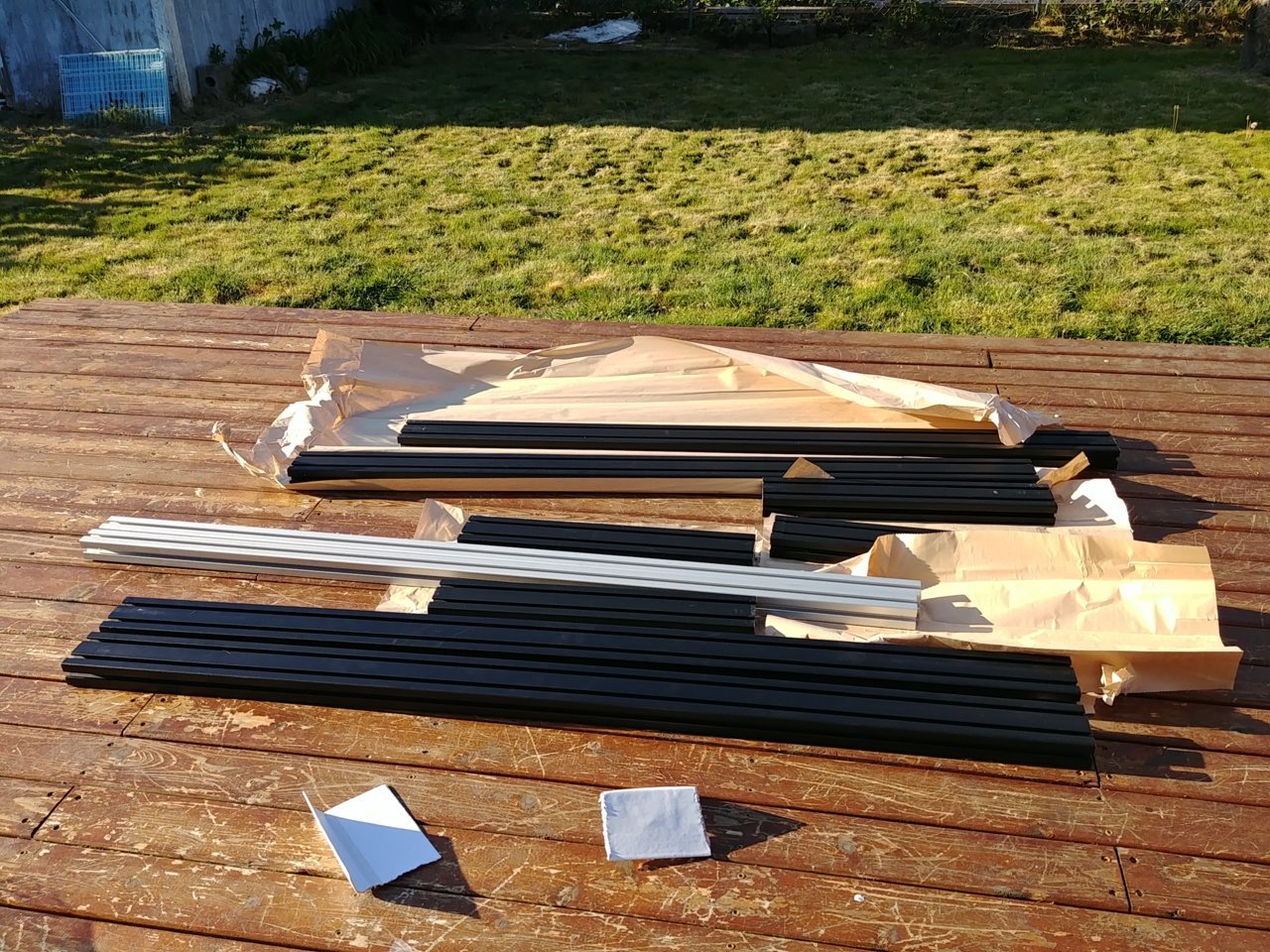

    Received my rack this afternoon... BUT only the parts in this pic arrived... Did they by chance send two packages to you?
    Have reached out to them for assistance, but of course it's evening presently, and no idea when they will respond?

    Yes, mine came in 2 separate packages like that that arrived on different days by 2 different carriers.

    What I was told by Alan Reyes is that the extrusions are drop shipped by the manufacturer. Xtrusion Overland then ships the hardware directly.
    That’s why there are two separate packages.
    My extrusions arrived first then my hardware a few weeks later.
