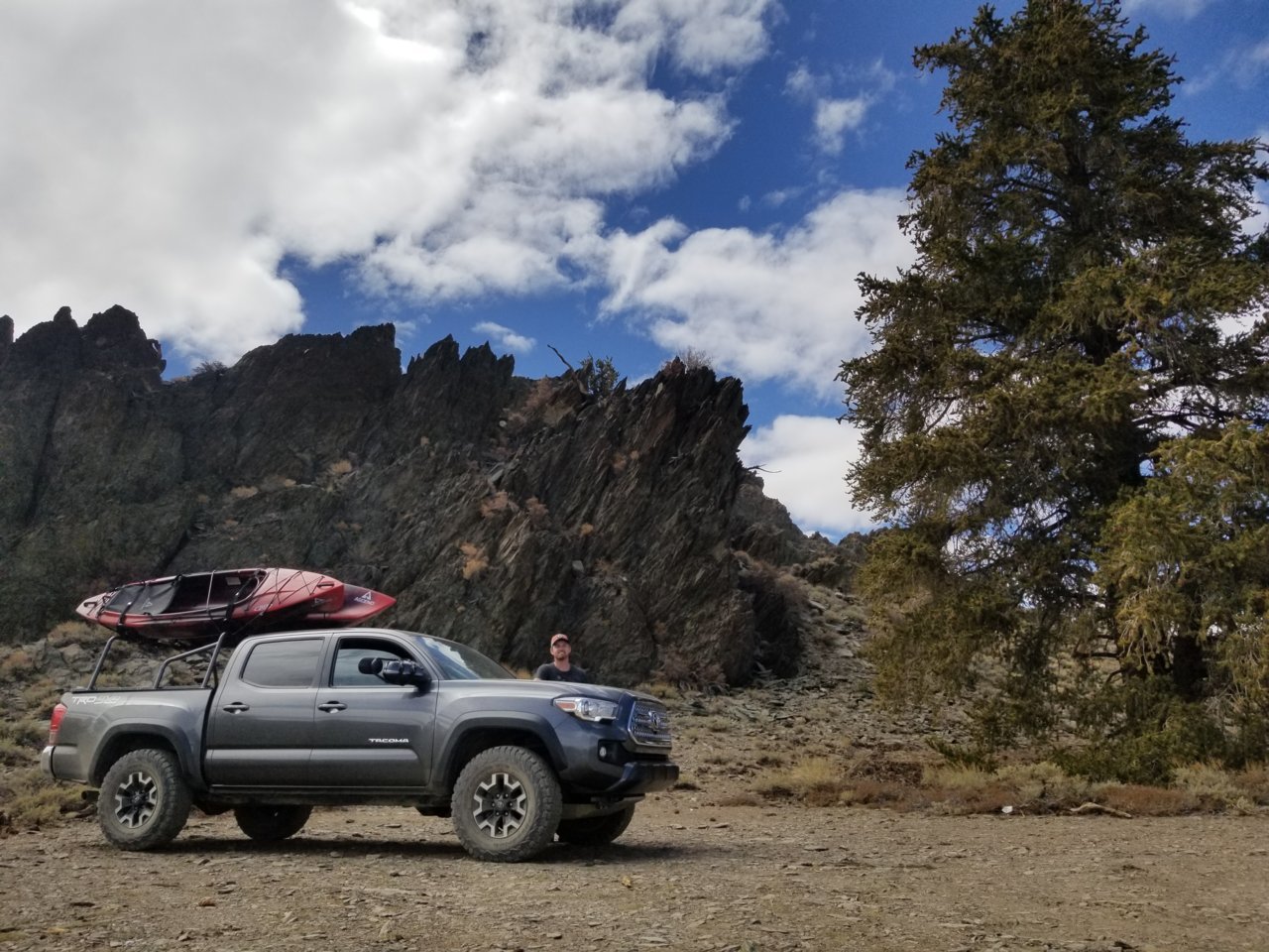

    Oh, and here's a pic with our kayaks on it from a recent trip

    ^Digging that setup and how creative it is. I like how you integrated a new rail for the ST. For me, I just wouldn't want to hack up my bed caps, kind of a bummer yours were already hacked. Although it did make it easy to set yours up the way you did. Looks trickier if you try to retain the full cap. I've been wanting to design a rack for over my topper but there are SO many options and designs and so little time to actually tackle the project :(
