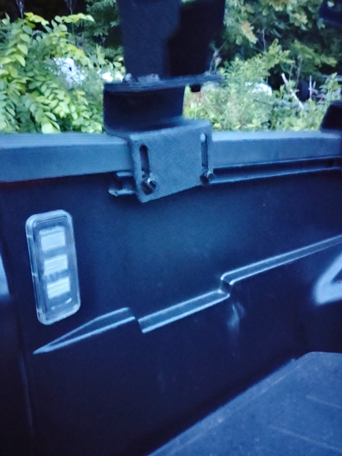

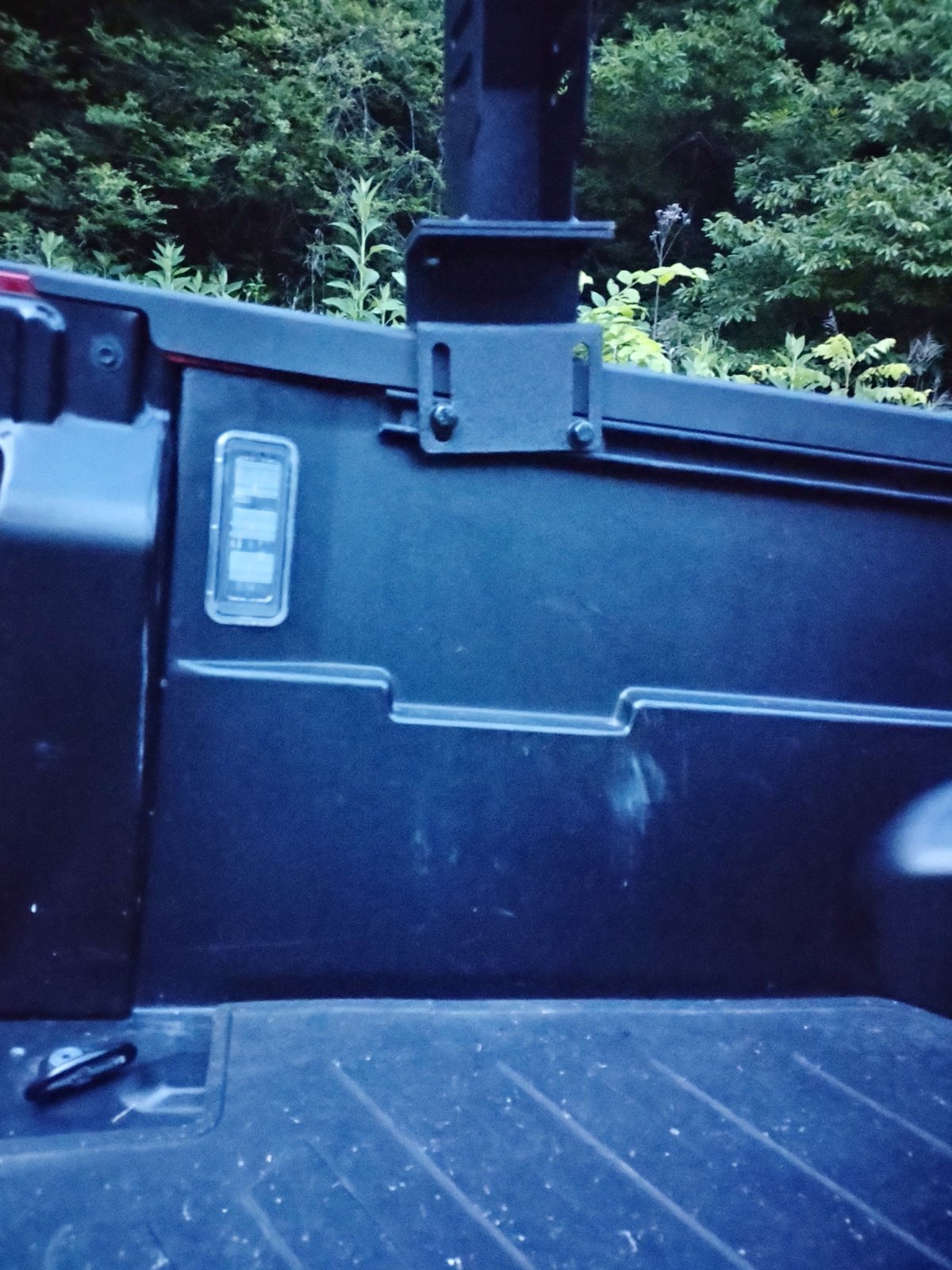

    How would you anchor this mount beside the tailgate?

    Is the front one as far forward as it can go?
    Looks like long bed rack on a short bed.

    That's what I initially thought, but the track is a foot from the end of the bed.

    I guess I'm not seeing what the issue is other than the bracket being crooked? What's wrong with how it's mounted now?
    Mine are about as far out as they can be on that rail and I'm only using 1 bolt per bracket.

    3/16 steel or 3/8 aluminum 2x2 or 2x3 L angle length of bed. Drill and anchor down leg to your sidewalls. Mount spacers under horizontal or countersink Flathead bolts pointing up to anchor your rack or a homemade rack plate.

    Looks like you could just drill another hole towards the middle, and then you would have 2 bolts with the bracket straight.
