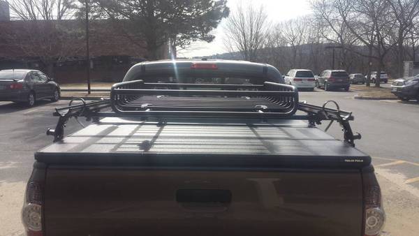

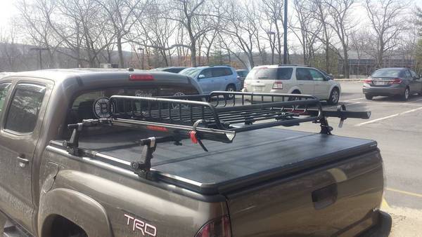

    So I recently decided to ditch the setup I had before which was KBVoodoo bed brackets, Yakima LoadWarrior, Rocky Mounts Clutch SD. Unfortunately I do not have a picture of my old setup handy. The reason for the change was I had the chance to purchase an Extang Solid Fold for a price I could not refuse from a coworker who sold his Tacoma.
    My new setup took a good amount of parts, but it seems pretty solid so far. Just wanted to post it in case anyone was looking to do something similar. Here's what it looks like:

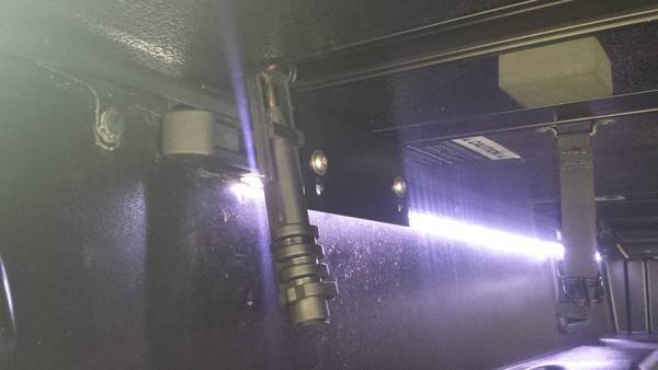

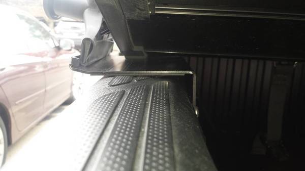

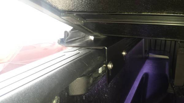

    Here are some pictures of the Summit Racks Bracket:

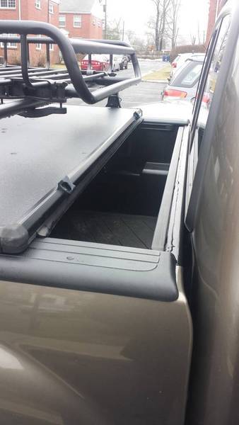

    So I tried sliding the tonneau cover off. Not what I expected, but it's okay.
    This is how far I got:
    Weatherstripping got stuck on bracket. Raingutter mounts are not allowing for cover to be lifted enough to clear the bracket. Oh well.
    Suppose if I really want it off, I'll just remove the rack in one piece, take off the cover, and put the rack back on.

    I added some photos of the brackets. I'll continue to add more since there is interest. My original inspiration was from someone who had used Yakima's permanent system and drilled into their tonneau cover. That was my original plan too until I thought more about it and decided I wanted to try to avoid damaging the cover. So now with this set up, not only did I not damage the cover, but the cover can be removed. :) I'm going to do a dry run of the cover removal tomorrow and I'll be sure to take pictures.

    Added pictures of my tonneau cover removal attempt.
