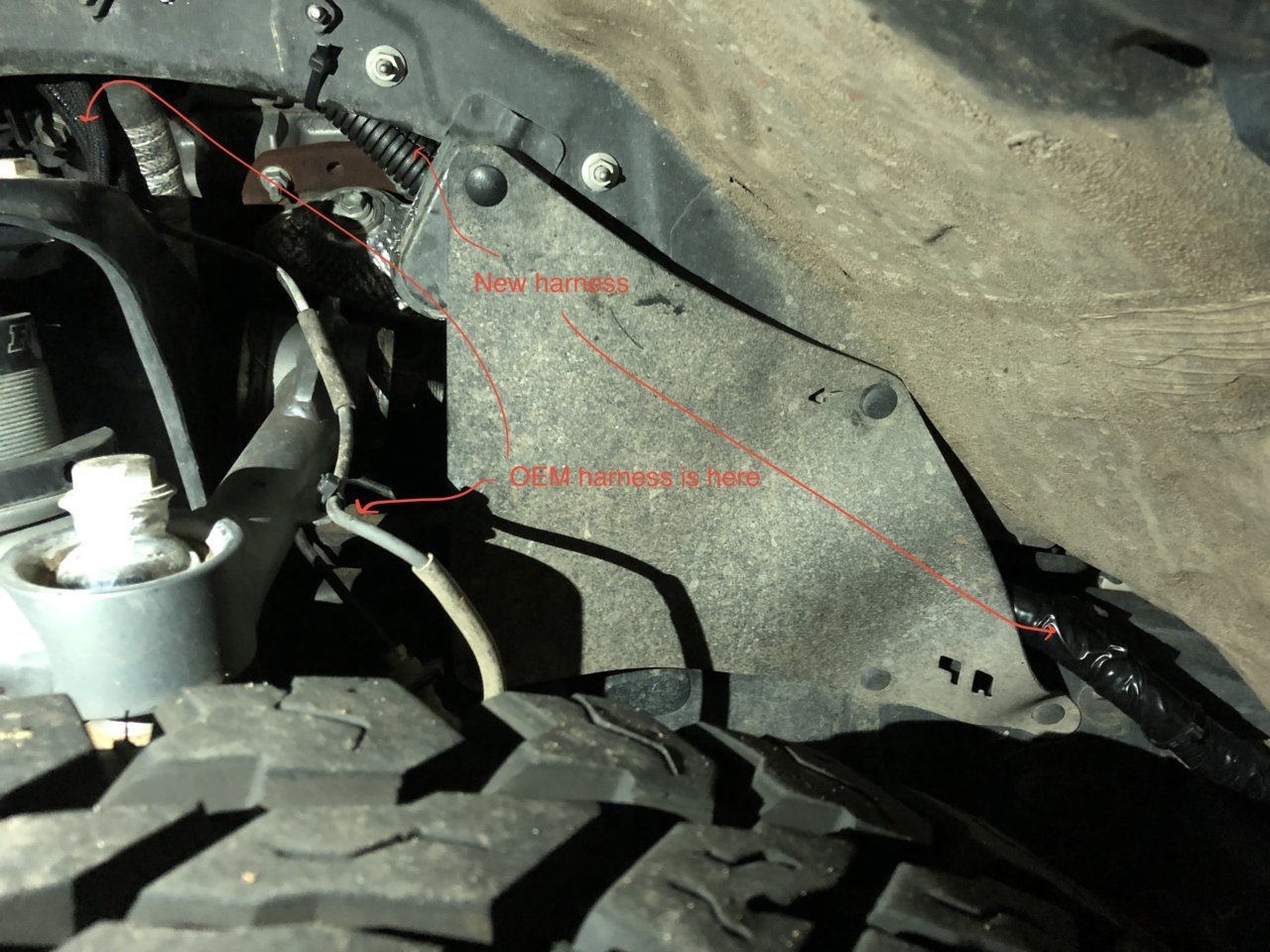

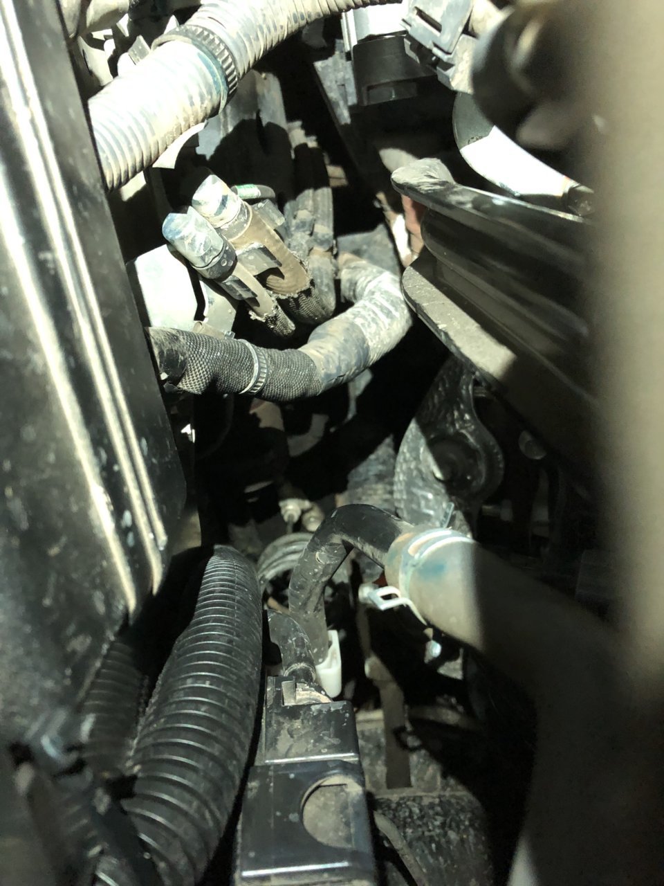

    I ran the wires along the oem/stock harness, but in the drivers side front wheelwell, the OEM harness goes under the brake line before going up to the fuse box. I instead ran it by the fuel lines (I think), since I didn't want to be so close the UCA.
    I have 14 gauge automotive wire pairs each wrapped in their own wire braids, and then where it exits under the frame by the cab mount it is wrapped in a split loom. The end of the split loom is wrapped in electrical tape as well.
