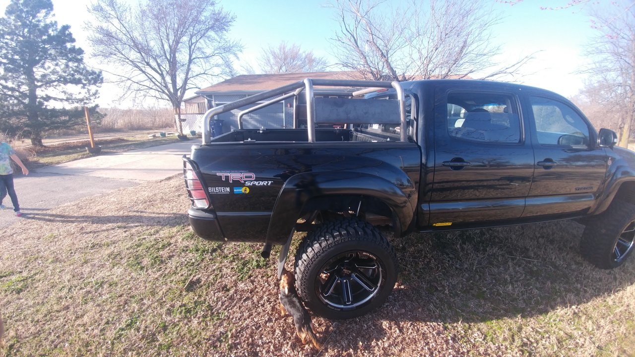

    Built a bed rack for my 2013 toyota tacoma short bed and need some feed back on what is the best way to paint it. Should I powder coat it or paint it or plastic dip? New to tacoma world and any ideas would be helpful. Working on my roof rack and tire carrier presently.0321191800.jpg

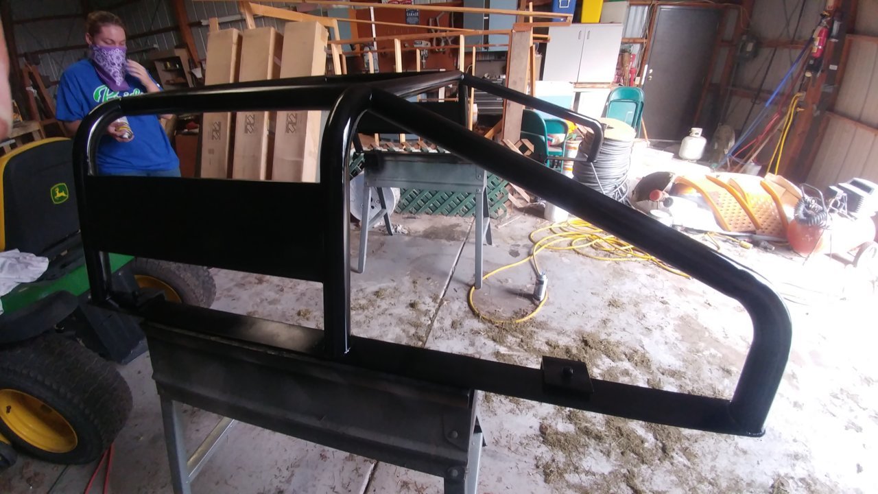

    Well I can afford to powder coat but I'm a cheap ass too so I already sanded it cleaned it with aceatone and primed it waiting to do another coat then putting on multiple coats rustoluem gloss put on 3 coats of gloss coming together0323191504a.jpg 0323191649.jpg
