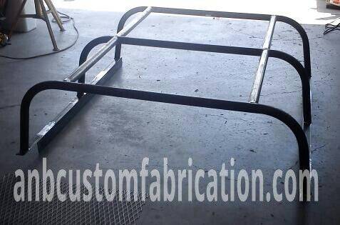

    I've been considering doing that as an option for the one I'm having fabricated right now. Current plans are to mount it on top, but I see no reason why I couldn't mount it underneath. This is pic of the rack. it still needs the tire mount and hi lift mount added. I also had a CB tab welded up front.

    I asked this question a while back on a different thread where somebody had posted a picture of their rack. It seemed to get no responses - I almost wondered if I was thinking crazy stuff that wasn't really feasible. Now I feel better! I am curious to see if/how this idea has been tried.
