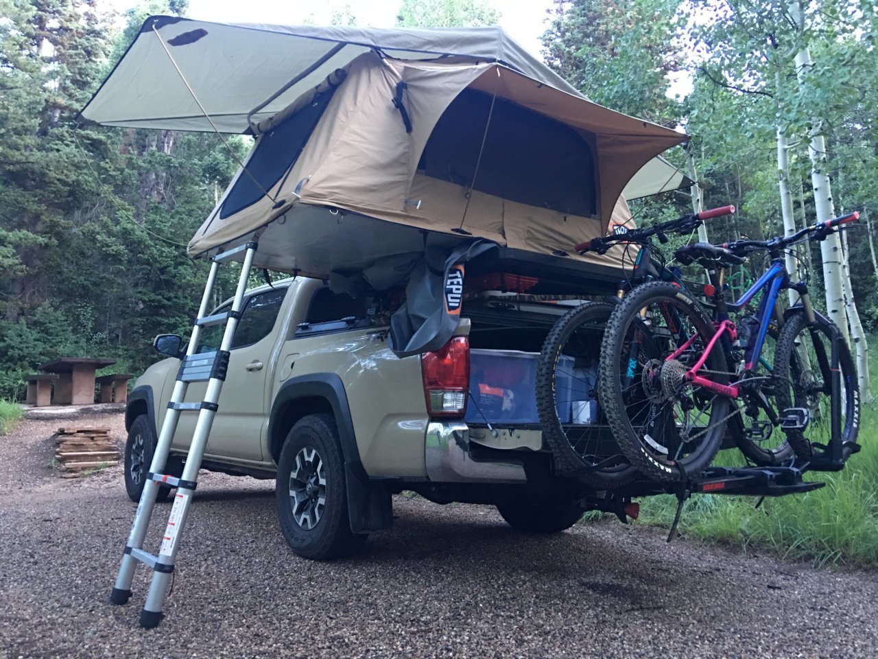

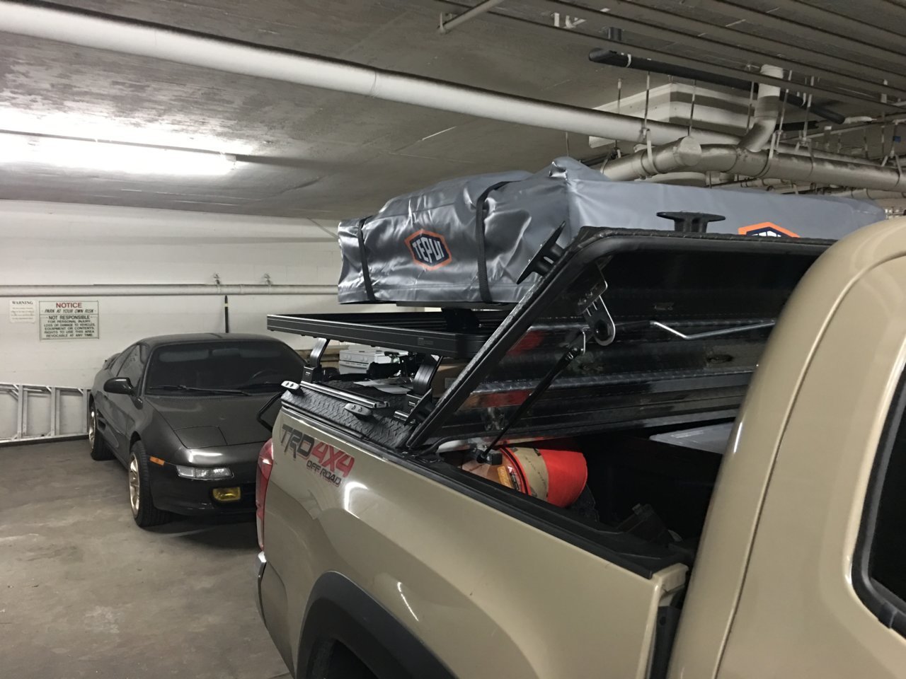

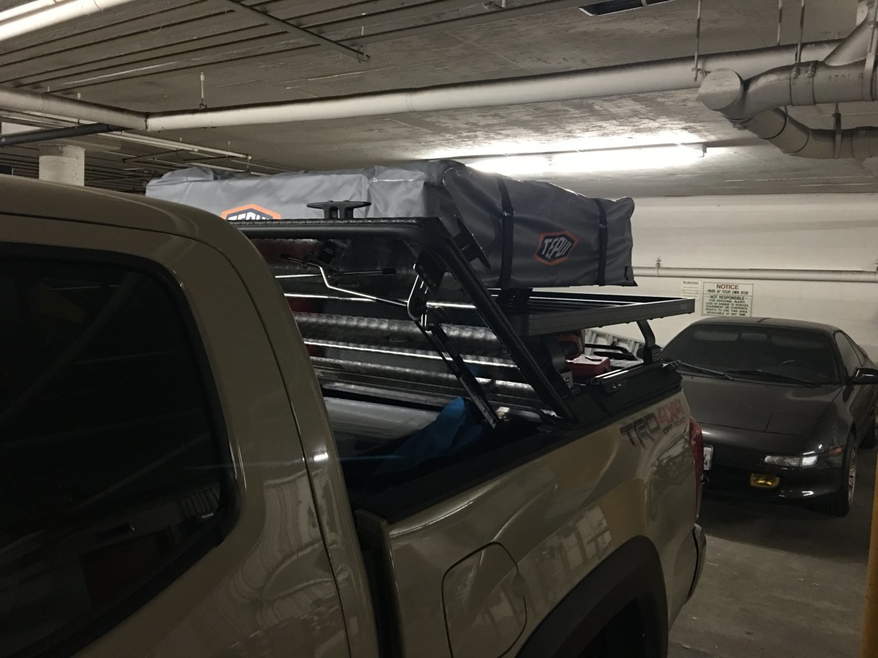

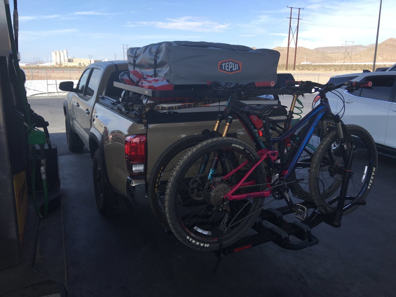

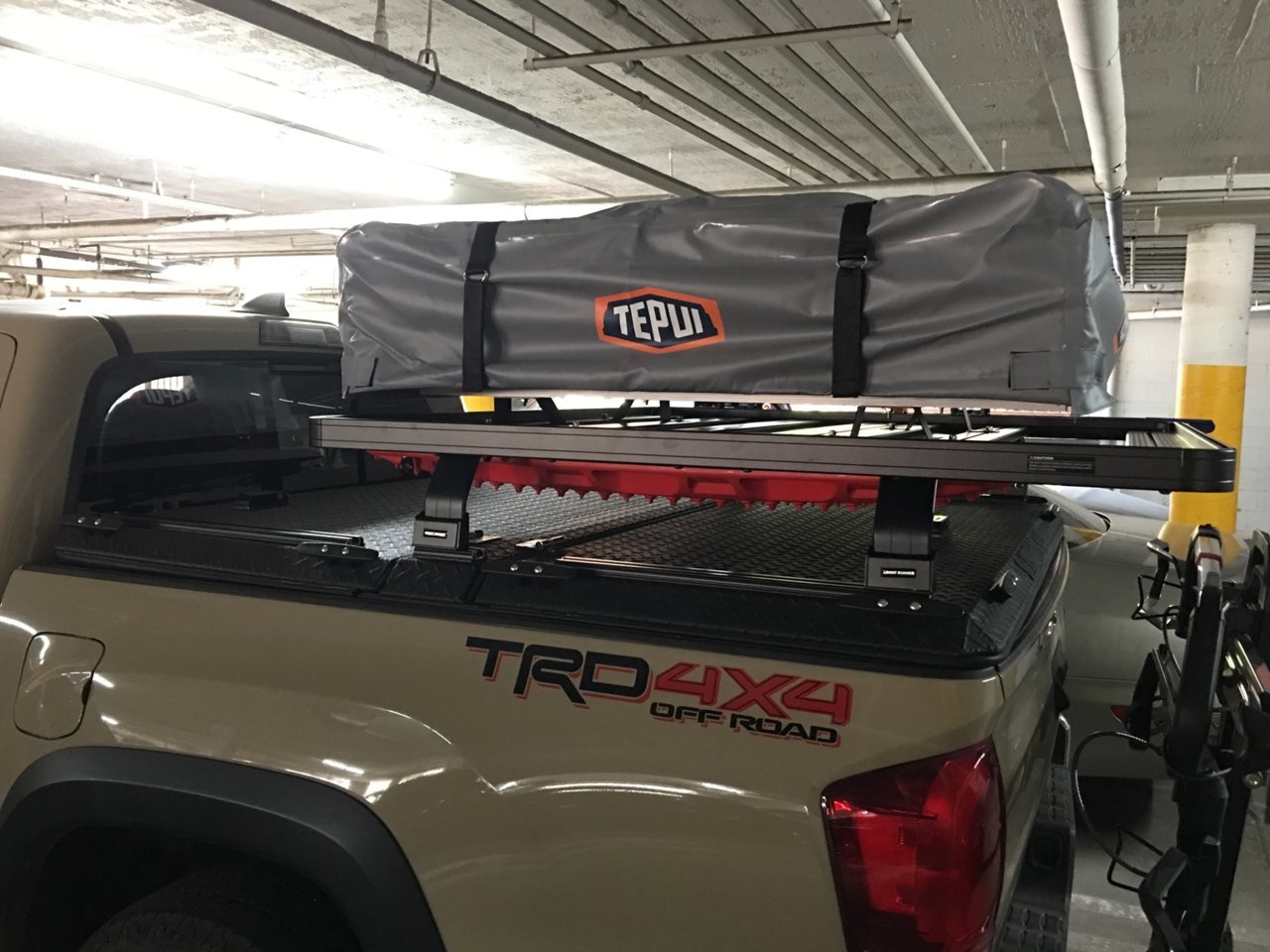

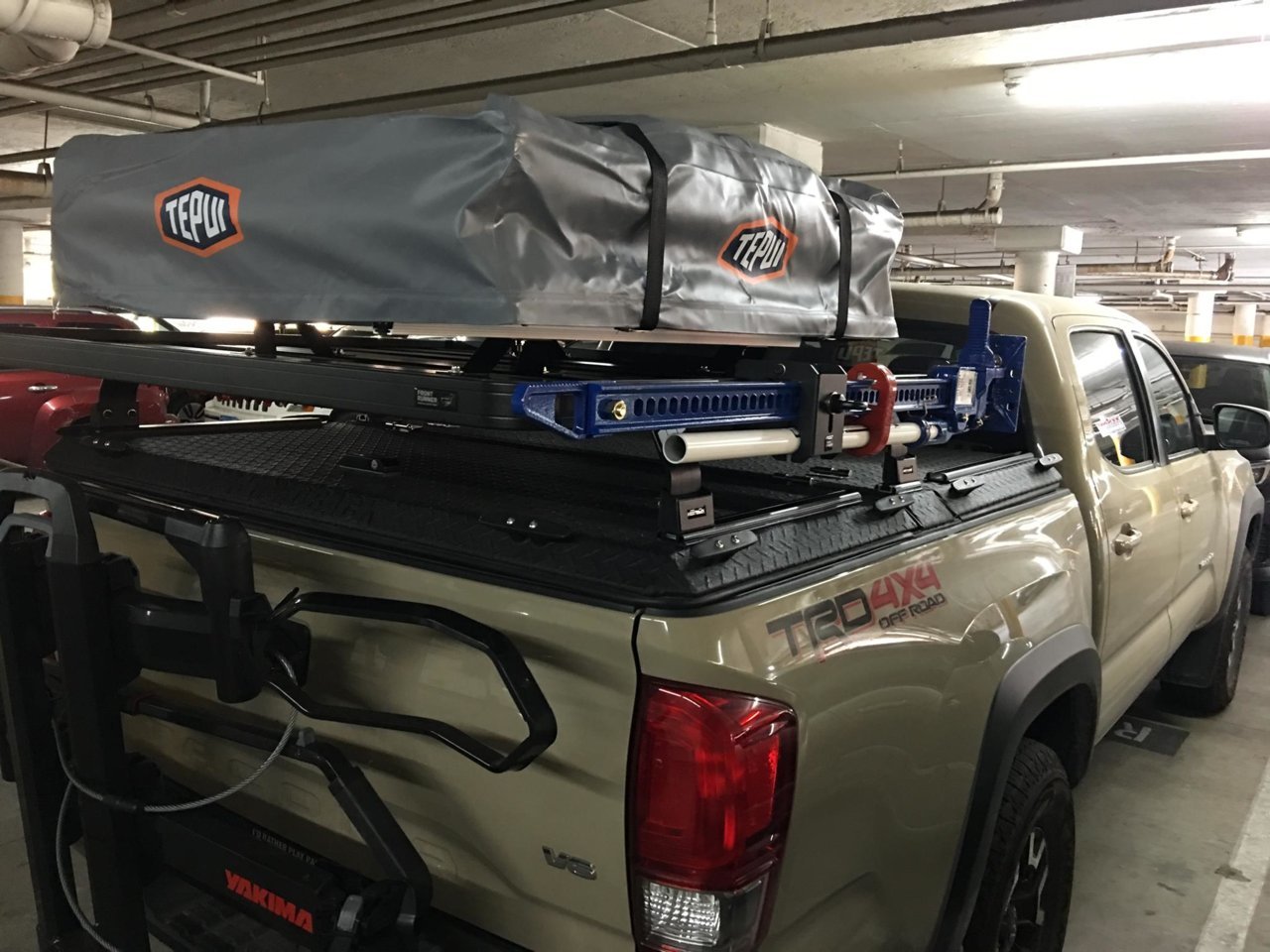

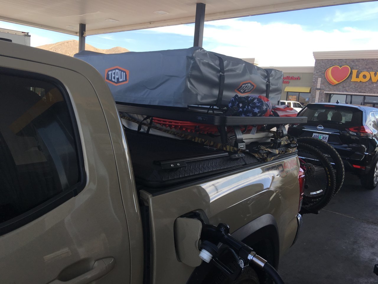

    @n00bco Finally, I found one that works for the cover I already had. This Front Runner bed rack worked well on the DiamondBack HD cover during a recent trip to Utah's Dixie Nat'l Forest/Zion/Bryce Cyn from L.A., CA. It does require some drilling onto the DiamondBack HD cover.

    No drilling.

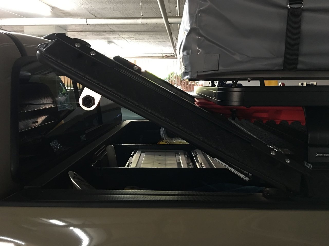

    Being able to open the front cover panel on the DiamondBack cover helped out so much, though. The lighting behind the cab shone directly into the bed, also, when the front cover panel was open. That helped at night while camping in Utah.IMG_3375.jpg

    I'm assuming with this setup, you can't open trifold Tonneaus for usage?
    I'm guessing a soft roll-up tonneau would work better for this kind of setup?

    I was thinking the same thing. The front corners of the bed are exposed near the cab. I was thinking of something mounted there and then another brace on the stationary diamondback center section. Haven't figured out the rear yet. Might need a plate extending rearward a few inches for a third vertical support. Then you could open the front and back.

    Yes and yes.

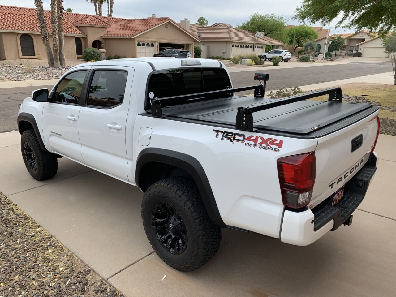

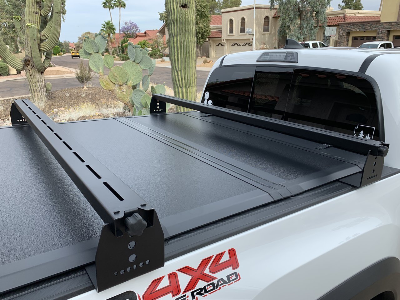

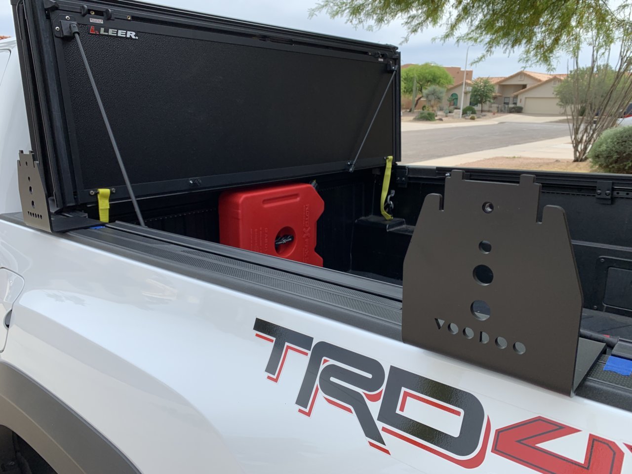

    Just got the KB Voodoo Hi-Rise rack system finished yesterday on my 2018 OR with LEER's new HF350M tri-fold tonneau. I'll be using it exclusively for a RTT, and plan to remove the tent with the KBV crossbars still attached when not in use, leaving just the uprights as permanent fixtures on the truck. The LEER mounts to its own rails that are in turn mounted to the factory rails. I had to cut the LEER rails in two places on each side to accommodate the uprights. I then used some extra LEER clamps (provided to me for free by LEER - thanks!!) to secure the segmented rails. Everything came together nicely, and works great!
