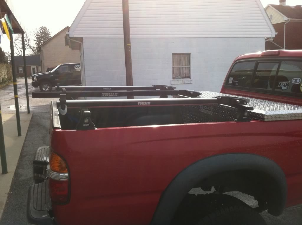

    Just installed this this a.m. Thule TK14 direct mount feet, Tracker II feet, and 65" load bars. The whole set up comes off in less than 5 mins. just unlock and push 4 buttons and its off.
    Gonna buy a LoadWarrior basket to replace the middle tray when we go camping. It's seriously sturdy and doesn't sacrifice the ability to haul big stuff. [​IMG]

    hmmm... nice. Thats kinda what i'm looking for. So the entire thing is stock and meant for the bed? Or was it altered from a roof system?

    The TK14 kit is the feet and they use flare nuts to mount, it is actually meant to mount a roof rack to a metal car roof, mobile home or topper. You just mark your spots, drill the holes and then use the supplied flare tool to seat the anchors. The kit is pretty comprehensive and even includes the bits. Then you need the Tracker feet and load bars of your choice(you will need at least 65", but they do some longer).
    I used the TK14 kit on my old Durango due to the lack of a proper rack to fit on the factory rack. It sealed great and never leaked in three years, so I figured it would work great on the bed rails. You can set them as close or as far apart as you want. Thule makes some good stuff. Let me know if I can answer any other questions.

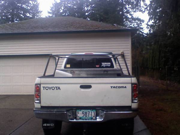

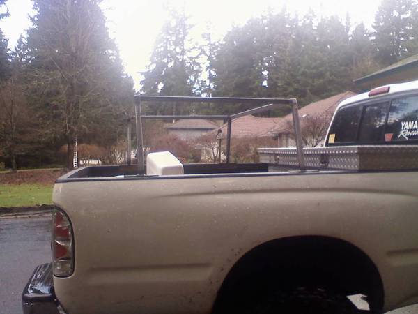

    Here's my setup. Works awesome! WHen not in use the rack itself folds down. I can also just take the entire assembly out OR just pull the pin and remove just the rack and leave the wood in the bed. I really like this setup.

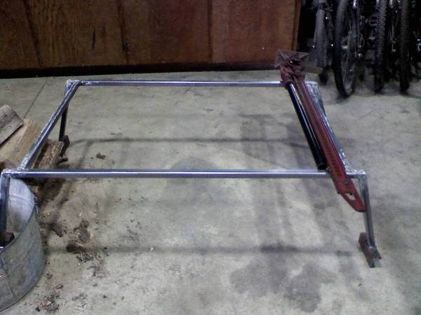

    like so? just built it literally like 2 days ago. its getting painted tomorrow.

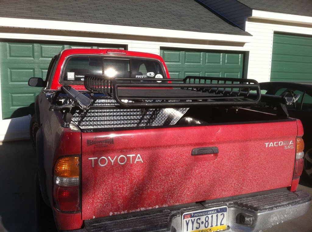

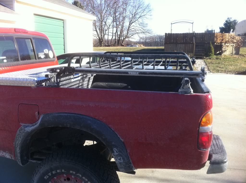

    Got the LoadWarrior and mounted it up.

    Looks great! Do you think that those load bars are capable of holding the car top tent mentioned above:http://www.cartopcamper.com/index_files/Page1309.htm with the addition of two people laying in the tent?? Just wondering, looks like a clean functional set up! Nice Rig!

    They are pretty stout. The bars would hold, I would question of the feet would. I guess since the weight is being spread out that it would be good. Your best bet would be to e-mail Thule and ask them what they think. The bikes are around 27lbs each at the heaviest and I figure I could load the basket up pretty good. I (265lbs)stood on it and gave it the bounce test and it seemed extremely solid.
