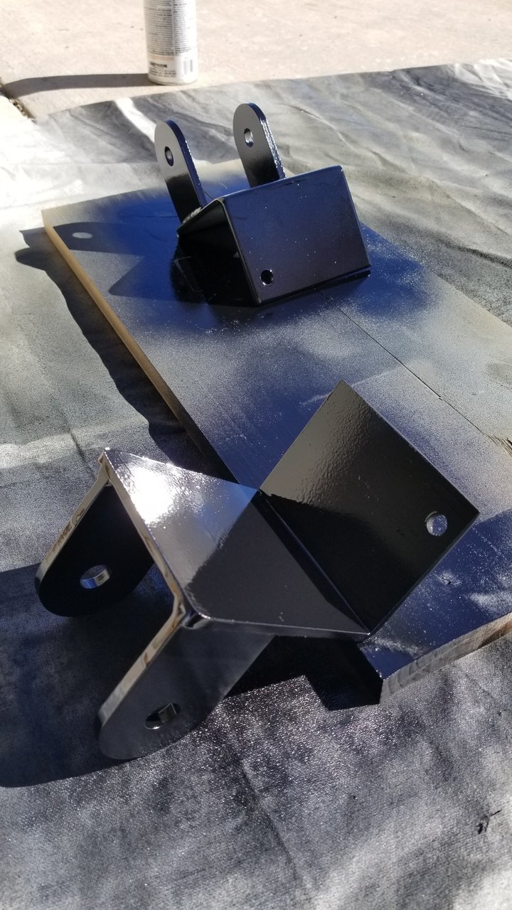

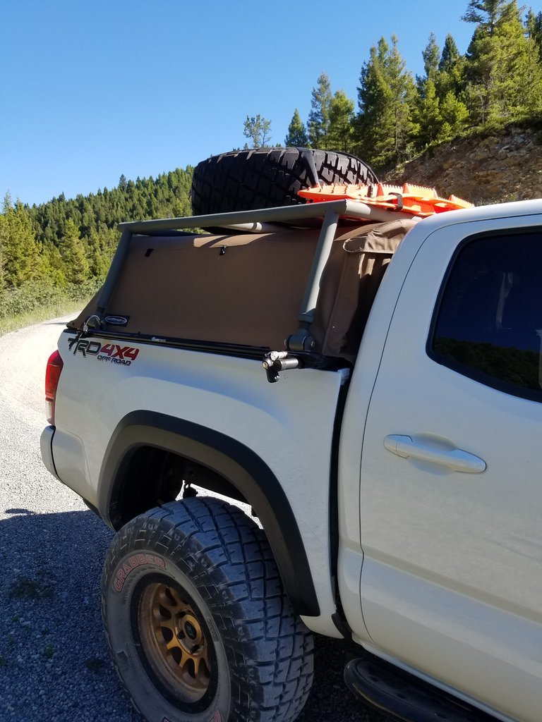

    Here's a few pics

    How is the rack mounted? Looks like its detachable.

    It's mounted to the bed rails and it is detachable

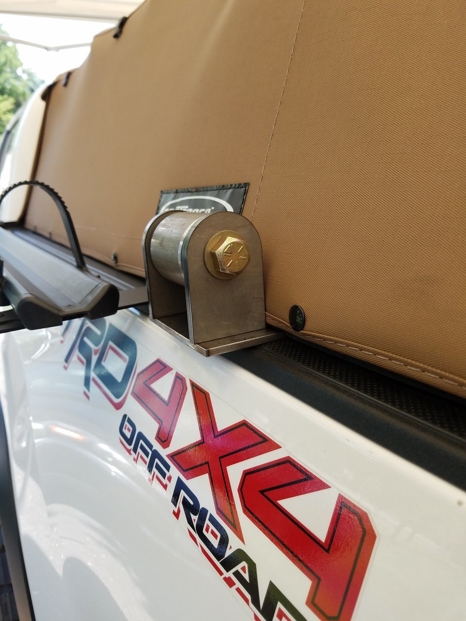

    Do you have close ups of how it's mounted?

    Is it detachable so you can fold up your softopper easily?

    Yes. Remove 2 bolts from either side and it folds over. Or take off all 4 bolts and you can easily remove it

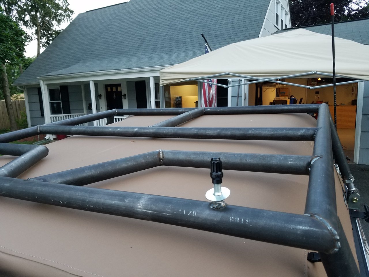

    My buddy has a welderand I've thought about getting some hardware and trying to do it myself. However, the closest I've come to welding is using a soldering gun :bananadance:. Would you happen to have any drawings / plans / materials list that you used for your rack? I get it if you don't want to share.

    You are going to need about 40ft of 1.75 .120 wall DOM tubing, .25 plate 4"x36" for the L brackets, 8 shock mounts at a minimum, 4 bushing ends

    Where did you find your shock mounts and bushing ends? Any chance you could post an up close picture of them?

    I've been looking at the Softopper for my Dakota, but wanted a way to haul kayaks and stuff on top. I came across this post and I absolutely love the idea of being lower profile than a store bought one and the ease of removal. My question is, how heavy is this? I was thinking about using fence post pipe instead for lighter weight because I don't have a need for something as heavy duty as yours and fence post would be A LOT cheaper to build. Any reason I shouldn't go that route?

    I did. It was pretty simple.
    I went to fastenal and they were able to help me out with a right size nut for the tube. They literally have everything.

    Do you happen to know the measurement from the bed rail to the bottom of the rubbing? (Height of it from the bed rail?)

    It was around 4inches. I'm not home to measure it I'm on hawaii for a week so I won't be able to do it. But I'm almost positive it was around 4inches

    Sorry I meant from the bed rail up to the top of the rack where you’d mount a tent. Basically from the bedrail to top bar on the rack
