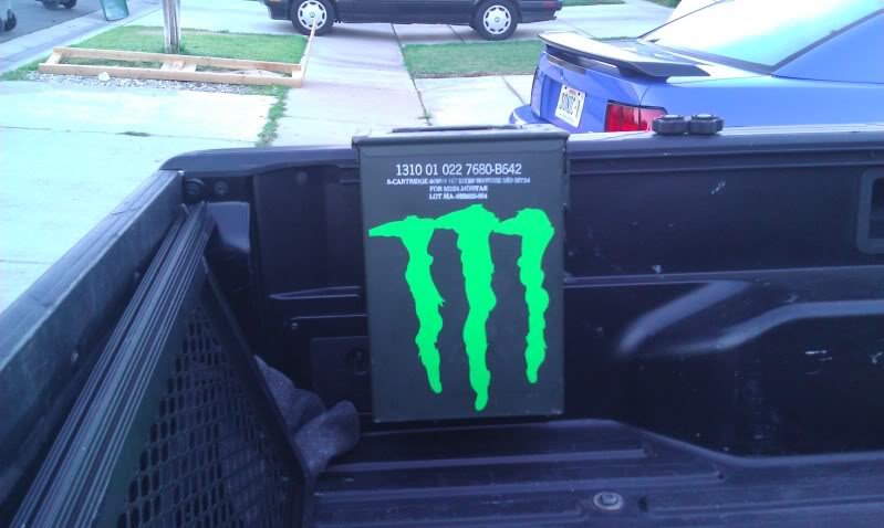

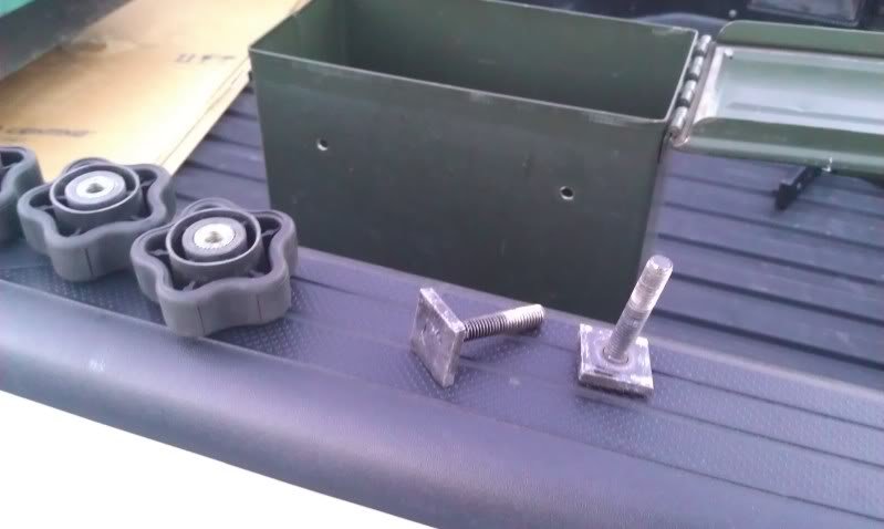

    This got me to create the following how to:
    Get an ammo can of desired size, i got a large one cause i liked the size, but any size will do
    NOTE: Short cans will sit level mounted on the side, tall cans sit crooked cause of the uneven sides. Tall cans sit great along the cab rail.
    Mmmmm M224 Mortar
    Monster sticker extra (dont think i like it)

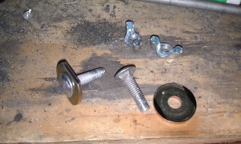

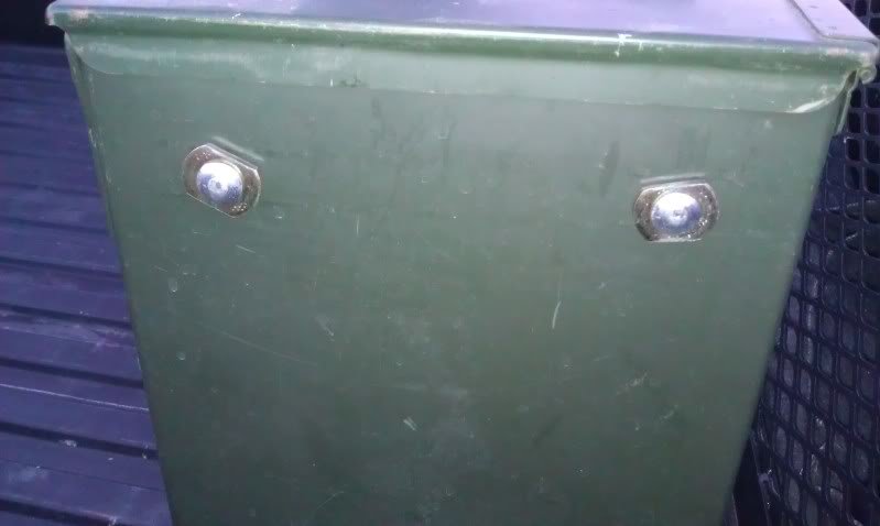

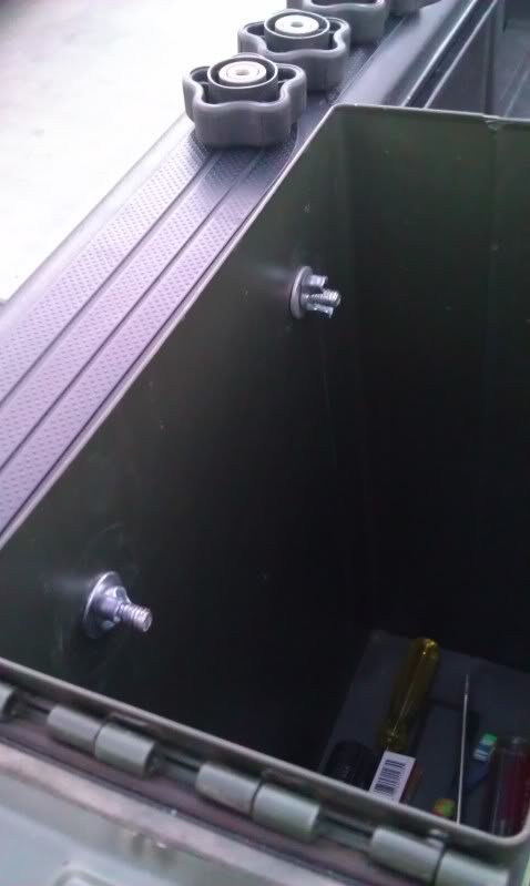

    Drill two... level holes... and there are two mounting options
    Factory square head bolts and spin on "nuts"
    OR
    Make your own, I made these tonight just so i could show you guys/gals
    Its not that hard, took me about 15min, and I had all the hardware...
    Both mounting options fit the same in the truck
    Have Fun! Hope it works out for people.

    Sweet, thanks. Nice job on the hardware

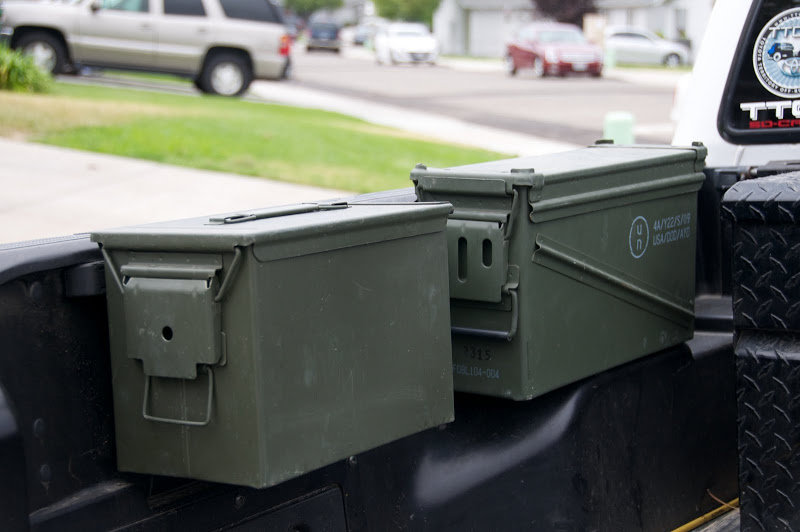

    Here are two I have mounted. Oh and if you guys need ammo cans, I can get any type and size.

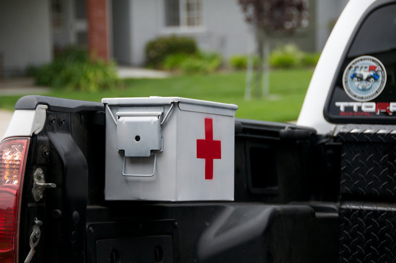

    I decided to clean this up a little this afternoon. It's pretty obvious what this is for. I have had to apply two tourniquets to injured motorcycle riders this past year so putting this on the outside should help for those "just in case" moments.

    nice, im glad there are ppl like you around, thanks for looking out

    I like the first aid ammo can, very cool.
