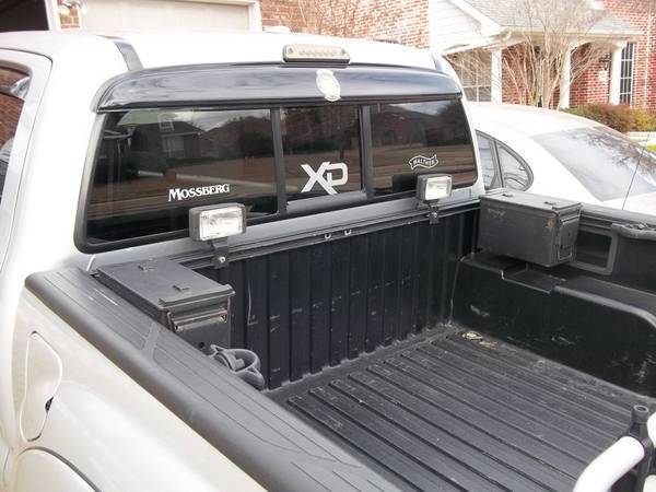

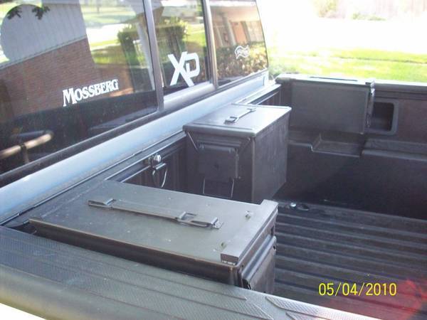

    Just a tip to all those with the ammo can mod. If your like me, and have the ammo cans mounted near the cab/back window, you probably hit the body or back window moulding, when you open the lid. I found that its a good idea to go to Auto Zone and buy some EPDM weather stripping like this, and put a strip across the top of the lid closest to the latch. That way you have some padding when it's opened, and won't scratch the window, body or molding. Here are a couple pics (FYI I have since removed the larger ammo can in the middle, underneath the slide open window.) Also, you can see in the 1st pic, I cut the handles off the lid of the ammo cans because they rattled too much, and theres no need for them anymore with this mod.
