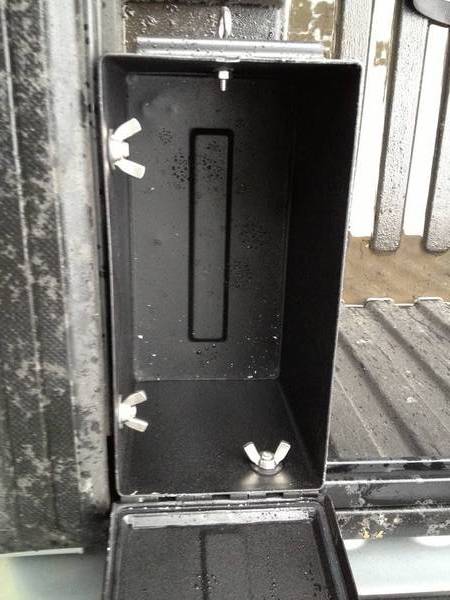

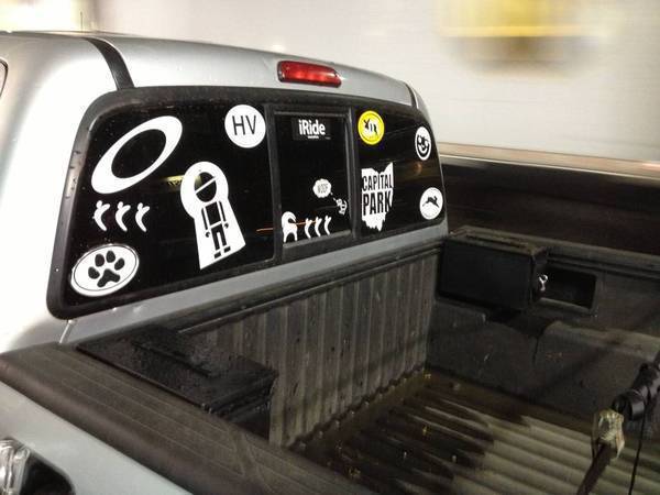

    Finally got around to doing this mod and it was pretty simple. The hardest part was sitting waiting on the paint to dry so I could install them!
    I got the two ammo cans for $20 at my local gun store. I used 3/8 x 1" Hex bolts, Nuts, Rubber Washers, and a 1" flat washer to hold it to the rail system. I also used wing nuts to secure it in case I ever need to take them out for some reason. After I drilled all the holes where I wanted them, I spayed them with a couple layers of Rustoleum spray on bed liner to help from getting dinged up.
    Here's a look at the inside and wing nuts:
    It leaves plenty of space for my tow strap and ratchet straps
    And here's how they sit now:
    So far there's been no leaking through the drilled holes thanks to the rubber washers (I put one on each side of every bolt). I love having the extra weather-proof and lockable storage in the bed!
