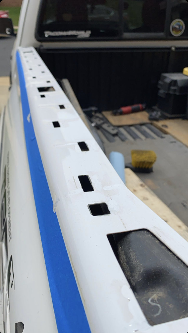

    this is 100% not true. There is nothing structural about the bed rail caps. They are just flimsy plastic that sits on top of the metal bedside.
    when I installed my wedge camper I just removed the bed rail caps and sealed directly to the metal bedside.
    the biggest issue with sealing out water and dust with the bed rail caps installed is that they make the bedsides higher than the front of the bed leaving a large gap at the front that needs to be filled.

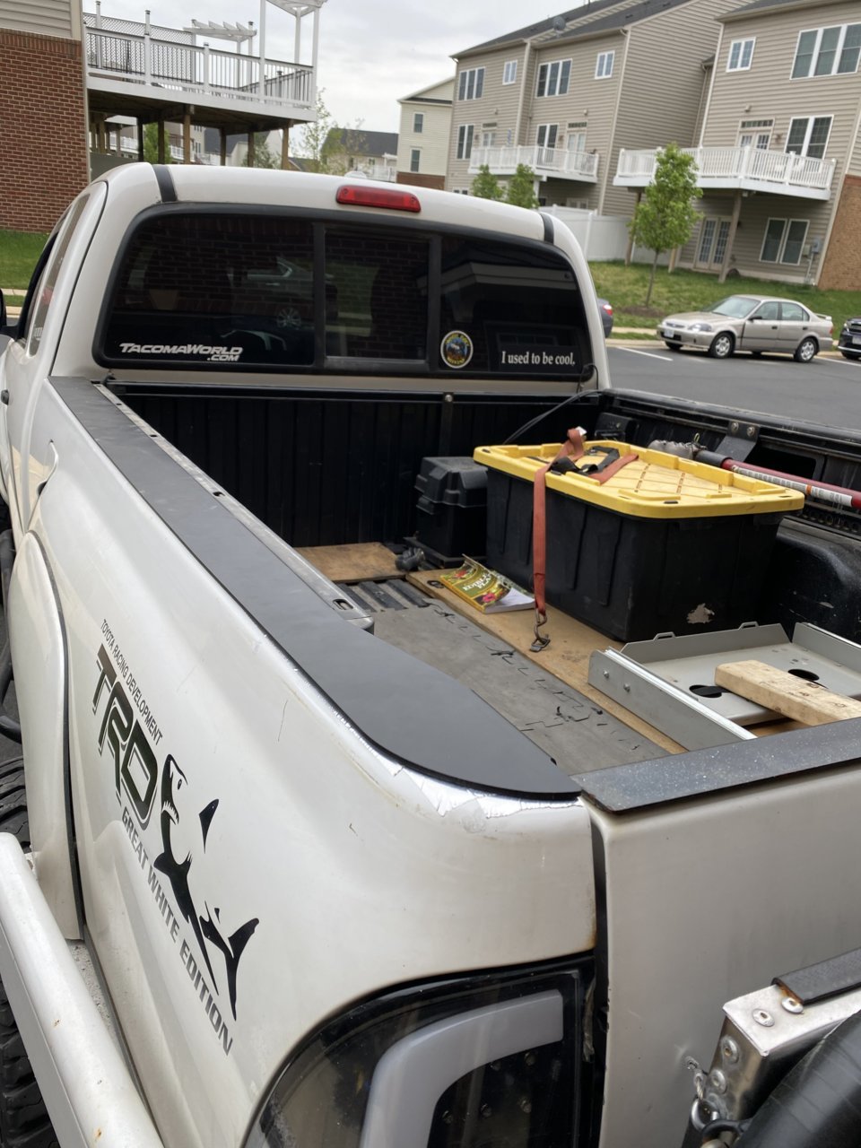

    Definitely get them OP. I put them on before putting on my camper, and they are awesome. KB Voodoo has a discount code for TW members too, if you message them.
    And no, they are not structural at all. If anything just a little stronger than OEM because they're aluminum. 2nd gens bed caps are known to deform under shells of any kind
