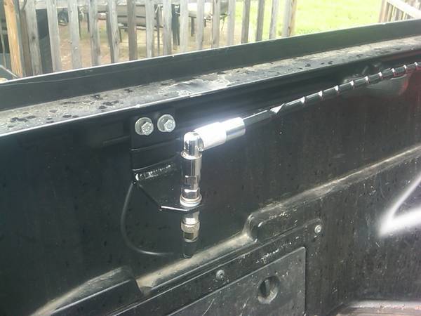

    I'm hoping this is somewhat of an original contribution to TW. I've seen a few threads about antennas being installed on the bed rails using nuts, bolts and rail-sized washers, but I had an idea after installing a Clutch SD bed rail bike mount a couple weeks back.
    So, I decided to go with the Firestik K-24 antenna mount:
    http://www.amazon.com/FireStik-K-24...&qid=1339988847&sr=8-1&keywords=firestik+k-24
    And ordered an extra hardware kit like the one that came with the bike mount:
    http://www.rockymounts.com/truck_bike_racks_SDhardware_p/0141.htm
    Here it all is:
    The hardware fit the mount perfectly:
    Just slid it in the rail and tightened her down. I was debaiting facing the horizontal part of the mount forward or backward, I was somewhat concerned with the antenna bouncing into the back of the truck. After a few high speed runs over the speedbumps in a local parking lot though, I'm happy I put it forward. Looks much cleaner.
    Sorry for the crappy photo:
    Still need to get it all tuned, I'm going to lose the spring when my new antenna comes (this one is off of another vehicle). Overall, I am very pleased with the how it turned out. I tried to align the antenna with the black strip on the roof so it doesn't stick out as much when looking from behind. If anyone has any questions or comments send them my way! :cool:

    With an antenna that close to the cab AND that short, I would imagine the reception is gonna be terrible.. I have a three footer and its at the back of the bad. When your antenna is close to the cab like that, the cab blocks most or your reception. And most guys say your antenna should be 2/3 above your cab or something. Is yours tuned already? Hows your reception?

    I used to have a 3 footer hood mounted on my other truck, went down to a 2' and didn't really notice a diff. Can't say I notice too much difference now between the hood mounted and this setup. I HAVE NOT tuned it yet, SWR meter is sitting in the garage staring at me. I hit my friend about 1.5 miles away the night I installed it, he has a rear door hinge mounted 3 ft on his FJ.
    It's def not the best setup for performance, but I think it's a good compromise between function and fashion. I don't want to look like a redneck, and I need to be able to get into parking garages. At the same time I only ever use it in pretty close range situations with friends, so it works.

    you need to run a grounding strap or else youll never be able to get it tuned properly.

    Gotcha, this looks like a nice install you did. I've been trying to figure out how I could mount up something similar on my new Tacoma. My other Pickup is a '91 Chevy K1500 Silverado, and I just used a bed post hole antenna mount right behind the cab and stuck a 102 steel whip on a spring there. SWR is perfect with that antenna, but it catches on tree limbs and everything else whenever I drive that old truck.
    I didn't mind drilling a small hole in the bed frame for a grounding strap on that truck, but my Tacoma is too new for me to be willing to alter it much. Definitely care more about aesthetics with it, so I'll be following this thread to see what you come up for a grounding solution. Will probably go with a shorter antenna on the Tacoma as well.
    Where did you run the antenna wire into the cab at? Did you find a grommet to feed it through? That's what I did on my Chevy, found a grommet in the floor of the cab and made a small cut in the carpet to run it up under the seat to the Radio installed under the dash. It has a bench seat, but the Tacoma has a center console. I'd be interested to see where you installed the radio at in your cab if you have a picture of that too.

    There's a rubber gromet in the back behind the plastic stuff that is removable.
    As for the grounding strap you can fin a bolt that's not painted and run it to that so you won't need to drill.

    Nice mount not the best place place for it though and don't bother to tune it until you remove the spring.
