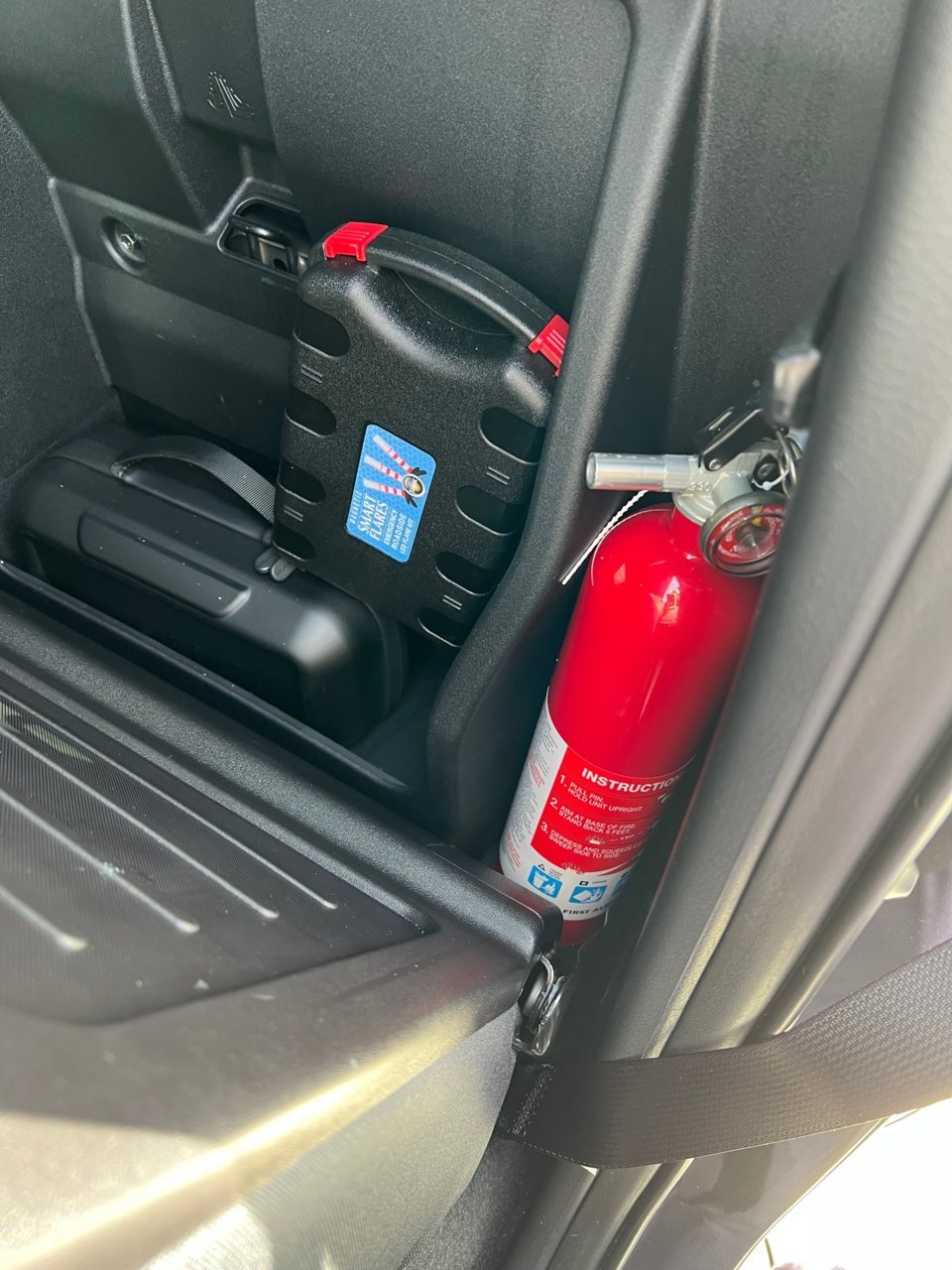

    Those slimmer fire extinguishers actually fit perfectly in the little nook behind the rear seats

    lol, I literally just found this spot in my truck and came inside to post on this thread that it would be a perfect spot for a small extinguisher. Not sure how I’ve spent this much time in the truck and never noticed that gap before :facepalm:

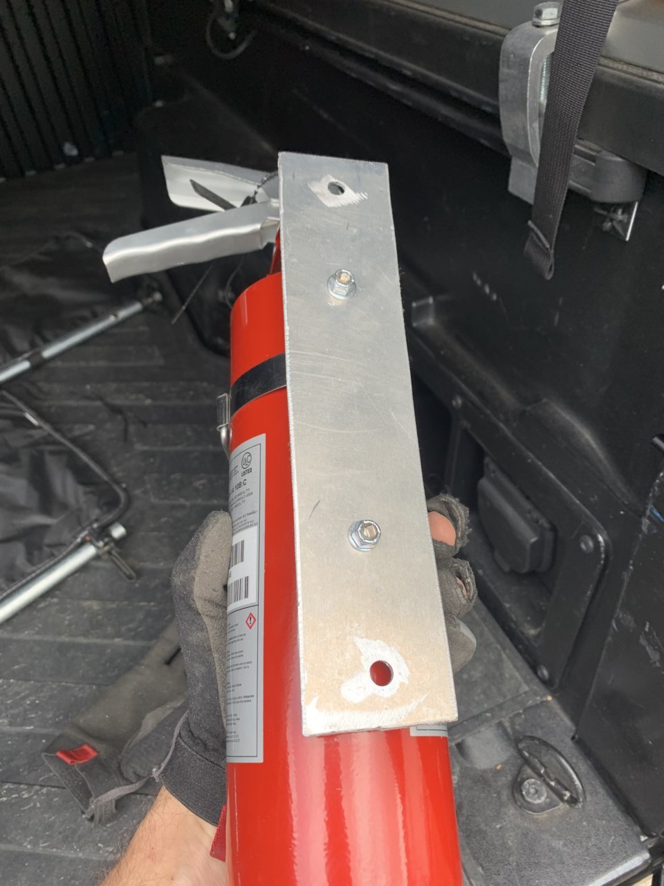

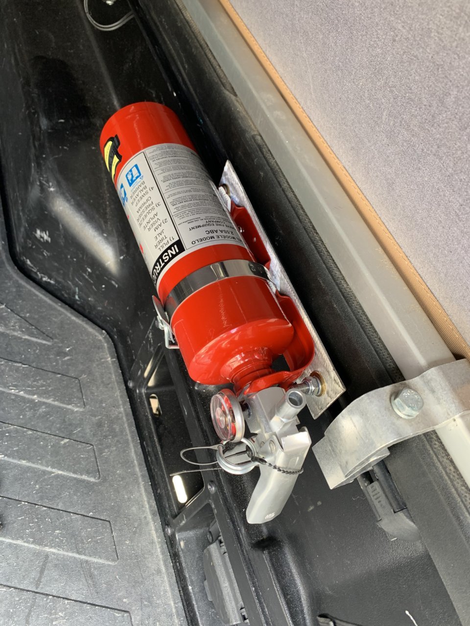

    I took apart the adjustable anchors for the bedrails and used the "T" bolts to make my own bracket with a piece of aluminum.

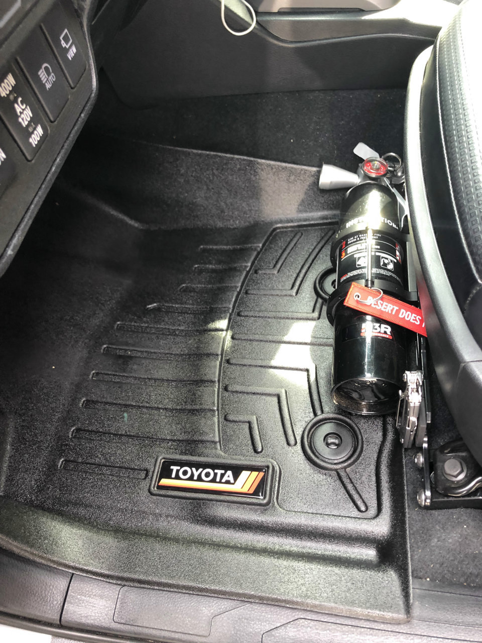

    It's a little pricey but I have been pretty happy with the Desert Does It mount. Once your seat is adjusted forward you hardly know its there, but its fast and easy to release if you need it.
    I have their Fire Extinguisher Mount attached to their Multi Mount Panel with Seat Jackers. I can't speak for the non-electric seats, but on my 2020 with the electric seats its necessary to add the Seat Jackers to make enough space between the seat and the floor mat.
    https://desertdoesit.com/collections/toyota/products/quick-drop-fire-extinguisher-mountIMG_3170.HEIC.jpg

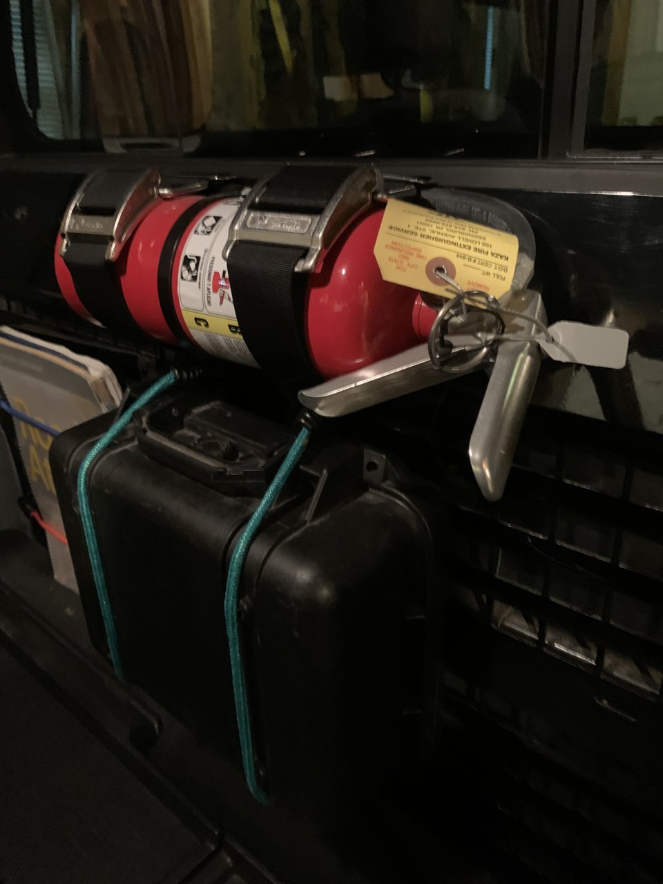

    Unbolt the cubby, drill two holes in the extinguisher mount, rebolt cubby through it;

    This is a solid idea!!!

    This was in my 2nd Gen for 8 years, in the 3rd Gen I just put it behind the backseat - too many kids, and bikes, and dogs, and everything else coming and going in the back of the daily family-mobile, but if it was a dedicated truck it's a great spot.

    Your very right cubby is still easy access
