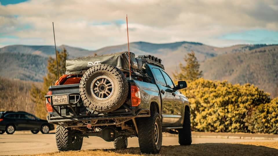

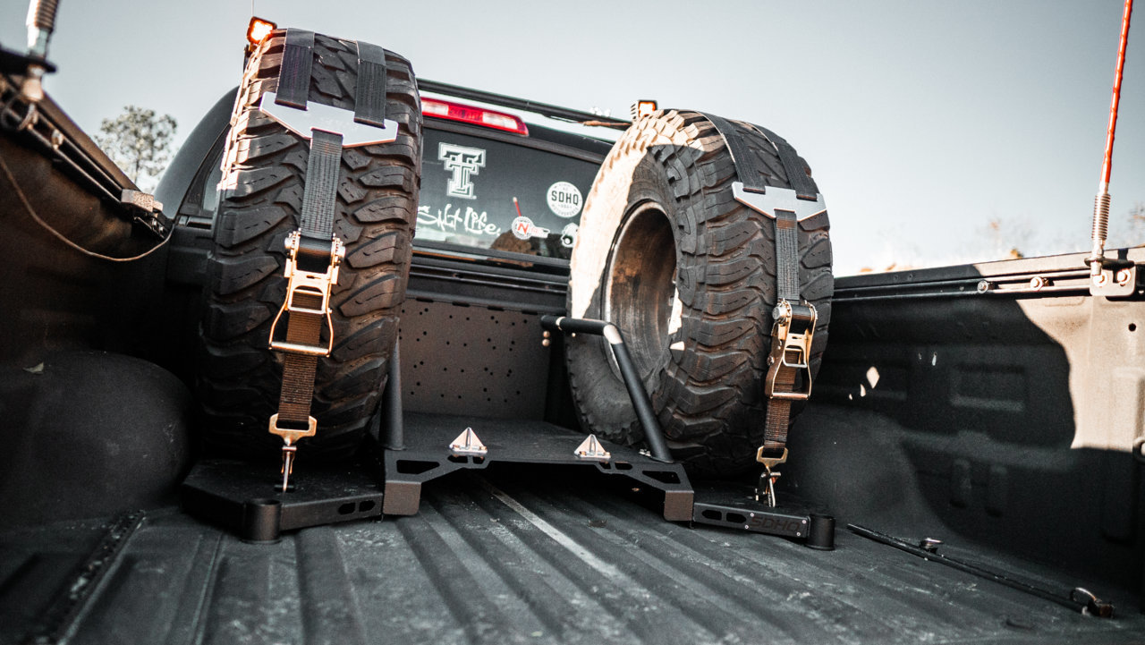

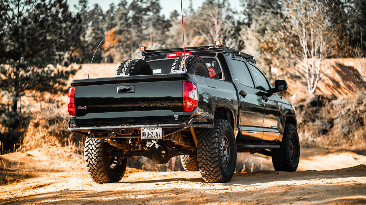

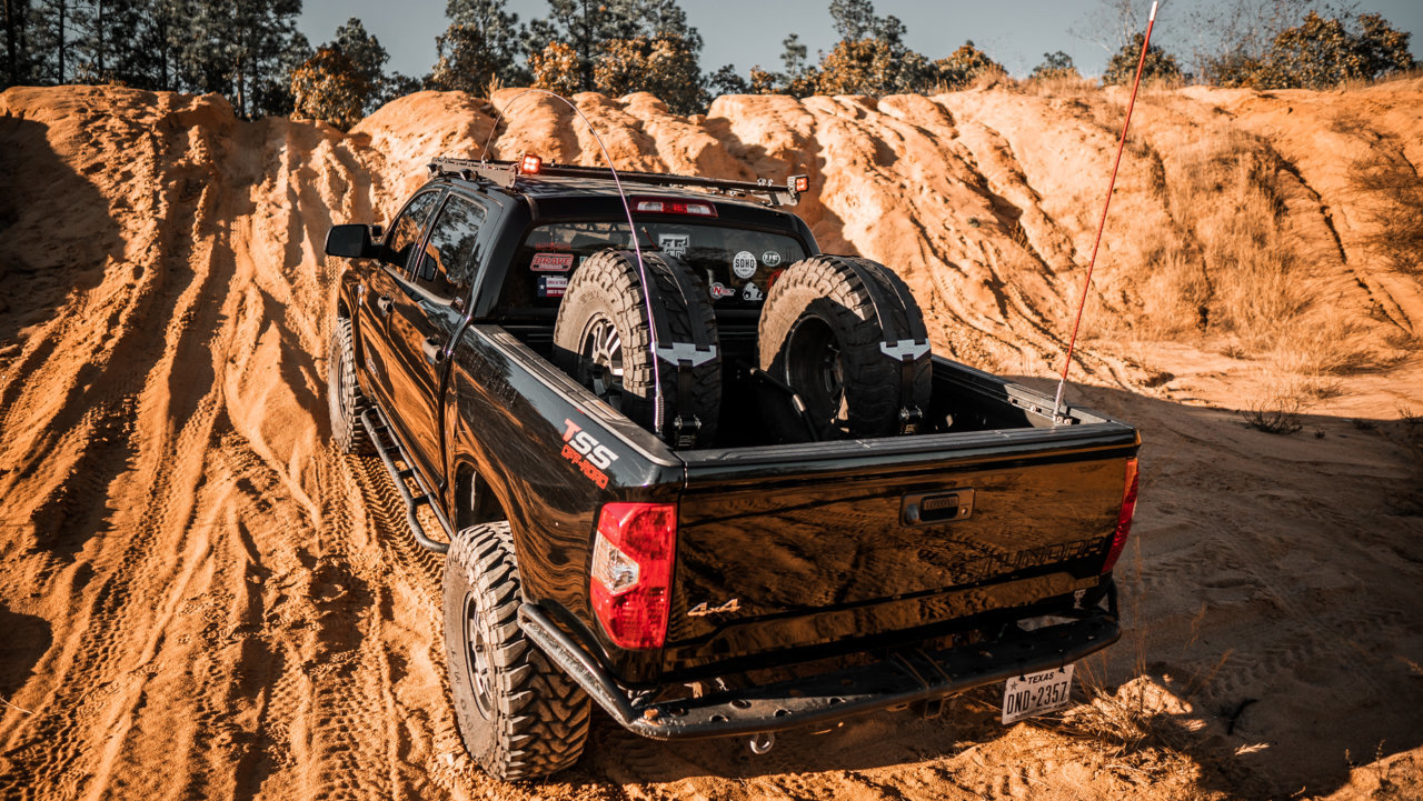

    My brother just installed the SDHQ tire rack for his tundra. Had a custom swing out bumper with 37" MT and kept bottoming out with the roof top tent and loaded bed. He wheels pretty hard so he didn't want the stiff ride upgrading leafs when unloaded so relocated the tire with this set up. The tacoma over axle hang is worse. We have a greater moment arm which sucks for rebound.

    I don't think it was this exact design, but something similar that was contributing to cracked bedsides. Too much torsional stress on the side-rails. https://www.tacomaworld.com/threads/a-warning-about-bed-rail-tire-carriers.285889/
    Just beware if you do go this route. Look into fortifying the mount with an addtl. brace that can tie-in to the bed (floor) itself and prevent any up/down movement.

    The SDHQ one is a full rack though. Not just a little "tub." Laying the tire in the bed works, but takes up just as much if not more space than standing it vertical.

    that sdhq one is bad ass

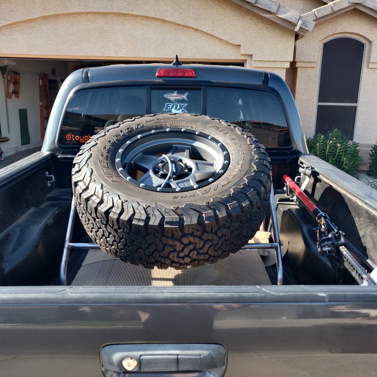

    I've currently got this set up. Not practical by any means but it looks cool. Prolly gonna get rid of it and come up with something else eventually. Too hot here in PHX to do anything right now.

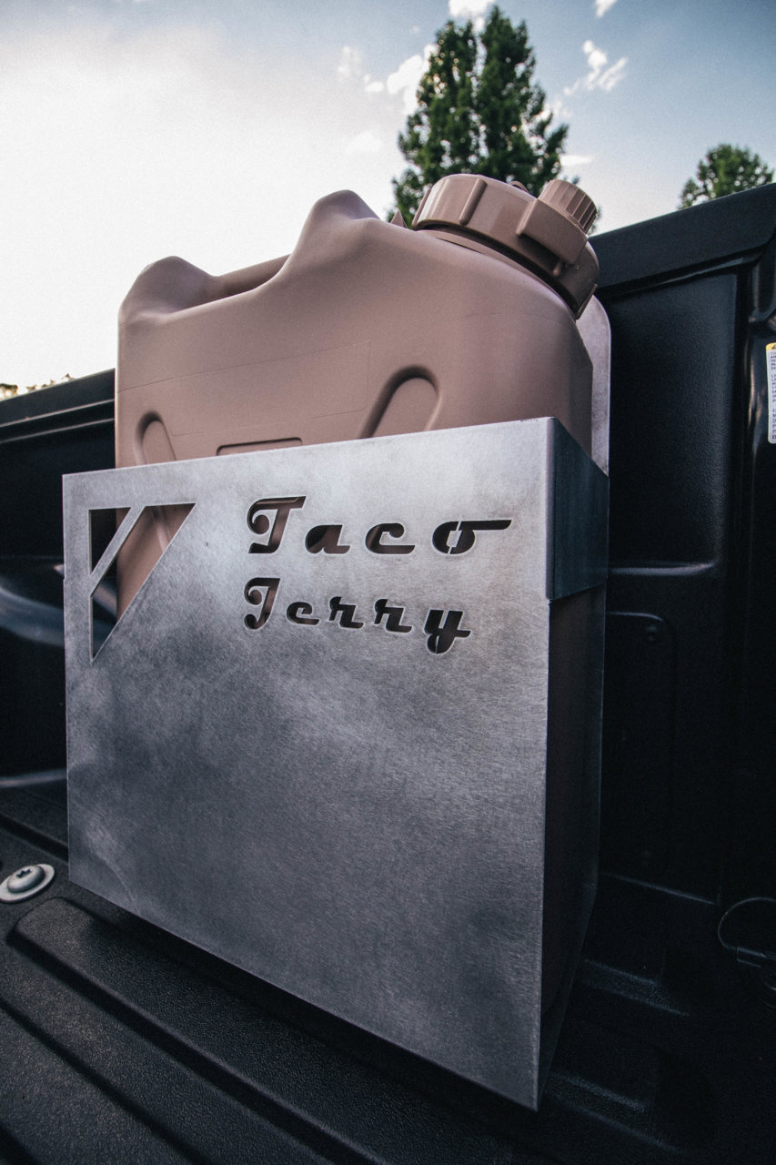

    I love that Jerry Can set up! I grabbed something similar from www.tacojerry.com. Check it out. Here's a pic of mine.
