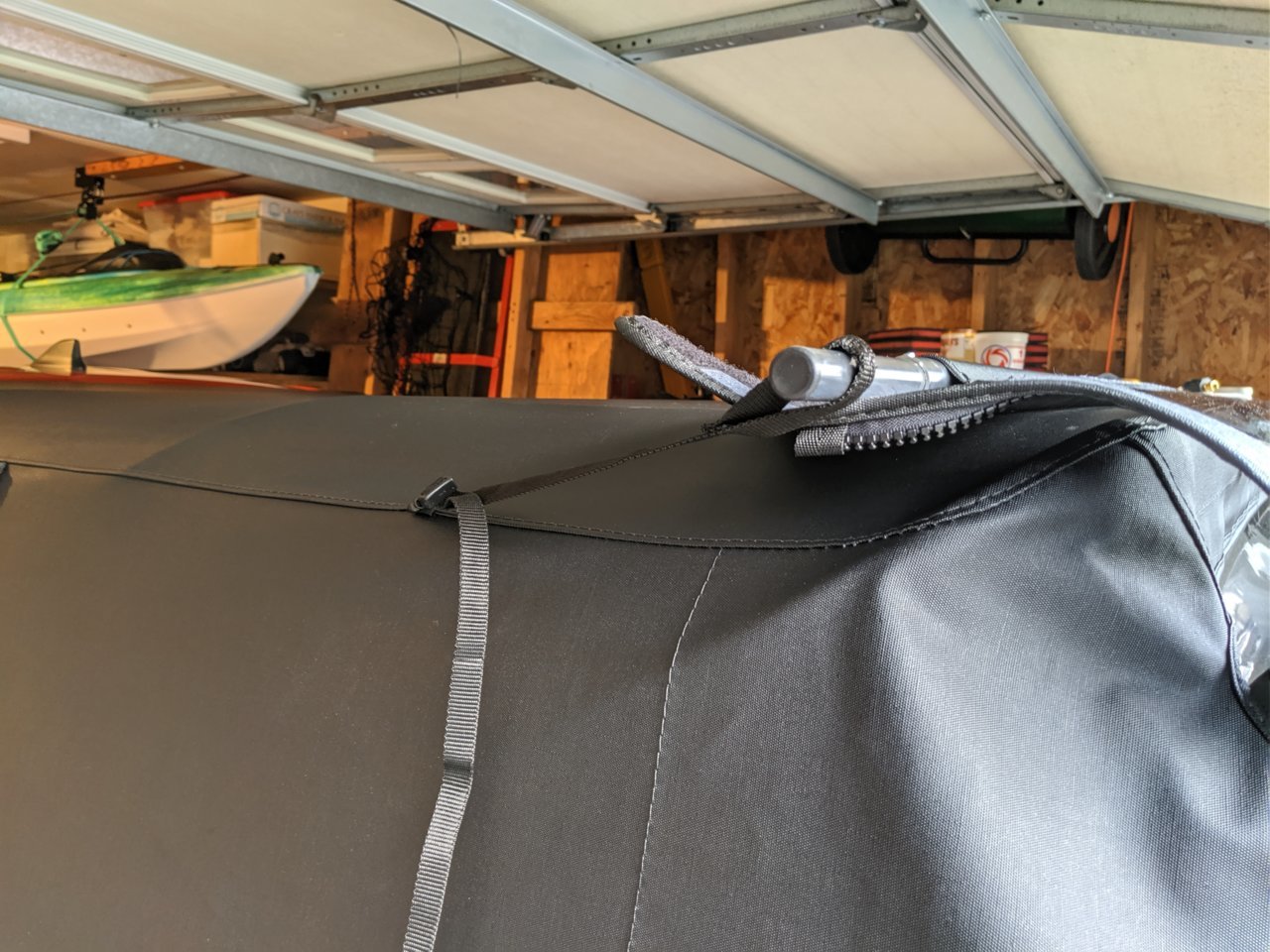

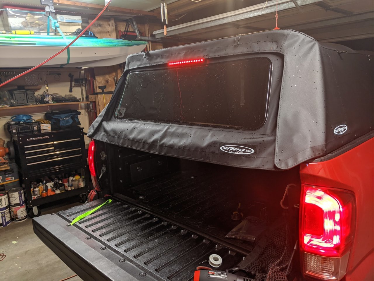

    I found paint wear just from me jumping over the side, so I put down heavy foil tape before the silicone.

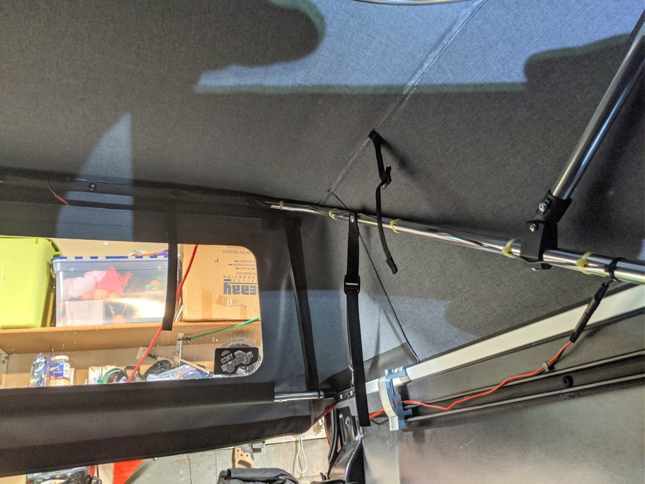

    I just noticed u made some straps to hold the back window open :eek: I need to do something like that

    I did, but almost never use them. Only in high winds.

    Mine gets stiff when it’s cool out and always wants to shut on its own. I need to build some I think
