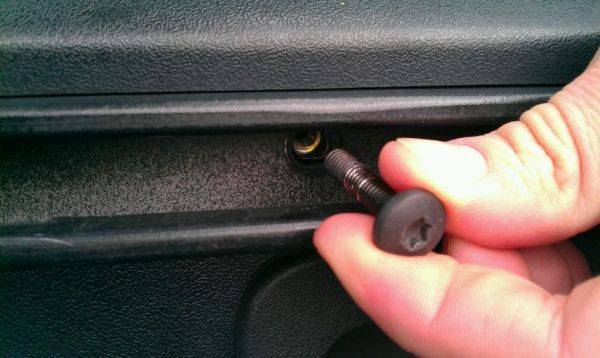

    im looking to find out the exact size of the bed rail/track screws if anyone knows? i know its takes a T30 and that there is a total of i think 8. any help would be awesome thanks.

    1" M6 torx head

    Looks like it was answered years ago, but to be specific, they are M6 x 1.0 Torx-drive button head cap screws. Both 20mm or 25mm length will work.
    I replaced all mine with stainless ones when I lined my bed.
