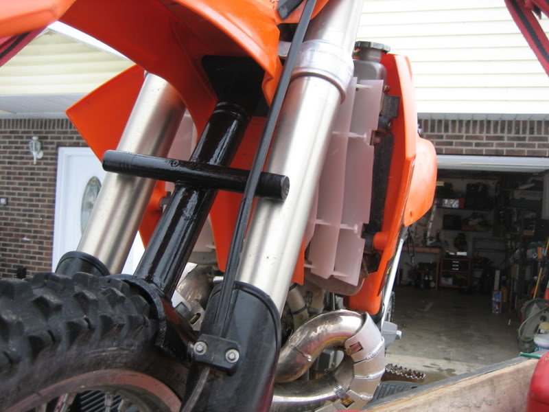

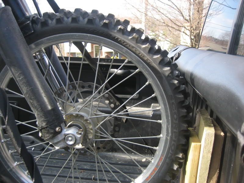

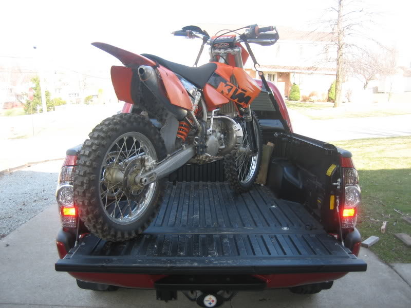

    I loaded up yesterday to try various techniques. With an Access Roll-up tonneau, I have to give up the first 3" to clear the cover. In this test run, I used some scrap wood. I will fab something more permanent later - maybe a 4x6 cut right.
    Anyway, I strapped it down to the additional D-rings I added to the existing bed bolts. I may also add D-rings to a section of the wheel well. These would be used when loading 2 bikes because it provides wider anchor points.
    I also loaded diagonally and used a cleat on the right side. I am adding middle tie down points that would be used in this situation.IMG_5067_85c418a989e7ac69eb3847264d11a66b8d30e746.jpg
    A final suggestion is to run a bungee cord from the 2 front tie down points. As long as you have tension on the strap hooks, they will not release when given slack. You could also exchange the hooks for carabiner that cannot come loose.
    You can see the bungee going up and over the front tire in this picture:
