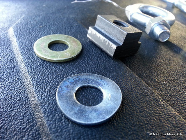

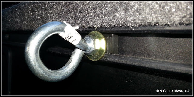

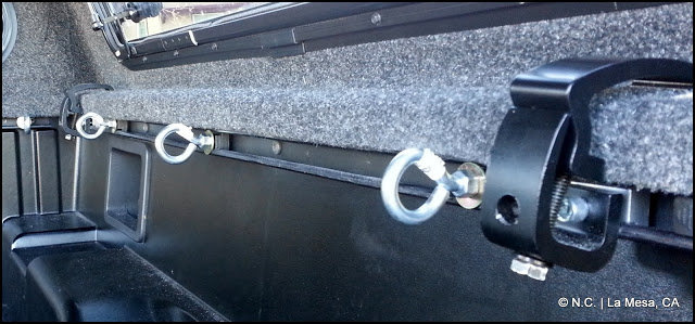

    I've got a comment and a question for those of you that used the Grizzly t-slot nuts.
    I bought eight of them, found some grade-8 washers and 3/8-16 eye bolts at home chepo. They work great together and I thought it was the perfect solution. However, if I place the t-slot nuts in the cut outs of the bed rails they will rattle when torqued down. The problem is the t-slot nut face makes contact with the washer before all the slack is taken up between the washer and the bed rail. Therefore, although secure (t-nut can't escape cutout), it will rattle a little bit and I f'ing hate rattle noises. I can only think of two solutions, 1.) machine or grind the t-slot nut face down a little bit or 2.) move the t-slot nuts out of the bed rail cut outs and torque the eye bolts down.
    I opted for #2. and it seems to be pretty secure, although I'd really like to place them back into the cutouts if I can solve the rattle problem without too much work. I'm wondering what others have done or what others peoples experience with these things are.
    This thread is rich in dialog, but poor on pictures so here are some pictures I can share.
    Thanks for any help anyone can provide.
    sawx75 likes this.

    Possibly a rubber O ring behind the washer?

    Crom, if you wanted to take the trouble to package them up, I would be more than happy to buzz some material off on my mill for you.

    Thanks I'll see if I can do that since it's the easiest thing to do. :)
    Thanks for the offer. I'll PM you if I decide to do that. :)
