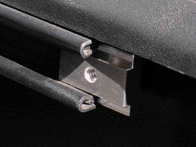

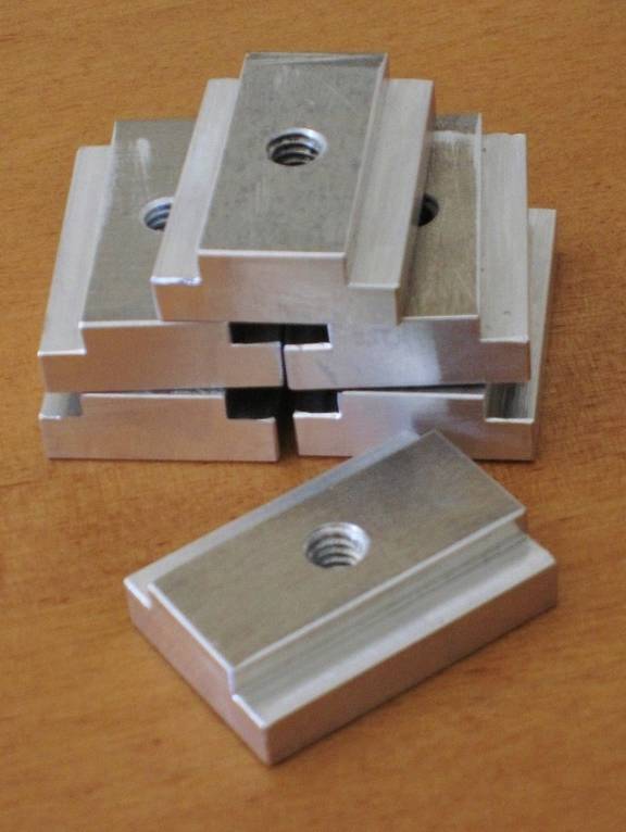

    I have made plenty of these, even a few custom length ones with multiple holes, spaced to what ever you need. Drilled and tapped to whatever size bolt you want.
    The nice thing is that because its aluminum, it wont rust or damage your rail.
