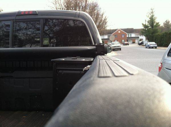

    When I mounted my cans :D there, they shook a lot and I was afraid that they would brake off.

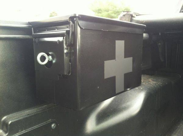

    Yes
    That's why I used the rubber hose washers for some cushion. They have been fine there for almost a year and a half.

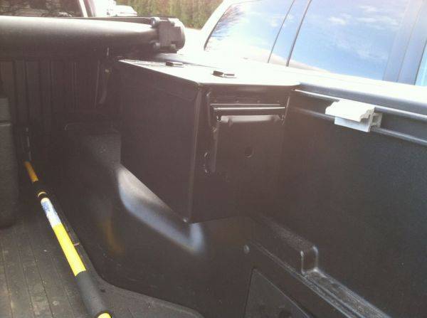

    TRD Supercharger + too much stuff to list. Click sig pic
    Mine are up in the front corners and anchored by two bolts on the side and then one up front and are rock solid.

    19,326
    I actually tried these and they are just a bit to short when it comes to the flat part.
    Socalduckslayer had some stuff laying around that he sent to me. I had to make it work but it works great now.

    Yes
    I made some hardware out of 5/8 inch lag bolts. I just cut a bit of material off the bolt head and they worked great!
