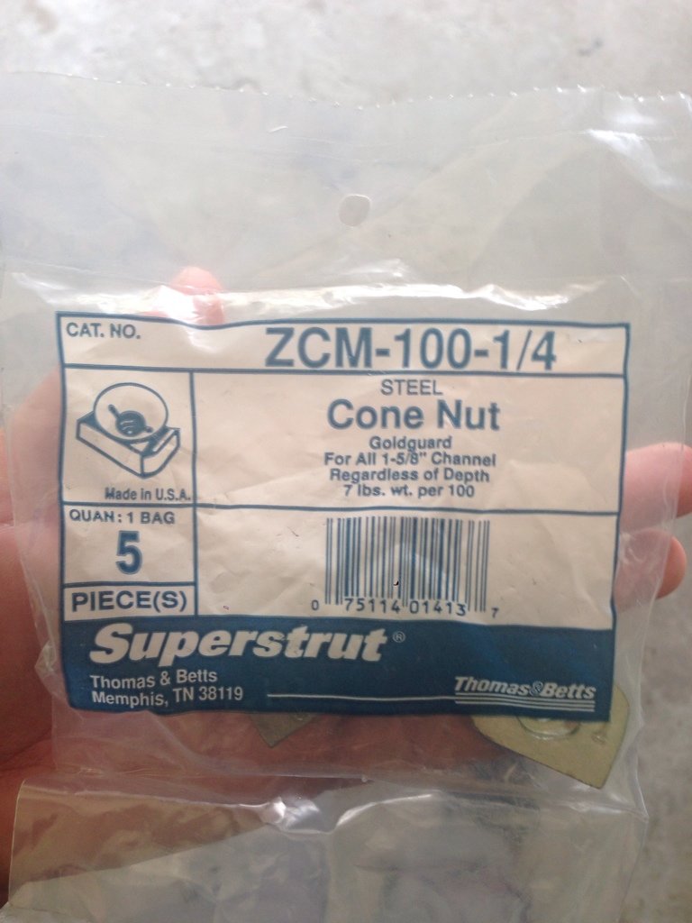

    If anyone is interested, I just received these today. Perfect fit! Now to get the 1/2"~13 bolts to go in them.

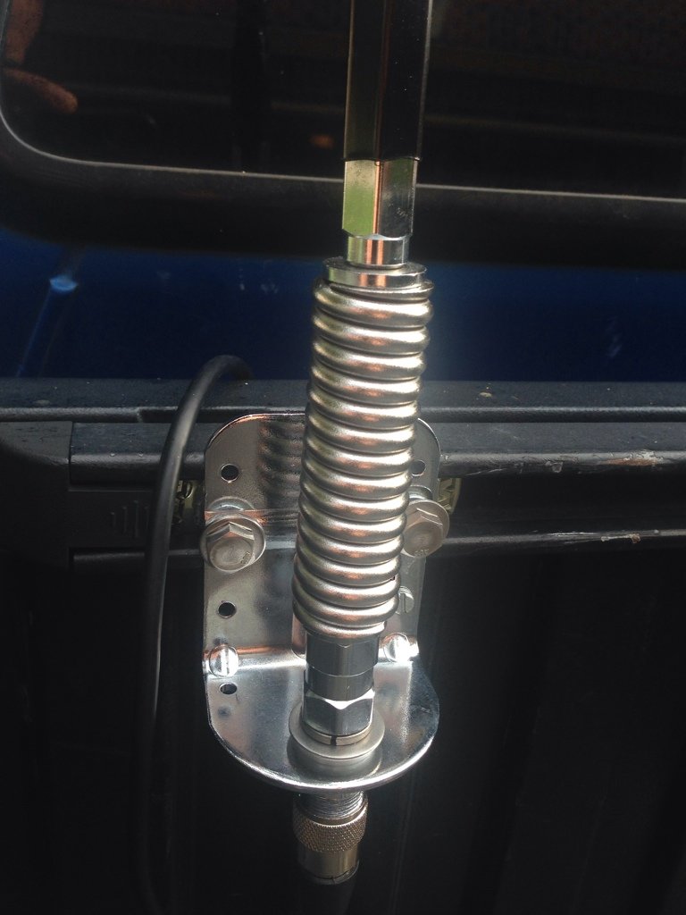

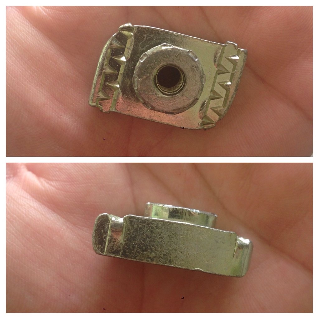

    I found the perfect ones at Home Depot. At my store they were located on isle 3 - Electrical. The cones come right off and after that it's pretty much a perfect fit.
    I hope this helps someone
    Used them to mount my CB antenna

    I have those and they I wouldn't say the fit is perfect as they try to turn sideways inside the track. They will due but I wouldn't suggest them as the best option.

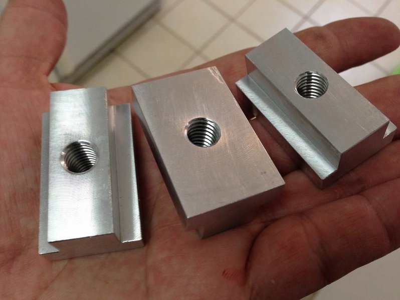

    Just made a bunch of these. Extra beefy! :D
    They barely fit into the rail because I made them as thick as possible. They are 1 5/8" long.
    5056 aluminum tapped for 3/8-16

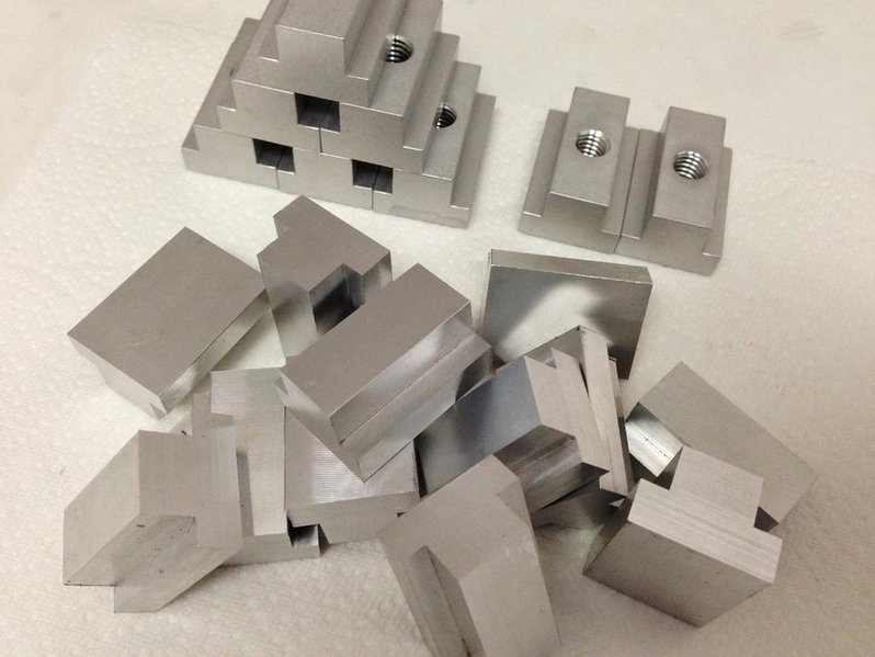

    Got bored and made a bunch more.
    The nice part of aluminum slot nuts is that they wont rust and wont damage the bed rails ;)
    Really beefy. Any bigger and they wouldn't fit...
