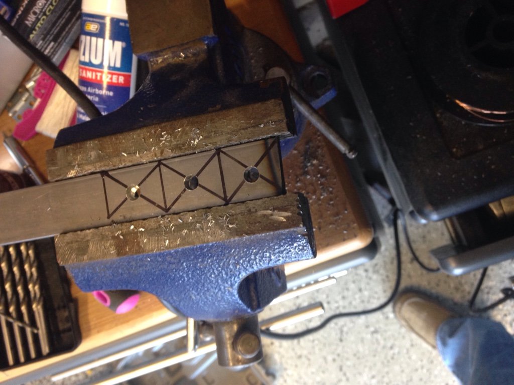

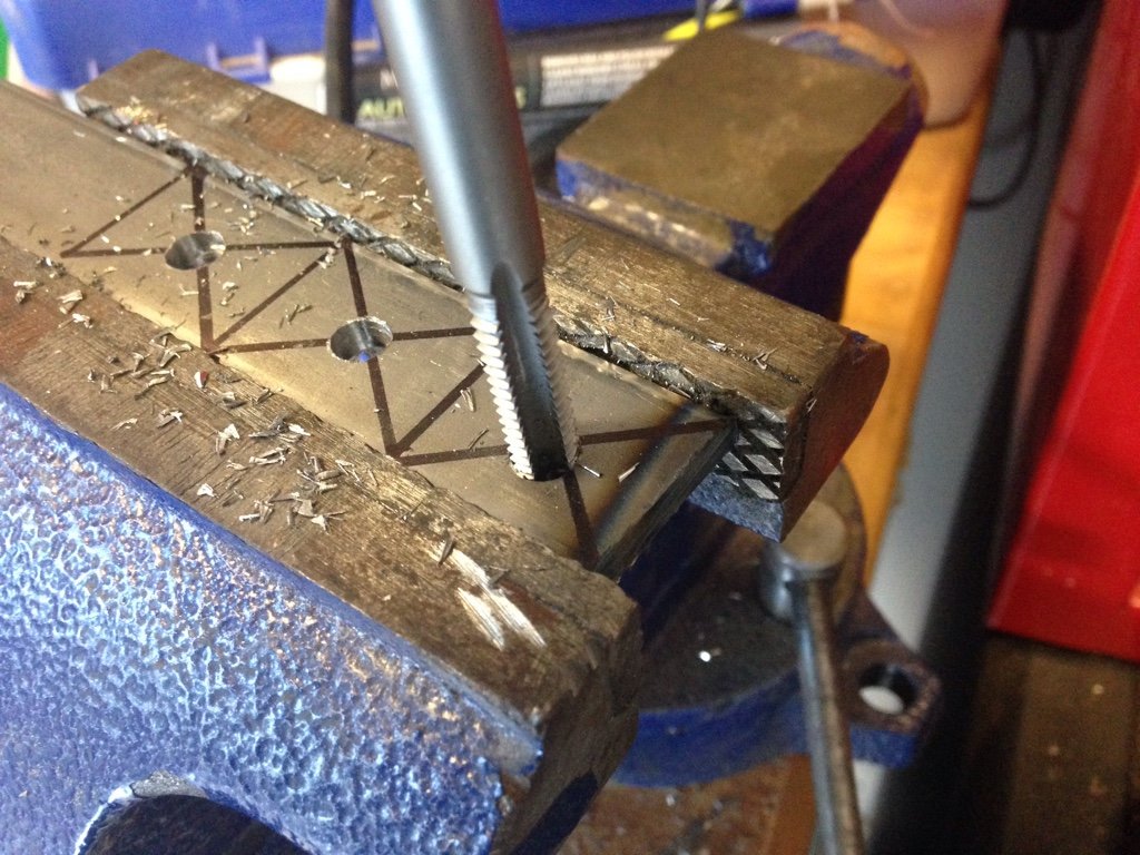

    Just made these up, not as pretty and perfect as the aluminum ones but they work
    1"x 3/16" metal stock from Lowes comes in about 3-4' lengths the stock slides in the rail perfect.
    Drill and tap to your preferred size. Took me about 20 minutes for 4.
    Less than 20 bucks for metal, tap and drill bit and bolts. I could probably make 20 of them.

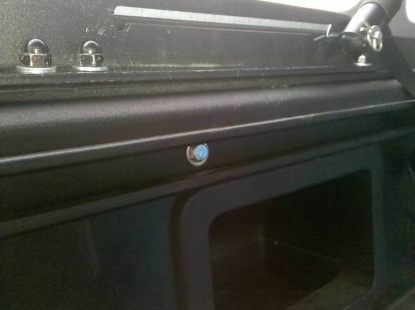

    Just an FYI, this came from another thread I made but I thought this is an appropriate place for this

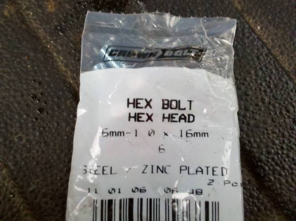

    ok so if youre like me, perhaps you might have stripped your (or a friends) torx bit bed rail bolts, you know the ones that hold the rail against the bed (sorry no pic). well there is a solution! instead of going to the dealer and getting another strippable bolt (not even sure the cost, but probably more expensive) you can go to home depot and get a replacement hex bolt like this:
    its a 6mm x 1.0 x 16 mm.
    also you can bring your stripped bolt with you to test fit to be sure but these are long enough for STOCK applications. if you are putting anything behind the bed rails, such as certain tonneaus require, you'll need a longer bolt.
    in place on the rails, unpainted:
    apologies if this is either old news or useless, but i figured i needed it, so someone else might. hopefully this is the right section lol

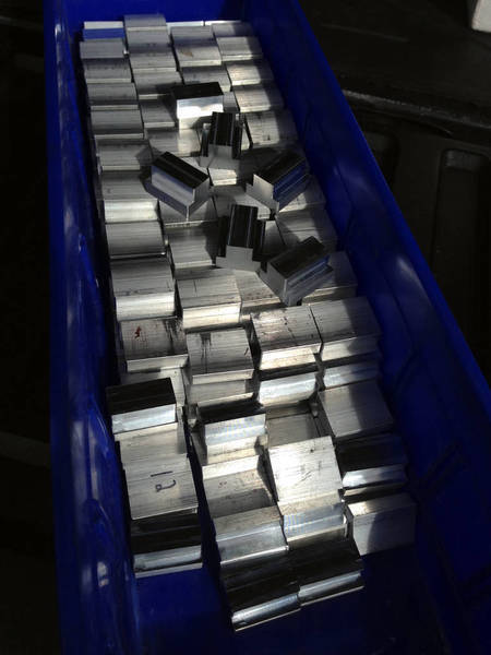

    Just posting here for those that were interested. Got a bunch ready to be stonewashed and tapped for whatever size you need. Link to my thread in my sig :)

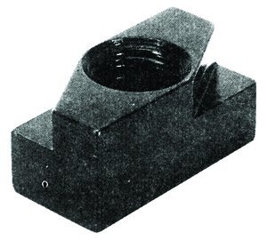

    If you want a nut that you can put in the track, without sliding it in, this is the solution:
    https://www.fastenal.com/web/products/details/0303195
    The nut is 5/8" deep, but the threads stop short of the bottom. A 1/2"-13 tap will fix that, if you need full thread engagement.
    This nut can be pushed into the track at any open spot. Due to minor irregularities in the nut/track, it can either easily push in, or require you to use a bolt to push it in. The nuts don't slide down the track easily though. Tightening the bolt locks it into the rail.
