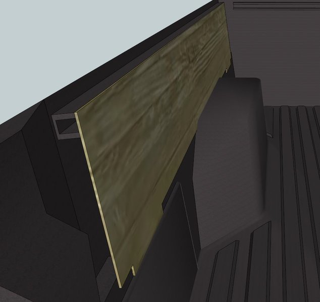

    Actually I am interested in the space between the bed and the fender and whether there is anything between. I want to install a board on each side on which I will put quick fist and other brackets to hold shovels, axes, extinguisers, camping tables and chairs and whatever else.
    I don't want it to be screwed only at the top, I want the bottom to be bolted too.
