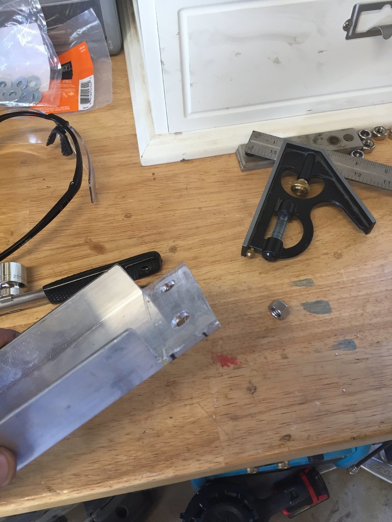

    It may not be pretty but here's my cheaper approach using unistrut hardware.
    Used some 3x1 aluminum channel and uni strut hardware to make some bedside mounts. I cut some longer ones for the back of bed to mount my max traxs and a few 2x12 boards. I used some shorter ones for the sides and mounted quick fist for a few other items. All material purchased locally, nothing fancey.

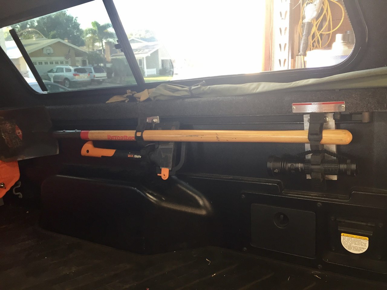

    I thought it better to revive this thread vs start a new one based on the similarity of the project.
    Has anyone tried mounting anything like this to a bed rail using the T nuts? I'd like to drop them down a few inches so my tri-fold cover can close when not in use. My only concern is the bottom flopping around. Is there some way to securely drill into my plastic bed to firm up the bottom?

    There is a thread somewhere. The OP used a Rotopax Tacoma bed mount. Hard to find and not cheep. Should be easy to do with some flat aluminum/steel and the t-slot setup.
    Found it!
    https://www.tacomaworld.com/threads/diy-fishing-rod-holder-using-rotopax-mount.272155/
