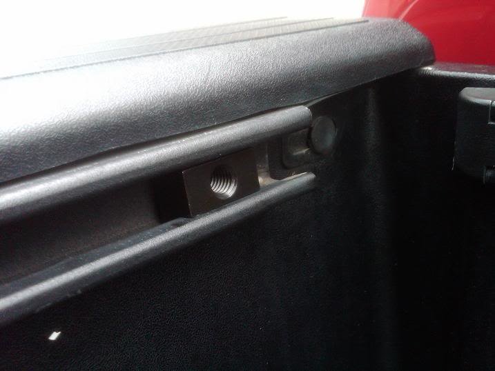

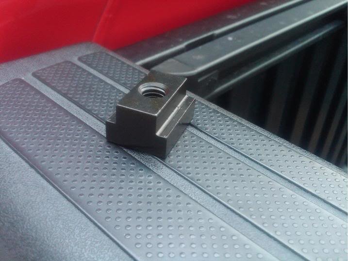

    I just got the T-nuts from my local Fastenal shop- (had be be shipped to them, and there were only a few in stock across the country he said)
    They fit good, and the many potential uses these will offer... I can't wait to find my first use for them. :)

    I believe right off the bat you could install a "Quick Fist" to any T-slot nut, by drilling out the mounting hole of the quick fist to fit the 3/8" bolt size of the T-slot. From here, you could attach a shovel or Ax, or any tool the quick fist will hold. If you had a shell, or cover, etc. I believe you can get some 1"x1/8" flat stock iron, to cut "brackets" to hang down from the rail to be able to clear the "topper" with the same tools.

    Good idea but if you drive a lot on gravel roads I think it would be best to make a bracket even if you don't have a cover. A shovel or axe would generate strong vibrations at medium or high speed on washboards and I wonder if the quick fist would resist if you enlarge the hole.

    Good point. I thought about this. However, the t-slot requires a 3/8" bolt, and the width of the Quick fist where the bolt goes thru is 13/16" W. It illustrates a "plastic washer" supplied which goes on the inside of the clamp between the bolt and the clamp. I think if you can reconfigure the mount set up with the 3/8" bolt, and with the clamps I believe having a holding power of 22 or 23 lb EA, I do not think it will be an issue. But I will let you all know when I try it... :D
