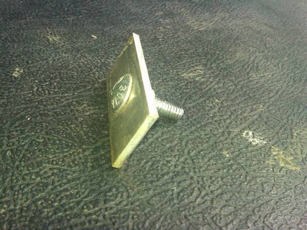

    Thought I would help people out here abit--
    found these--t-slot nuts 9/16-3/8-16 thread
    should work and $3 for a pack of four is a better deal then $3 for one--
    http://www.grizzly.com/products/T-Slot-Nuts-pk-of-4-9-16-Slot-3-8-16/G9513
    plus I bought hex head 3/4 inch length bolts on ebay --pack of 15 for $10 shipped
    http://www.ebay.com/itm/3-8-16x3-4-...ultDomain_0&hash=item2c620ee557#ht_500wt_1156

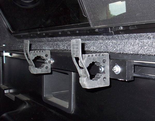

    This came with my-long gone-bakflip cover. simple and work great

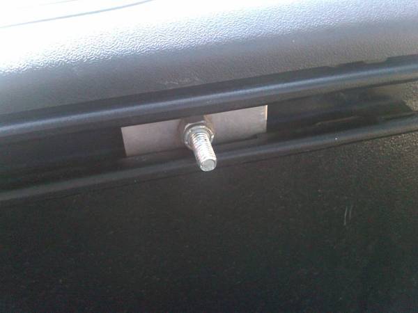

    This question may be seem silly, but whats the best way to secure the T-nuts in place on the rail? Does a threaded bolt/rod push against the inside track of the rail to push the T-nut against the flanges of the rail? Or does whatever is mounted on the outside of the rail pinch the rail flanges with the T-nut? What I want to do is mount a pair of bars across the bed to hold fishing rods.....I'm thinking T-nuts with drop down pieces, some kind bar stock for the bars, and fishing rod holders designed for the boat mounted to the bars.
  7. Feb 24, 2012 at 6:56 AM
    #107
    Goober
    Goober Earthlings are fun to watch!
    Dec 20, 2010
    #47990
    694
    Utah - Why just have only one?
    '11 TRD Off-Planet AccessCab
    Whatever is mounted on the outside of the rail pinches the rail flanges with the T-nut. I used a 1x2 as a spacer to mount a my shovel.[​IMG]
