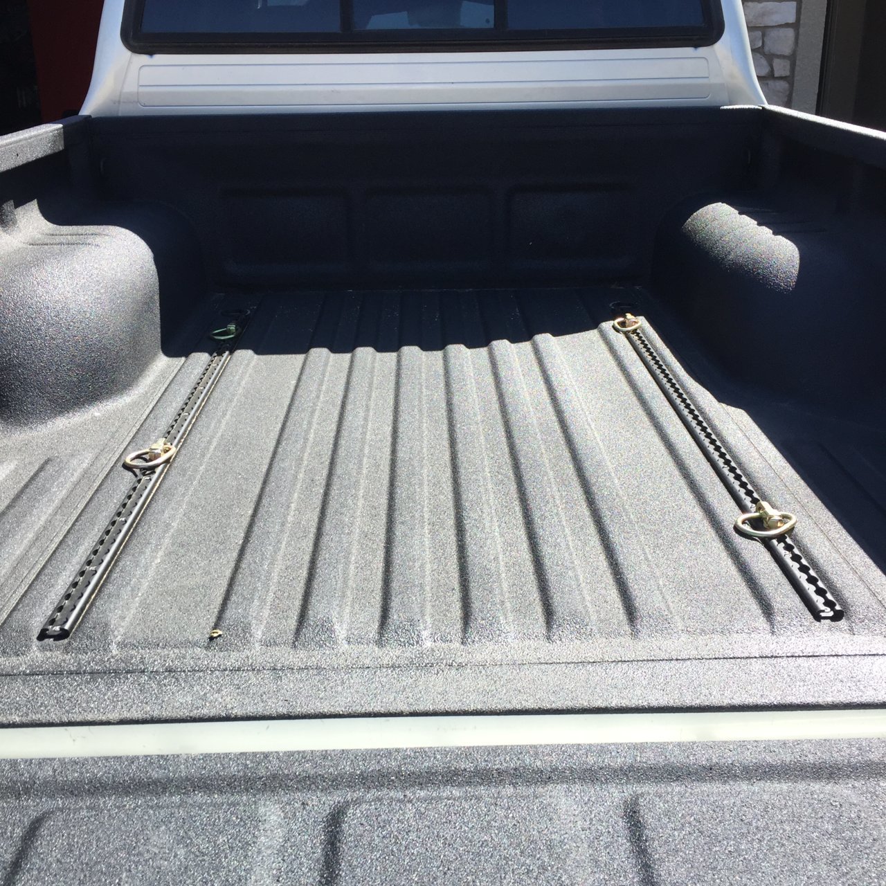

    Hey! I have been looking at this setup for a few years now and was about to buy on Amazon right now!. Moab trip is coming in October and time to pull the trigger. If I can ask you a few questions?
    How do you like having the rails toward the outside of the bed floor? And how did you fasten it? Did you do rivnuts?
    I was going to order 4 rails and use the bed rails. I have the plastic bed liner and haven't seen the metal there. Is it sufficient to use these there?
    I'm looking at securing bins and coolers to the floor for camping. I'll be four wheeling Moab with all my shit in the bed so it has to be secured. ANY advice you can provide would be sooooo helpful for me right now!

    I’m currently using it to hold my full size spare in my bed and it doesn’t budge at all. You can get the mounting hardware from the site I listed as well.
    I like the setup because sometimes you need to secure the items that are lower than your bed rail down to the bed and this works better than the side mounts. Since you can move the mounting position on the rails it gives you a more customize option on your secure points.

    You had no access issues with the hardware on the floor of the bed?
    I was also going to use rivnuts to secure strips to the tailgate and to the front bedrail...

    I had one tight spot by the fuel tank but the rest was pretty easy. I think the position makes a difference. I don’t remember how far I did mine from the bed end but you can see in the photo for reference.

    So you just bolted it down no rivnut? Asking because I'm planning on doing this also.

    Yeah, thank you so much for sharing your install tips. I’ve got 4 4’ strips of track ordered and on the way.
    I’ve pulled my plastic bed liner out a bit to see the rails and how they would fair with track installed there. They seem thin and bendy. I may get some steel strips and create a sandwich of sorts by drilling and mounting it as a backing plate.
    That or I may just use rivnuts and bolt L track to the top of the tailgate and back bed rail...

    Yea the uscargo site has the hardware to bolt it down too. They fit perfectly and are flush with the tracks base. The holes are tapered so I’m not sure how rivnuts would fit.
